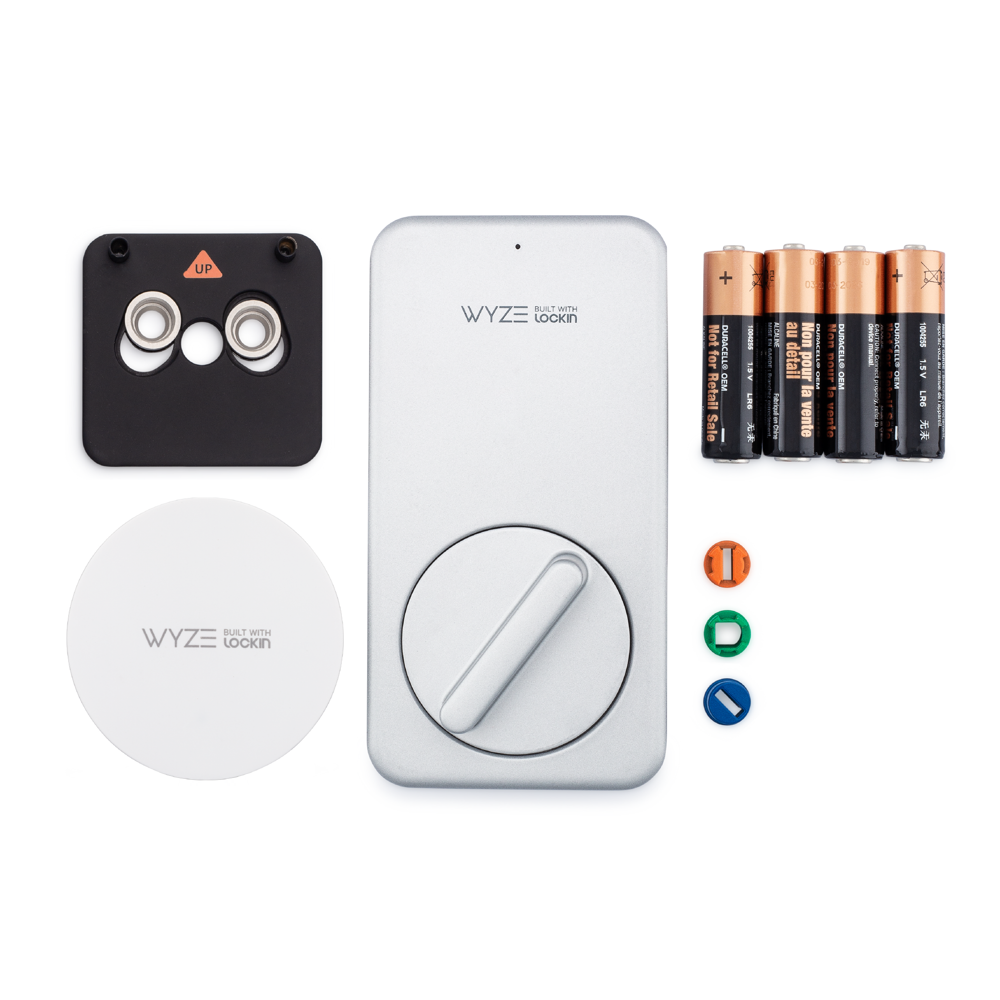

  • Wyze Lock x1
  • Wyze Lock Gateway x1
  • AA Batteries x4
  • Adhesive Strip x1
  • Mounting Plate x1
  • Adapter x3
  • Quick Start Guide x1

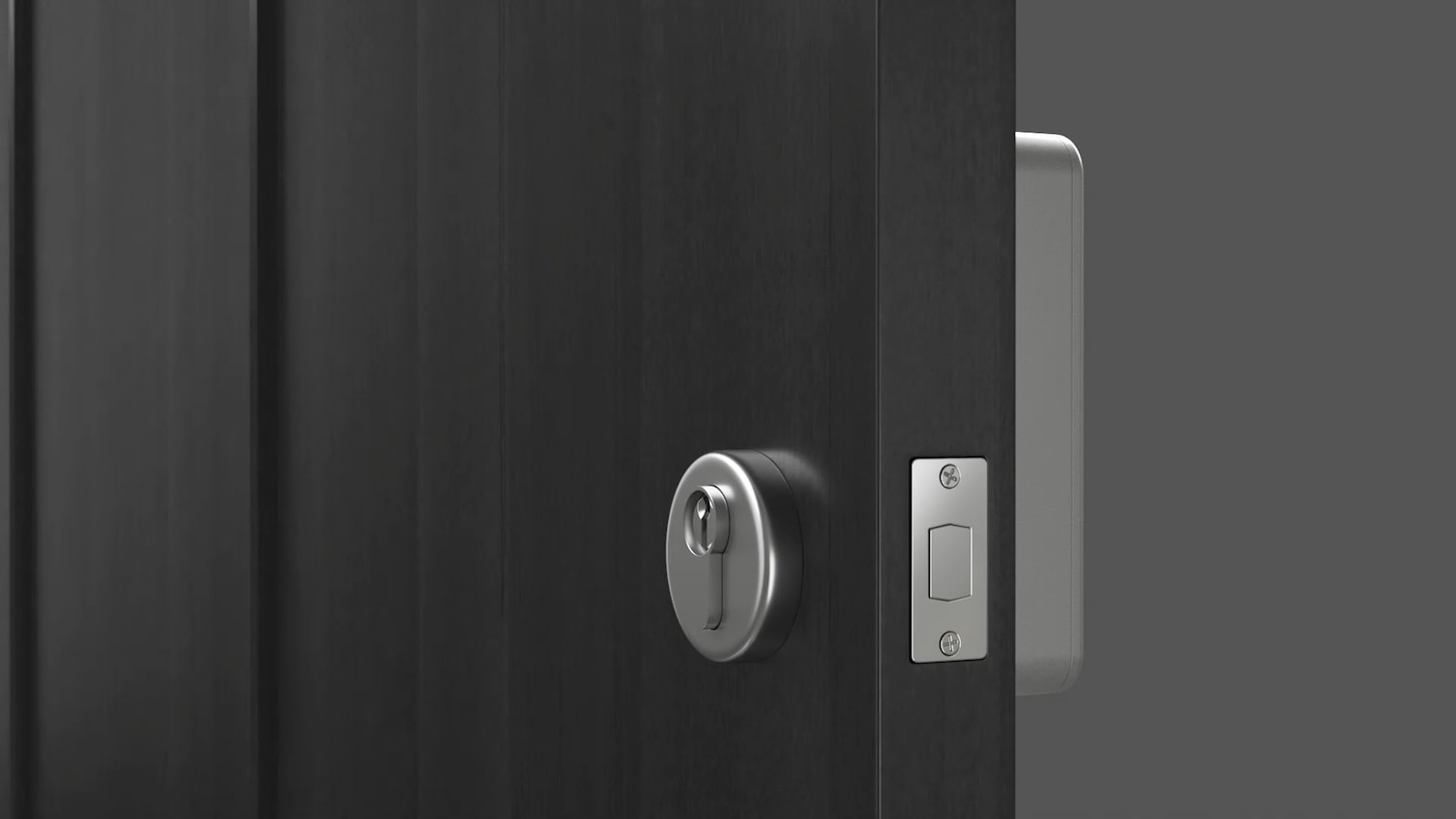

Same key. Same deadbolt. Infinitely smarter.
Wyze Lock uses your door's existing hardware so you can keep your key, but still get all the benefits of a smart lock.
Keep your key graphic.
A wooden door with a lock on it.

What’s in the box?
  • 1x Wyze Lock
  • 1x Mounting Plate
  • 4x Lock Adapters
  • 4x AA Batteries
  • 1x Adhesive Strip
