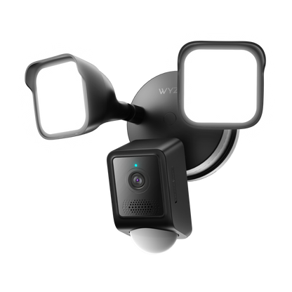

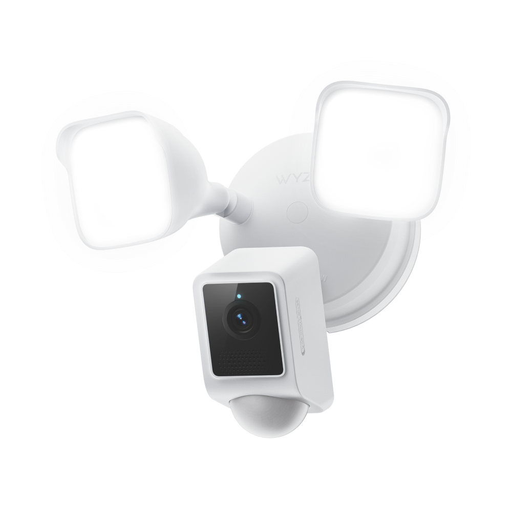

Wyze Cam Floodlight v2 is a 2K HD camera featuring a 160-degree super-wide angle view for extra coverage, upgraded floodlights with 2800 lumens of light, and Ambient Light Mode for additional exterior lighting. All that in a more rugged and robust build, with our new Access Point feature for ladder-free camera setup, and the Motion Warning feature that alerts intruders that they're being recorded.
The 160° wide-angle field of view eliminates nearly all blind spots, ensuring comprehensive surveillance for your peace of mind.
Access Point setup lets you use a Wi-Fi hotspot to connect to your mobile device during setup. This saves you the hassle of climbing up a ladder to scan the QR code.

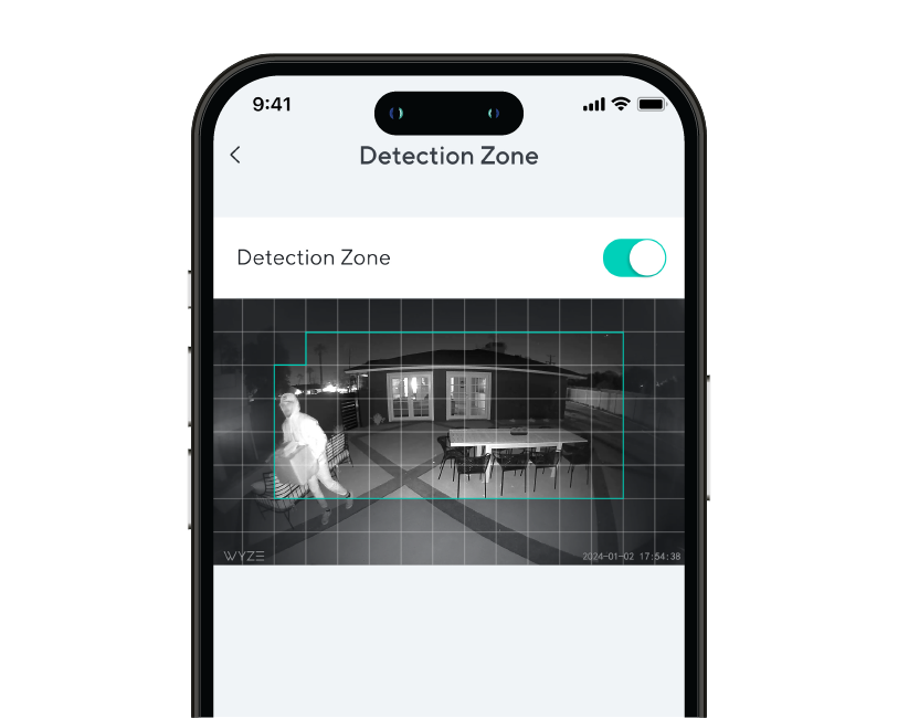

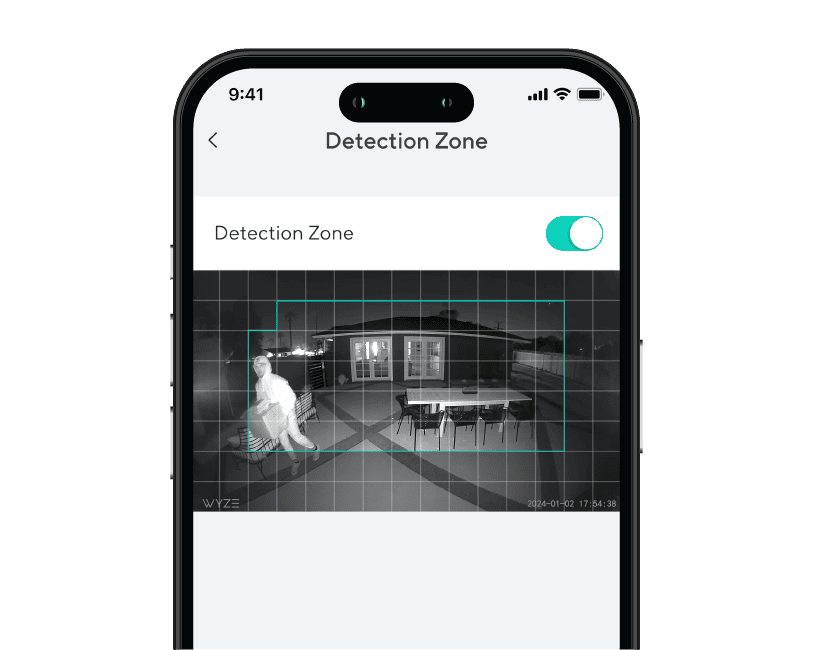

The floodlight can detect motion up to 30 feet away, with a customizable Detection Zone.

Yes, from the app you are able to customize when your camera activates based on motion in your watched area.

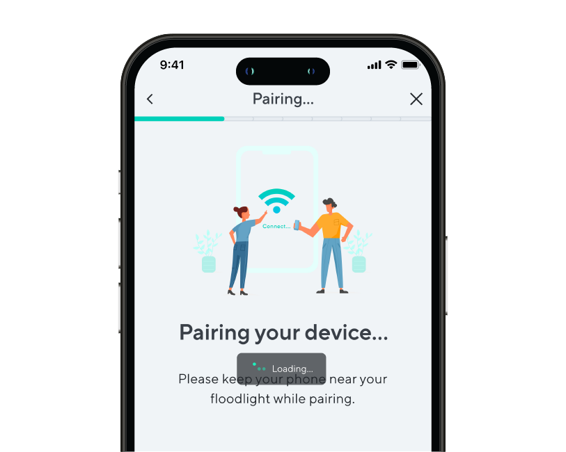

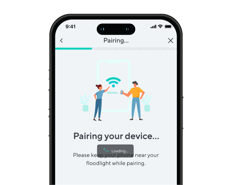

To set up your Wyze Cam Floodlight v2:
  1. After completing the installation process in the Wyze app, tap Begin Setup. Floodlight not installed, with power? Follow the steps listed in our Wyze Cam Floodlight v2 Installation Guide before beginning setup.
  2. The status light should begin flashing red. If the light is flashing red, check the box next to Light is flashing red, then tap Next. If the light does not turn on, press and hold the SETUP button on the side of the camera to reboot the camera.
  3. Wait for the voice prompt to say "ready to connect." After the prompt, check the box next to It said, "Ready to connect", then tap Next. If there is no voice prompt, press and hold the SETUP button for 10 seconds to reboot the camera, then try again.
  4. Give location permissions for the floodlight's Dusk to Dawn setting. Tap Next.
  5. Your floodlight will pair to the Wyze app - stay nearby.
  6. Select your 2.4 GHz Wi-Fi network and enter your network password. Tap Next. Tap the icon in the password field to display the password to ensure it was entered correctly.
  7. Your floodlight will connect to your Wi-Fi network. If connection fails, wait for the voice prompt and try again.
  8. Name your Wyze Cam Floodlight v2 using the text field, or by choosing a suggestion. Tap Finish when done.
  9. You may have a prompt for a free trial of Cam Plus. Tap Continue.
  10. Set up some automations on the Things to Try* page, or tap Skip.
  11. You are all set! Your floodlight is set up and ready to go. Tap Done.

  7. Check that BluetoothⓇ is enabled for the Wyze app in your phone/tablet settings. Toggle BluetoothⓇ off/on.
  8. Verify that Location Permissions are enabled for the Wyze app in your phone/tablet settings. Make sure that it is set to Always or While Using the App.For iOS users, make sure that Precise Location is turned on.
  9. If possible, temporarily disable any VPNs on your mobile device or Wi-Fi router.
  10. Ensure that you are following the setup process outlined in the Wyze app. After tapping Begin Setup, make sure that you hear the “ready to connect” voice prompt and check the box for It said, “Ready to connect”. Tap Next to see a Connecting to device pop-up, then tap Connect.If pairing fails, you will see a “Pairing Failed” screen. Tap Pair Device Wi-Fi Manually, then tap Choose Wi-Fi.You will be taken to your mobile device’s Wi-Fi settings. Tap floodlight_ap to connect to the floodlight’s network, then navigate back to the Wyze app.In the Wyze app on the Select your network step, select and enter the password for your Wi-Fi network. Tap Next to continue with setup.
  11. Ensure your phone/tablet is connected to the same 2.4 GHz network that you’re entering at the Select your network step and that you’re entering the SSID (Wi-Fi name) correctly. Wyze Cam Floodlight v2 is not compatible with 5 GHz Wi-Fi networks.The SSID is case-sensitive and there should be no space before or after the SSID.The SSID should automatically populate if you’re connected to Wi-Fi. If it does not auto-populate, it can indicate the phone/tablet that is being used for setup is not connected to Wi-Fi.
  12. Check that you’re entering the Wi-Fi password correctly. Tap on the eye icon to view the password you’re entering.
  13. Power cycle Wyze Cam Floodlight v2. Switch the breaker to the off position.Wait 5-10 seconds.Switch the breaker back to the on position.
  14. Factory reset Wyze Cam Floodlight v2. Remove any microSD card inserted into the floodlight.With the floodlight powered on, press and hold the setup button on the side of the camera for 10 seconds until the status light on the front of the camera turns solid red.Once the status light starts flashing red, set up the floodlight like new.
