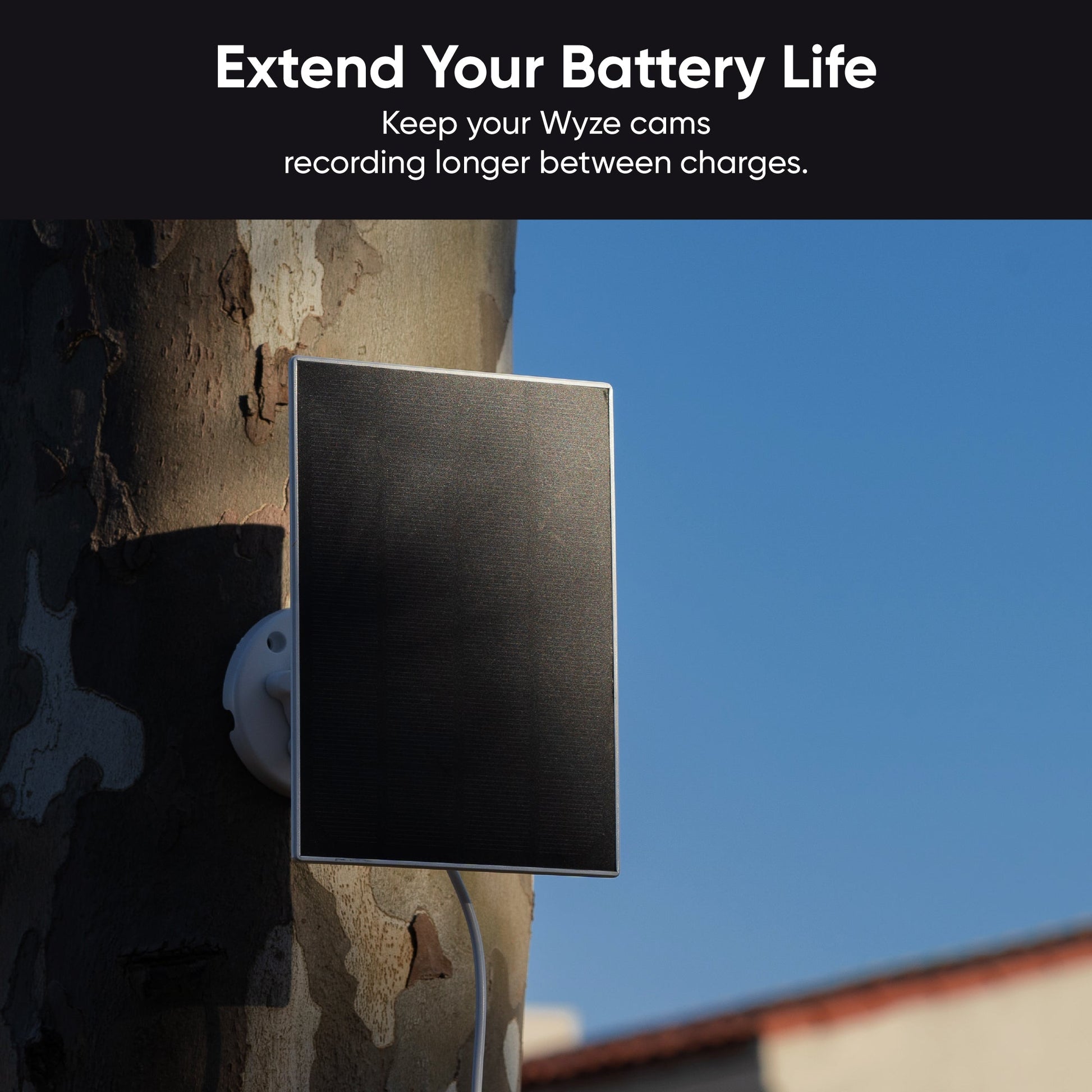

The solar panel converts sunlight into electrical energy to charge Wyze Cam Outdoor or Wyze Battery Cam Pro.
The maximum power output is 2.5 watts.
Mount the solar panel where you get the most sunlight during the day. Make sure it’s not in a shaded area and avoid placing it directly under a tree. Tree sap, falling leaves, and large shadows can greatly reduce the solar panel’s efficiency.
For the most sunlight, position your Wyze Solar Panel so that it’s facing south and is tilted upward at a 30º angle.
No, we do not recommend using Wyze Solar Panel with other Wyze cameras. This is only compatible with Wyze Cam Outdoor and Wyze Battery Cam Pro.
Wyze Solar Panel is an accessory for Wyze Cam Outdoor and Wyze Battery Cam Pro to extend its battery life. We do not recommend using it to charge other devices.
Depending on the intensity of the sunlight, the solar panel is unlikely to perform well in cloudy or rainy weather.

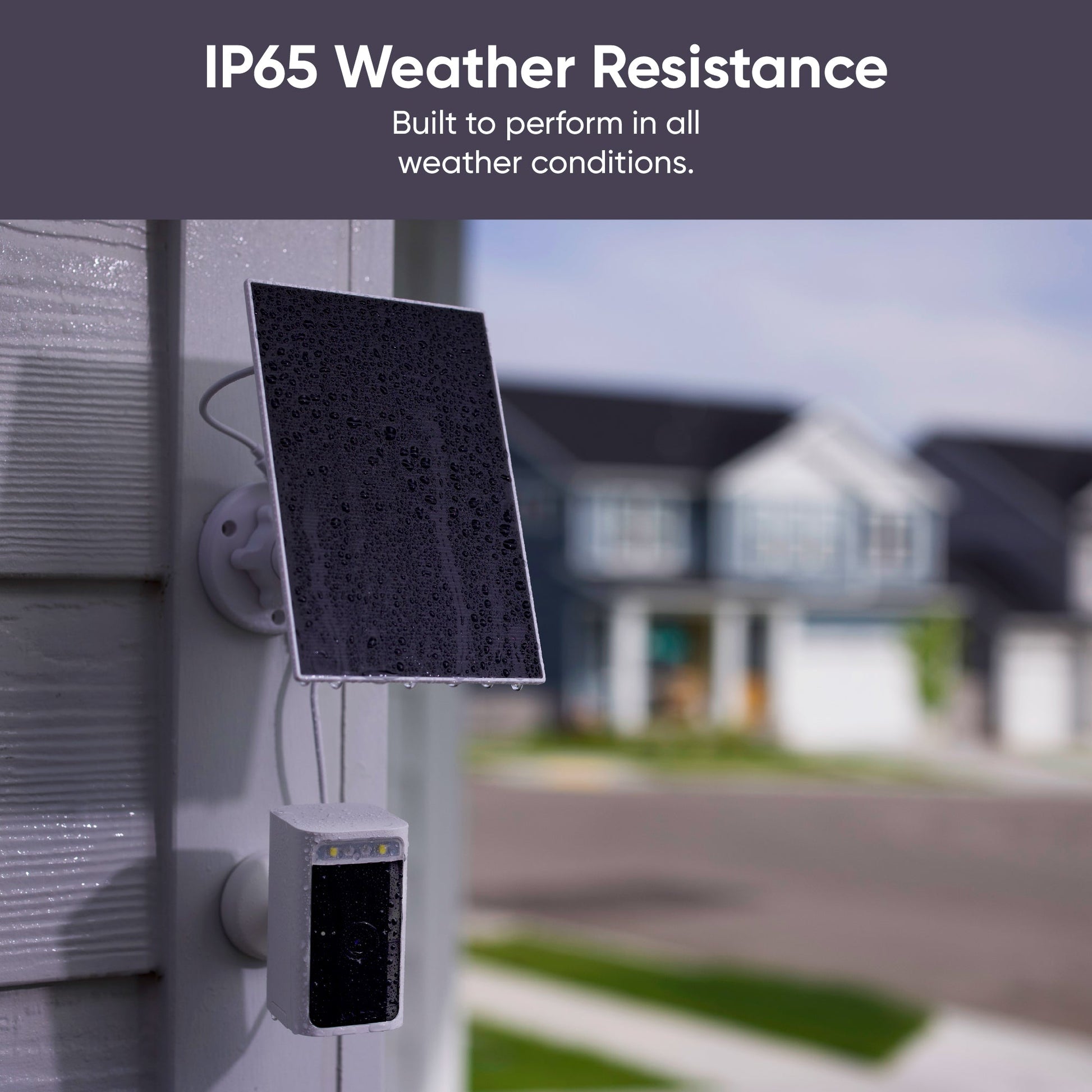

Yes, Wyze Solar Panel is IP65 weather resistant and dustproof but is not waterproof.

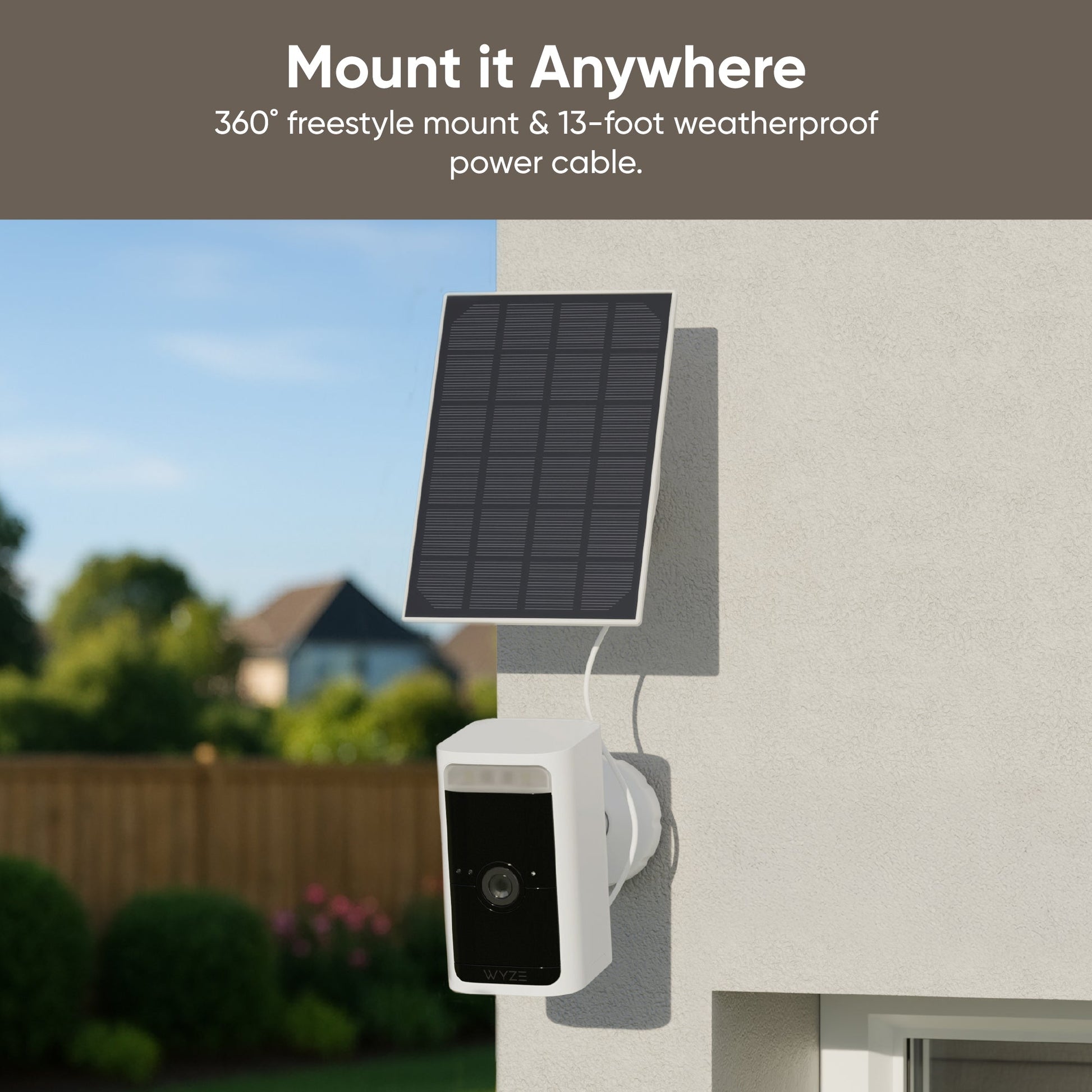

A solar panel is attached to a house.
360° Freestyle Mount
Get the perfect angle to achieve maximum sun exposure IP65 Weather Resistance - Weatherproof and dustproof.
A person is holding a white device that is plugged into a wall outlet.
Long Range Power Cable
A 13-foot weatherproof power cable provides ultimate mounting flexibility.
