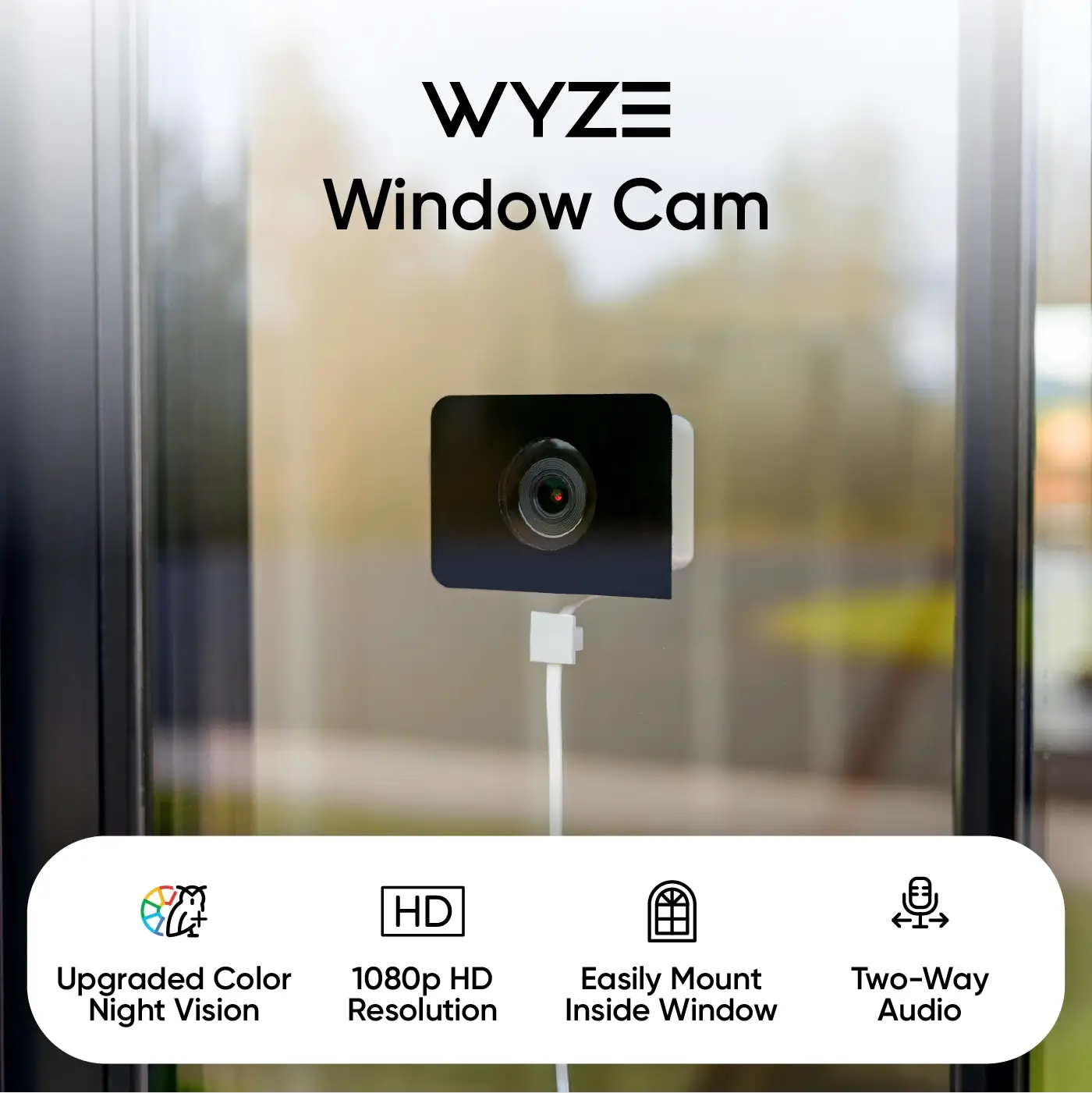

Wyze Window Cam
Wyze Window Cam
Outdoor monitoring with no glare.

    2K CNV logo
    2K Color Night Vision
    1080p HD logo
    1080p HD
    Capture it all in HD
    Two Way Audio device.
    2 Way Audio
    Easily Mount
    Inside Window

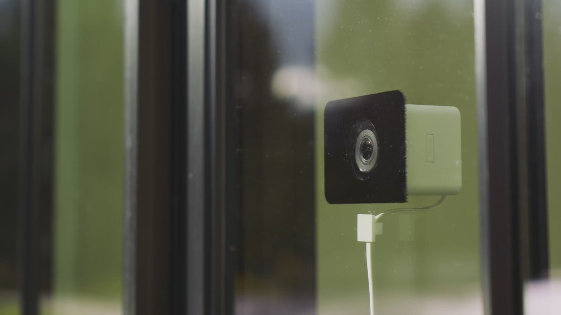

    Watch outside. Mount inside. Wyze Window Cam attaches to the inside of your window with an included mounting sticker, giving you an outdoor view without drilling or running power cables outside. Use it to watch your driveway, yard, or entryway visible through your window; all from the Wyze app.
    Your window’s location determines what the camera can see. Choose clean glass with no screen blocking the view, plug the camera into indoor power, and connect to Wi-Fi. Before applying the sticker, preview the live view to make sure your intended area is in the frame.

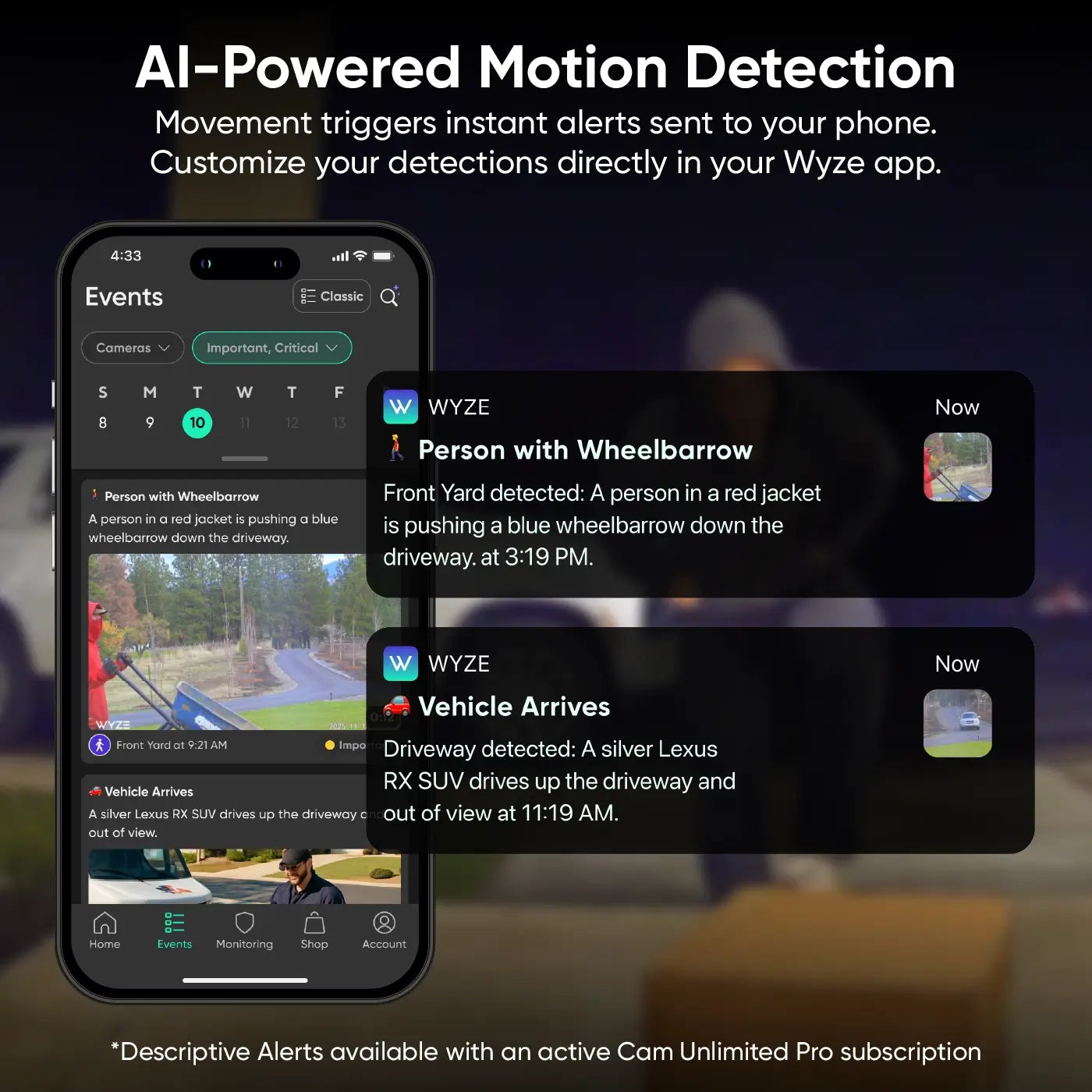

      AI-Powered Motion Detection

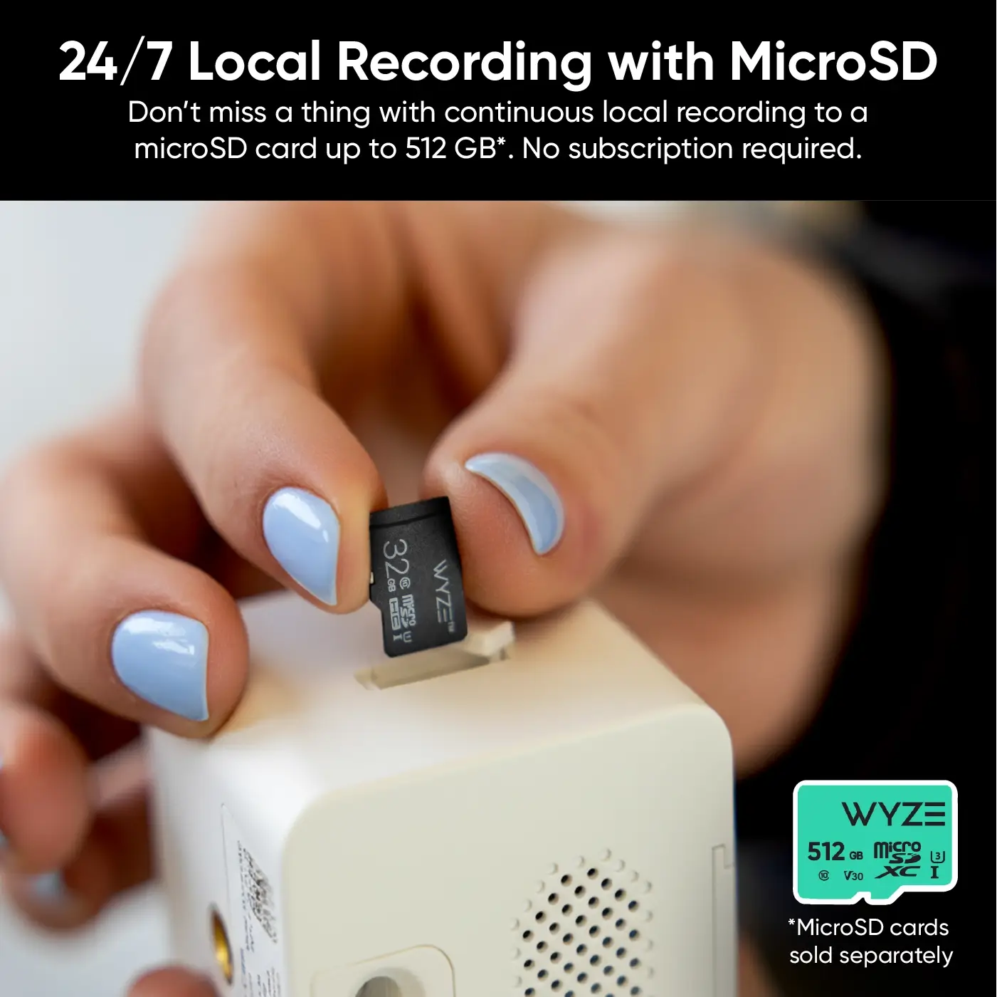

      Local Recording to MicroSD Card

    • Local Storage: Supports up to 512 GB microSD in exFAT format

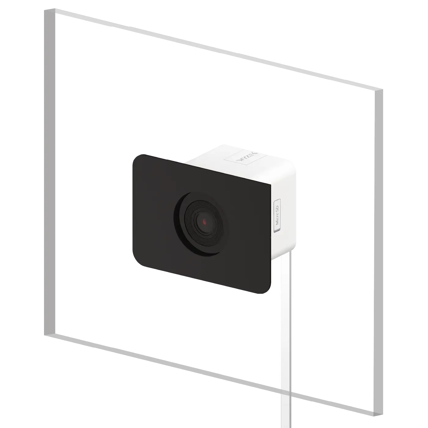

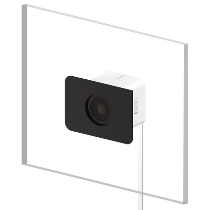

    Wyze Window Cam is built specifically to be used behind window glass. Unlike our other Wyze Cams, we removed the IR lights and the spotlight entirely to reduce glare and reflections that cause poor image quality at night. We made installation as simple as peeling, sticking, and pressing it onto a clean window. Last, we included an extra-long micro USB cable and cable clips for neat and tidy mounting.
    To remove the adhesive from a window, start by applying heat from a hair dryer to soften the adhesive, then use a plastic scraper or a card to gently pry it away. For stubborn residue, a solvent like isopropyl alcohol can dissolve the sticky material. Finish by wiping the area with a clean cloth and washing with soap and water.

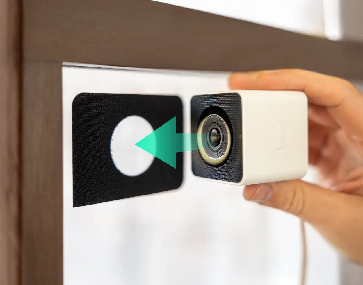

    No, the mounting sticker is for single-use only, and cannot be moved and reused after mounting. However, Wyze Window Cam comes with two mounting stickers in case you want to mount it somewhere else.
    Always thoroughly wipe clean and dry the area on your window before axing the sticker. Or replace with the spare window sticker that comes in the box.
    We do not recommend placing the camera behind a screened window as it will negatively impact video quality.

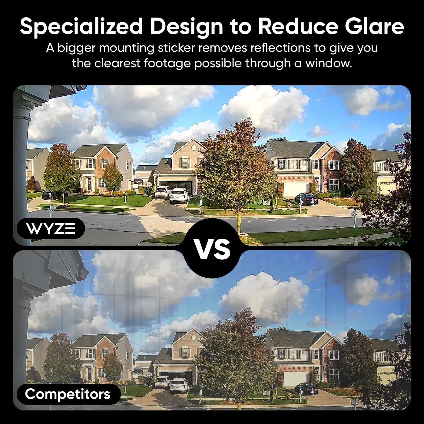

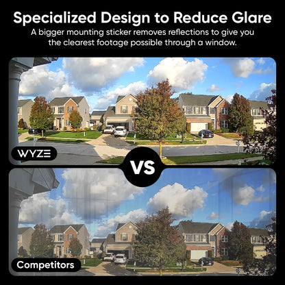

    The bigger sticker is to minimize glare caused by indoor lighting behind Wyze Window Cam. Please make sure you mount the sticker horizontally for best results. Do not trim the sticker.

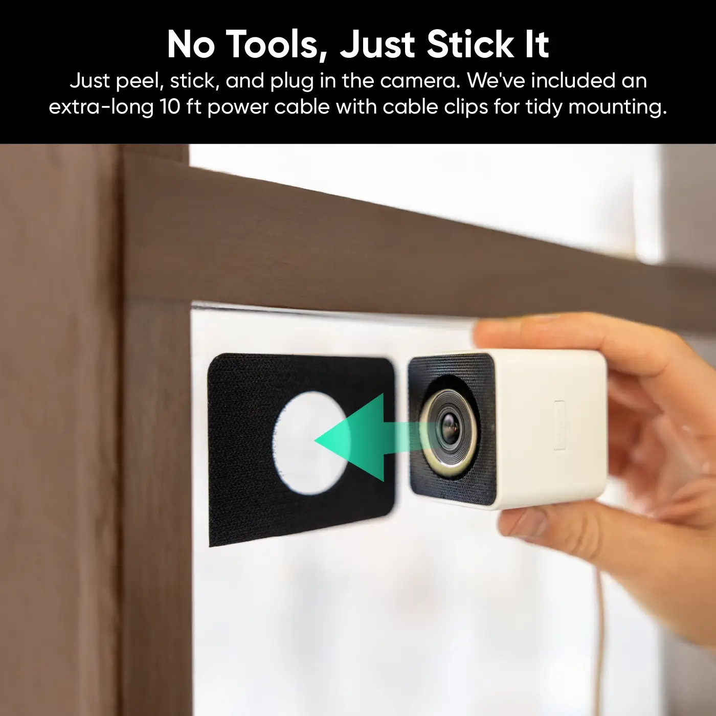

    No Tools. Just Stick.
    No drilling. No permanent hardware. The secure hook-and-loop fastener mounting sticker makes installation simple.

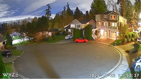

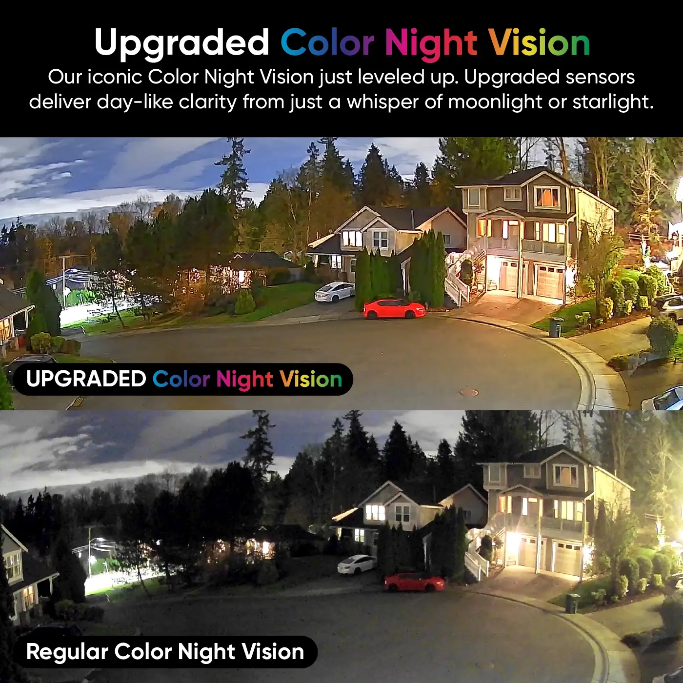

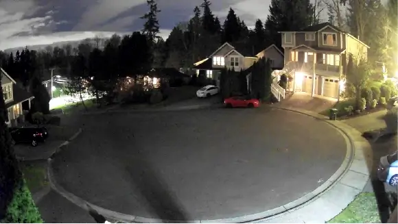

    Upgraded Color Night Vision
    See in full color. even in near-darkness.

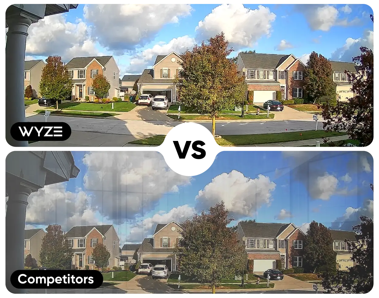

    Anti-Glare Design.
    Glare beware. Engineered to eliminate glare and reflections for crisp & clear window footage.

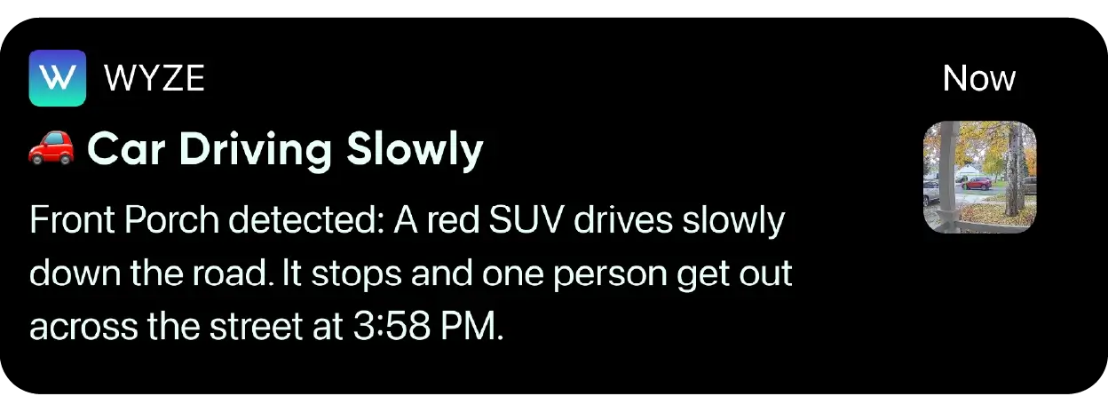

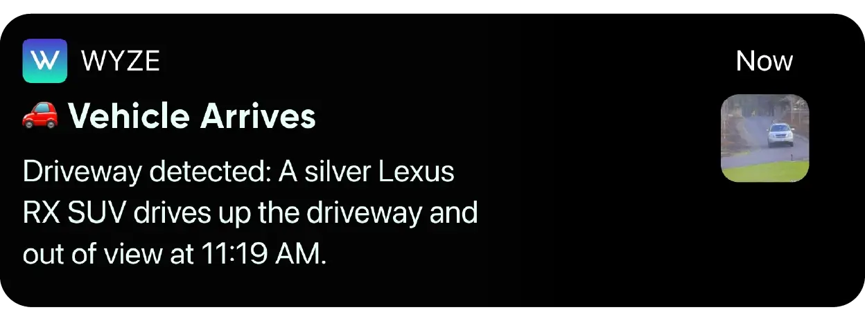

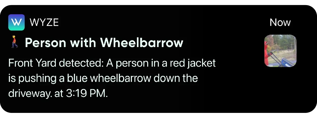

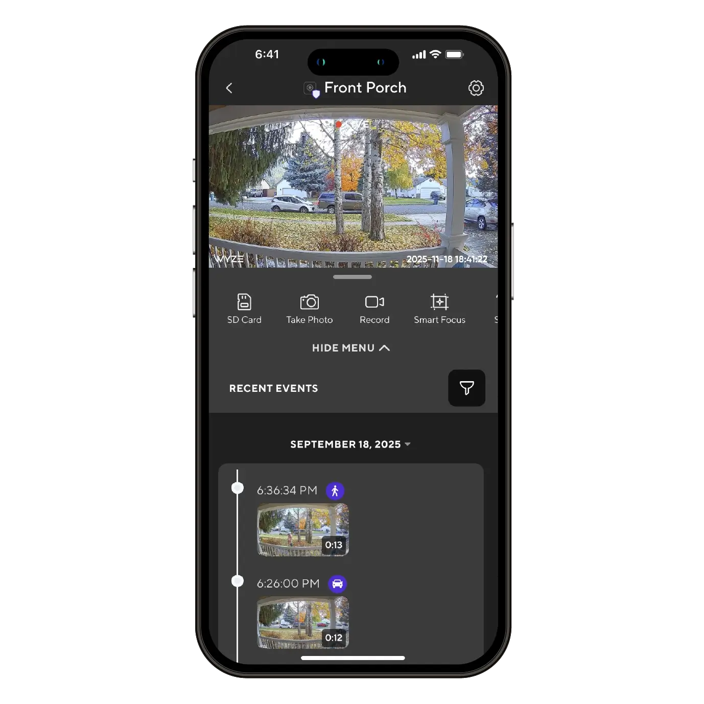

    AI-powered detection & alerts.
    Window cam knows what matters

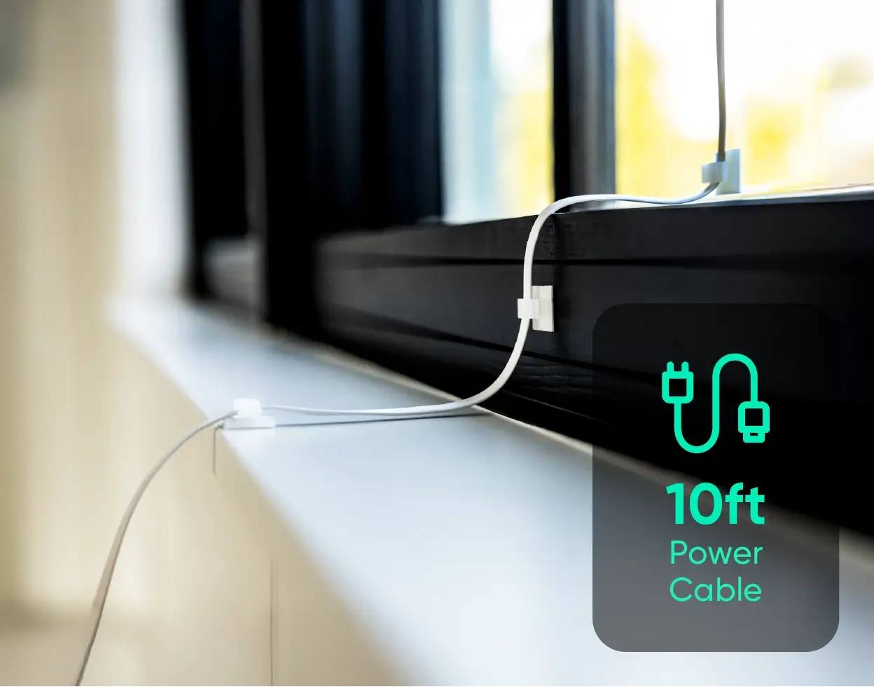

    A white power cable plugged into a window.
    Extended Power Cable
    We've included an extra-long 10 ft power cable with cable clips for tidy mounting.

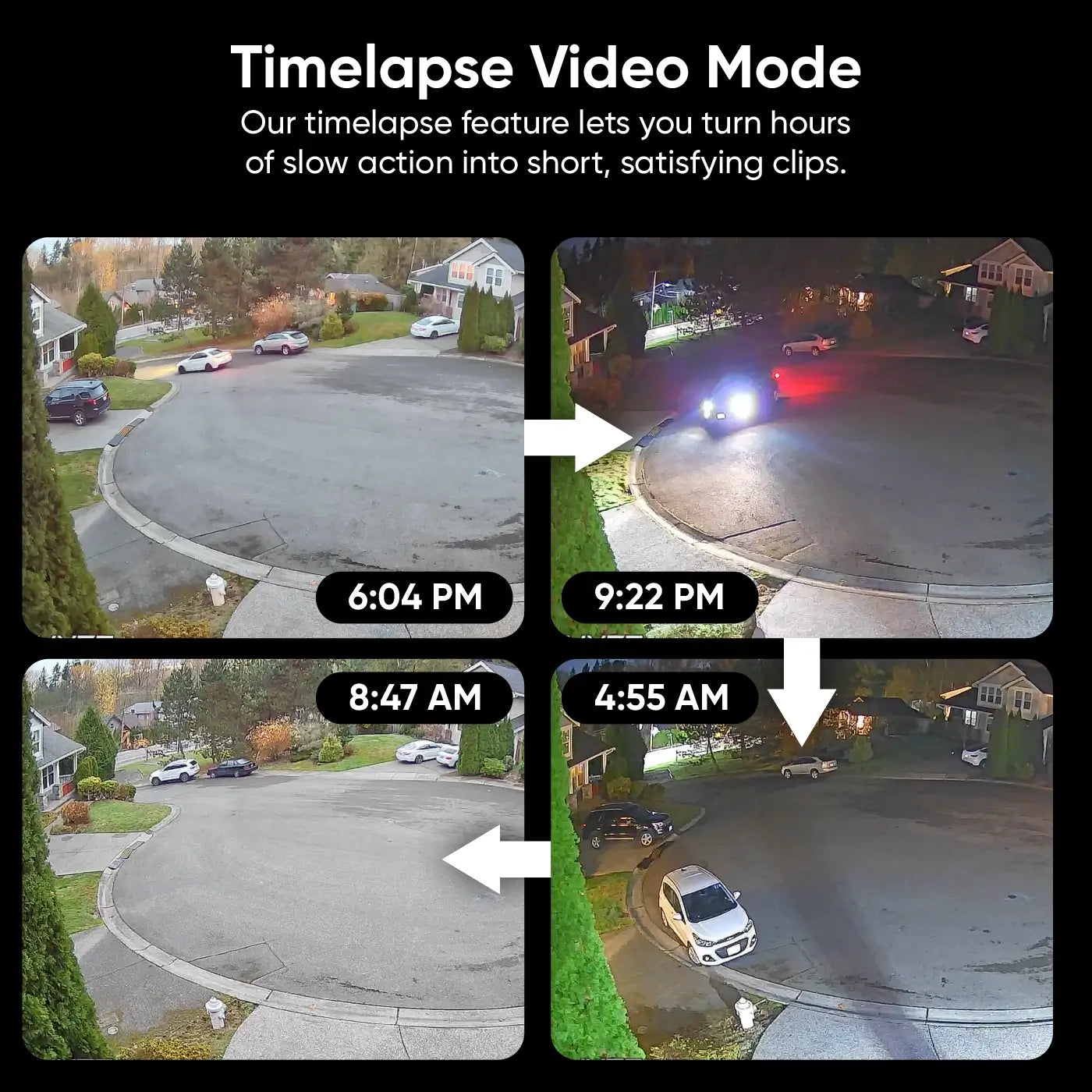

    Timelapse video.
    Create stunning time-lapse videos of a sunset or track project progress.

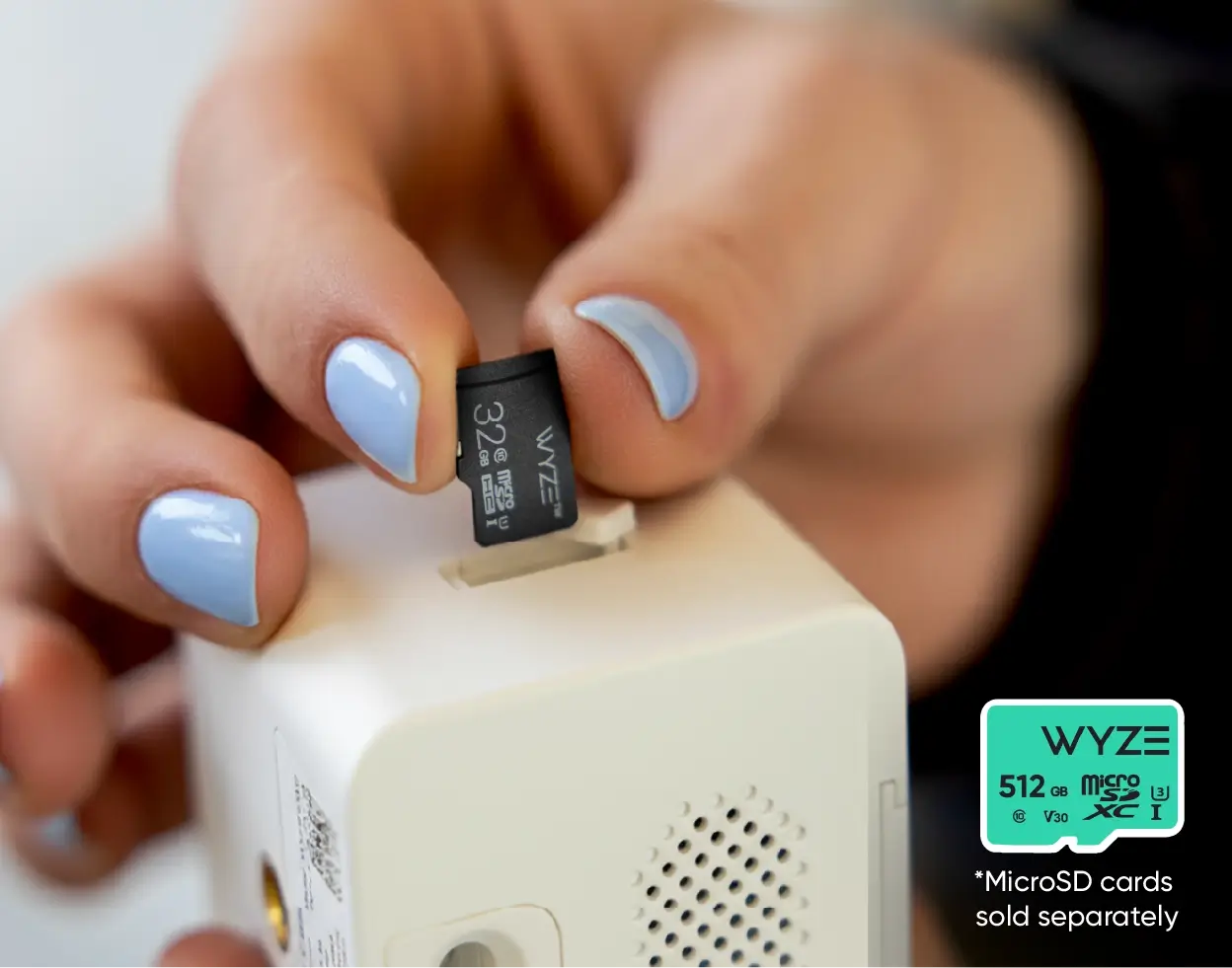

    24/7 Recording with Wyze MicroSD card
    Store days, weeks, or months of footage locally.*
    *microSD card required (sold separately)

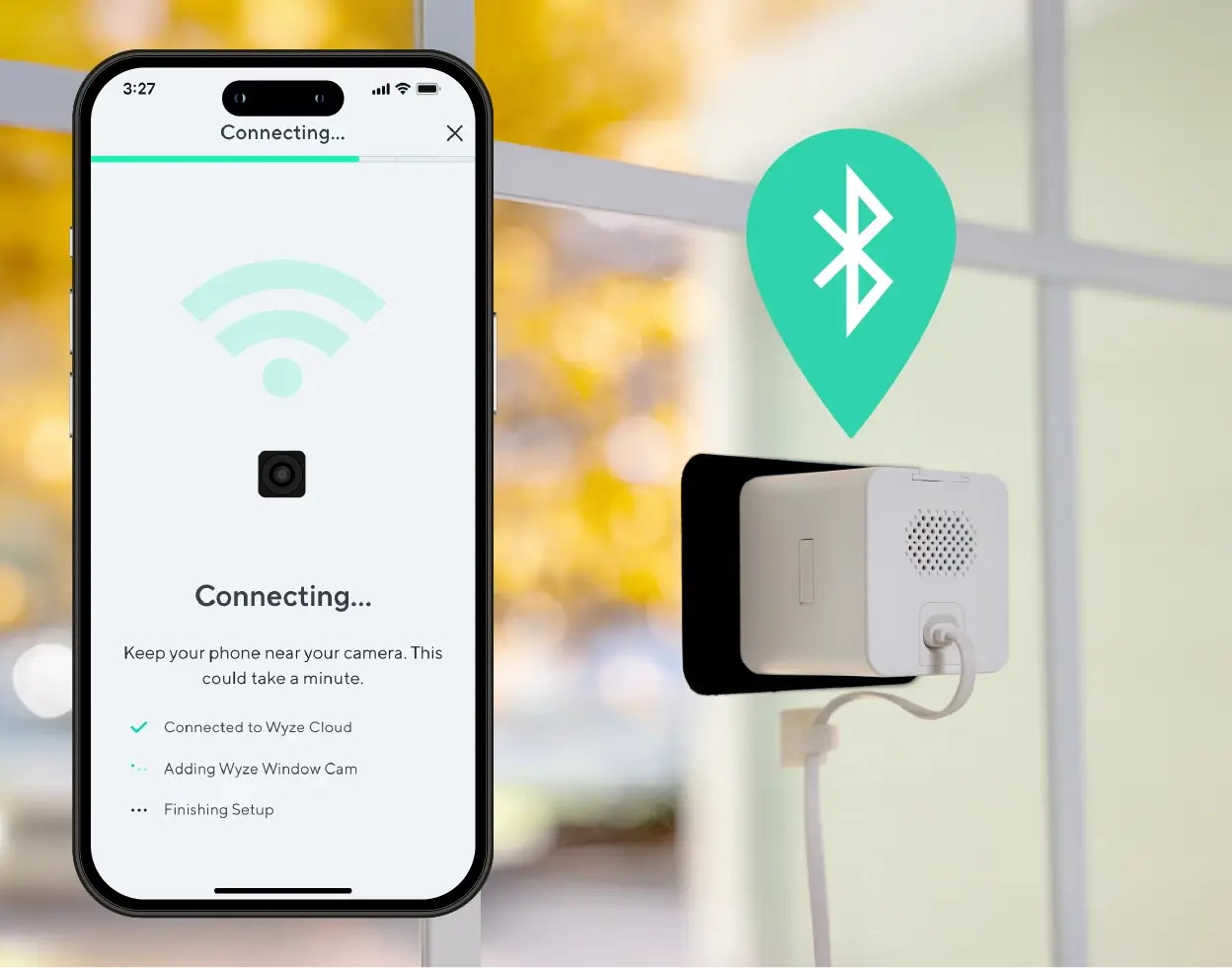

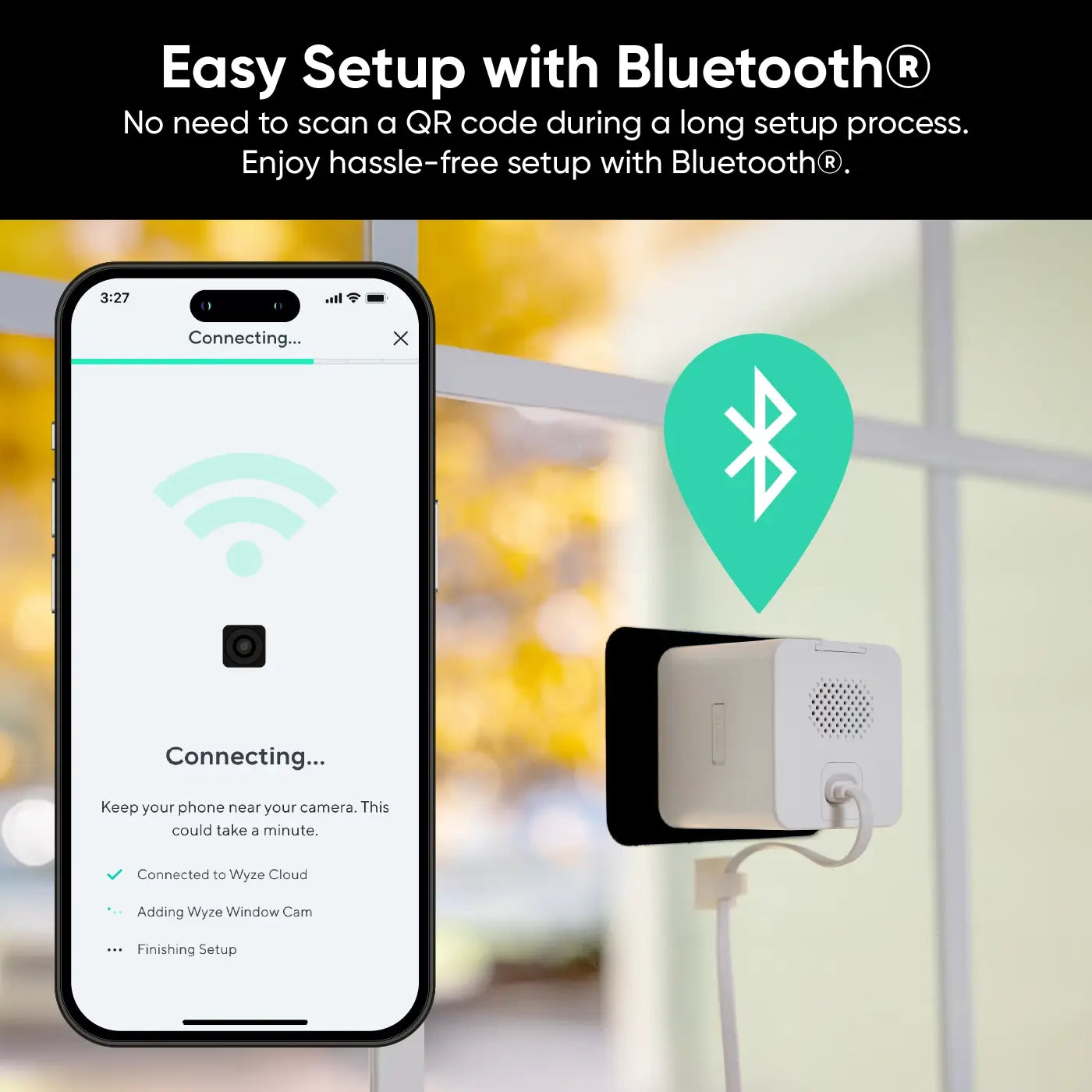

    Easy Bluetooth Setup & WiFi 6
    Easy Bluetooth pairing and Wifi 6 performance means faster pairing, stronger connection, and rock-solid streaming —even on busy networks.
    Setup takes seconds.

    To set up your Wyze Window Cam:
    3. Tap Cameras > Wired Camera > Wyze Window Cam.
    5. If Behind the camera lens, single-press the SETUP button. It will say “ready to connect”.The camera may say “ready to connect” without pressing the SETUP button. If so, continue with setup.
    6. In the app, check the box next to I heard, “Ready to connect”.
    7. Tap Begin Setup.
    8. If BluetoothⓇ hasn’t already been enabled, you’ll be prompted to allow BluetoothⓇ access. Tap OK.If BluetoothⓇ has already been enabled, it will skip to the next step.
    9. Select your 2.4 GHz Wi-Fi network and enter your network password. Tap Connect.Tap the icon in the password field to display the password to ensure it was entered correctly.
    10. After the camera is set up and connected, it will say "Wi-Fi connected, setup complete”.
    11. Tap Complete. Your camera is set up, now it’s time to mount your device.Follow along in the Wyze app to install the mounting sticker and mount your camera. Then then continue below.

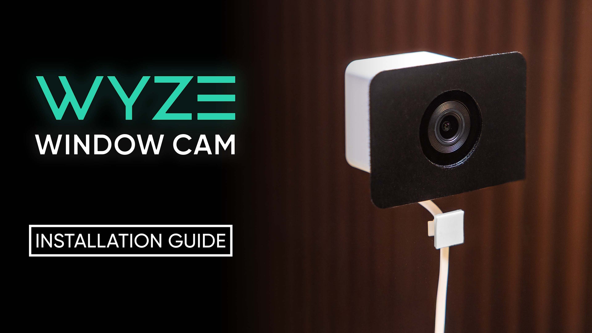

    To mount your Wyze Window Cam:
    1. After pairing your Wyze Window Cam in the Wyze app, the Installation page will show.
    2. Verify that you have everything needed for installation. Tap Next.
    3. Go to your mounting location. Thoroughly clean and dry the inside of the window where you plan to mount your camera. Tap Next.
      Install on window glass only. Do not mount on a window behind a screen.
    4. Peel off the film from the mounting sticker. Tap Next.Do not trim the mounting sticker.
    5. Affix the mounting sticker onto the window. Tap Next.
      Stick the mounting sticker horizontally, to minimize glare and for the best image quality.
    6. Remove the protective plastic from the lens, then press the camera onto the mounting sticker. Tap Next.
    7. Route the power cable along the windowsill and/or wall with the included cable clips. Tap Next.
    8. Follow the in-app instructions to complete the setup process.
    9. Enjoy your new Wyze Window Cam!
