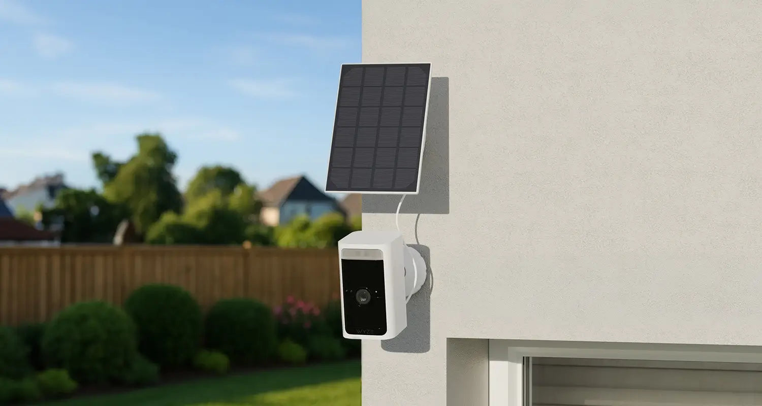

A solar panel is attached to a house.
360° Freestyle Mount
Get the perfect angle to achieve maximum sun exposure IP65 Weather Resistance - Weatherproof and dustproof.

  10. Need to adjust the angle of your solar panel? Simple! You can adjust your solar panel up to 90° at the elbow at any time or side to side by loosening the locking screw cap. Make sure the screws are securely tightened again after adjusting the solar panel.
Mounting Tips:
  • Find an area that gets the most direct sunlight throughout the day.
  • Angle the solar panel upward 30°.
  • Point it south if you’re in the northern hemisphere and north if you’re in the southern hemisphere.
