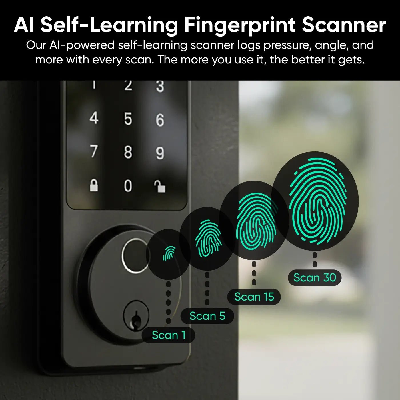

  • AI-Powered Fingerprint Unlock

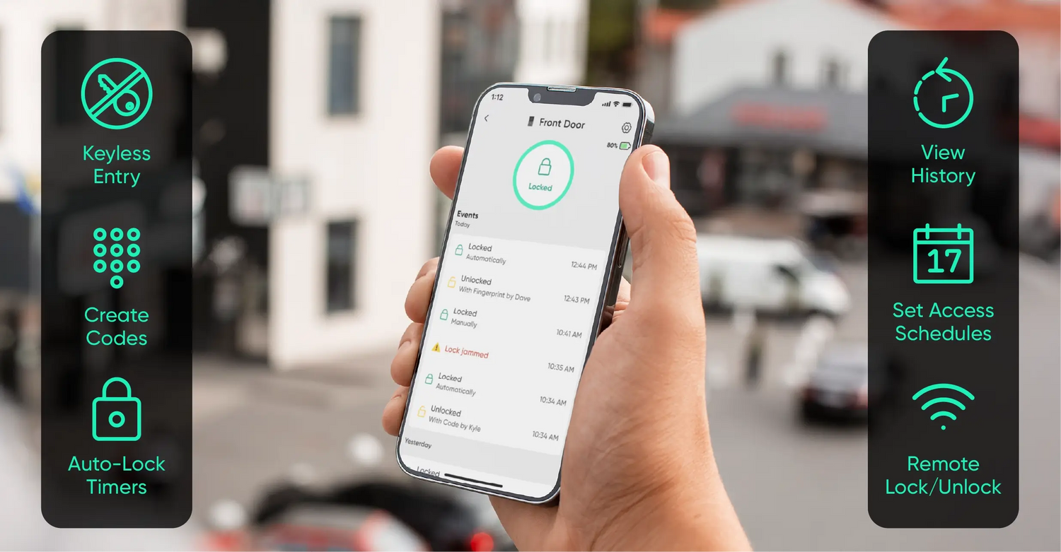

  • Wi-Fi Control & Unlock History in App

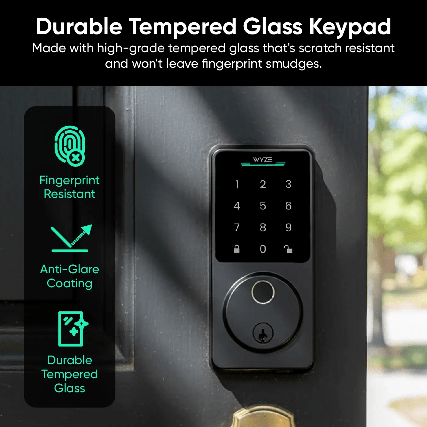

  • Tempered Glass Keypad with Anti-Peep Codes

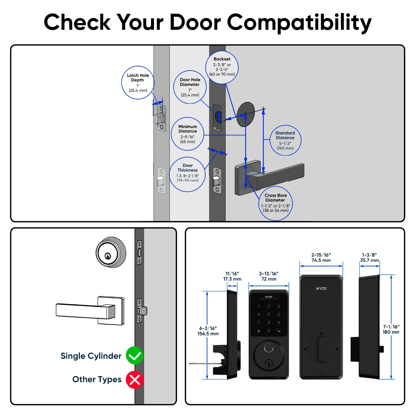

Dimensions

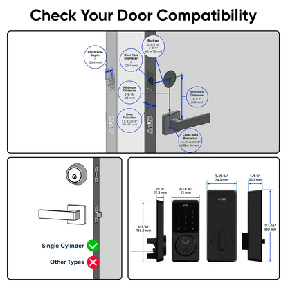

  • External Assembly: 6.2 in x 2.8 in x 0.7 in (156.5 mm x 72 mm x 17.3 mm)
  • Internal Assembly: 7.1 in x 2.9 in x 1.4 in (180 mm x 74.5 mm x 35.7 mm)

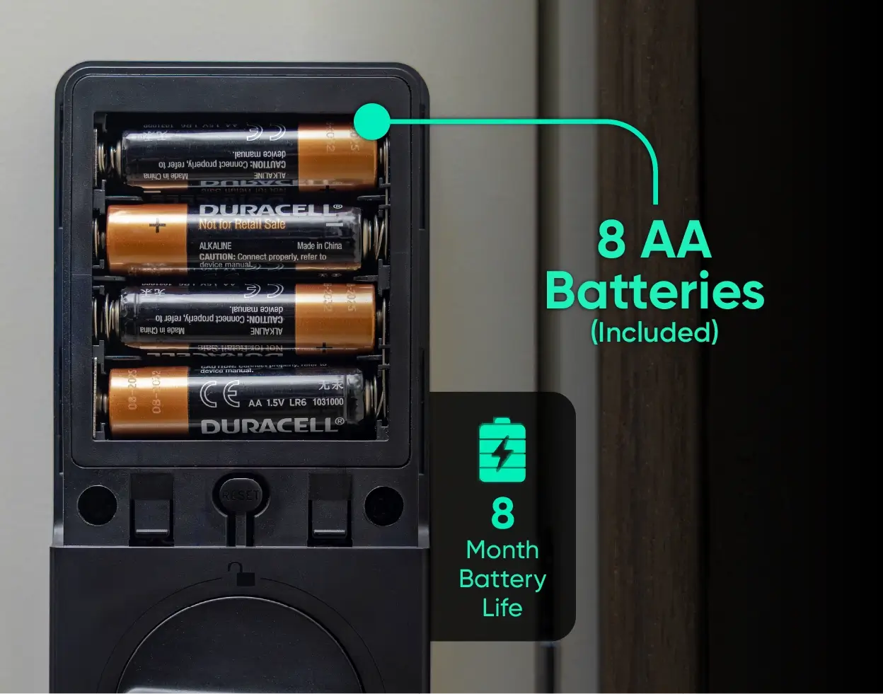

Power
  • Power Source: 8 x AA batteries (included)
  • Battery Life: Up to 8 months with normal use (10-20 lock/unlock per day)
  • Emergency Power: USB-C port (USB-C cable not included)

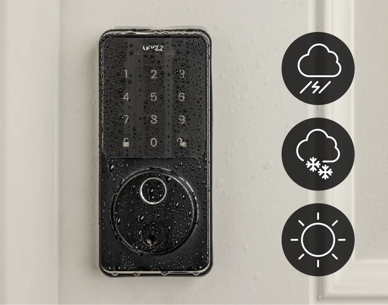

  • Weather Resistance: IP53
Operating Temperature
  • Outdoor Keypad: -4°F - 122°F (-20°C - 50°C)
  • Indoor Assembly: 32°F - 122°F (0°C - 50°C)
Storage Temperature
  • Outdoor Keypad: -22°F - 158°F (-30°C - 70°C)
  • Indoor Assembly: -22°F - 158°F (-30°C - 70°C)

Door Compatibility
  • Compatible with most standard US doors. Replaces existing single-cylinder deadbolt.
  • See which doors are compatible with Lock Bolt v2 here.

With AI self-learning fingerprint technology and a fingerprint-proof glass touchpad, Wyze Lock Bolt v2’s fingerprint reader is faster and more reliable than the original Wyze Lock Bolt. Wyze Lock Bolt v2 also has Wi-Fi built-in, which provides remote access and notifications from anywhere anytime. Our newest lock works with nearly all of our Wyze Video Doorbells to easily lock and unlock your door from the Live stream with a tap. And with mechanical key support, you’ll now have 5 ways to lock and unlock your door.
Traditional fingerprint locks are "one-and-done”—once registered, they can’t adapt to new data. Changes in the weather, scanning speed, seasonal changes, cold fingertips, or other variances can often cause delays when unlocking. Our AI self-learning fingerprint tech acts like your personal butler: it logs the pressure, angle, and even tiny skin shifts with every unlock, dynamically refining its model. The more you use Wyze Lock Bolt v2, the faster and sharper it gets. It also captures microscopic details like pores, creases, and scars on your fingerprint, building your unique "biometric vault."
No, installing your Wyze Lock Bolt v2 is the same as any other smart lock, with a standard deadbolt and latch assembly.
Door type: Standard single-cylinder deadbolt on wooden exterior doors. Not for glass or sliding doors. Does not support Mortise or multi-point locks.
Door thickness: 1-3/8" to 2-11/64" (35–55 mm).
Cross-bore (main hole) diameter: 2-1/8" (54 mm) or 1-1/2" (38 mm).
Edge/latch hole (face-bore) diameter: 1" (25 mm); latch-hole depth must be 1".
Backset: 2-3/8" (60 mm) or 2-3/4" (70 mm) (deadbolt is adjustable).
Clearance from other hardware: At least 2-9/16" (65mm) between the deadbolt center and the adjacent handle/doorknob.
Latch plate shape: Rectangular faceplate.

Wyze Lock Bolt v2 comes with eight AA batteries in the box. These batteries keep the connection to Wi-Fi rock-solid and give you the full feature set you love from your lock—no compromises.
Use brand new 1.5 V AA batteries, not rechargeable versions, when replacing the batteries. Start by removing the four batteries from the outer layer. Then gently pull the ribbon to lift the remaining 4 batteries out of the compartment. Next, carefully insert the inner layer of new batteries over the ribbon, then finish with the outer layer. For the best battery life and performance, don’t mix battery types or old and new batteries.

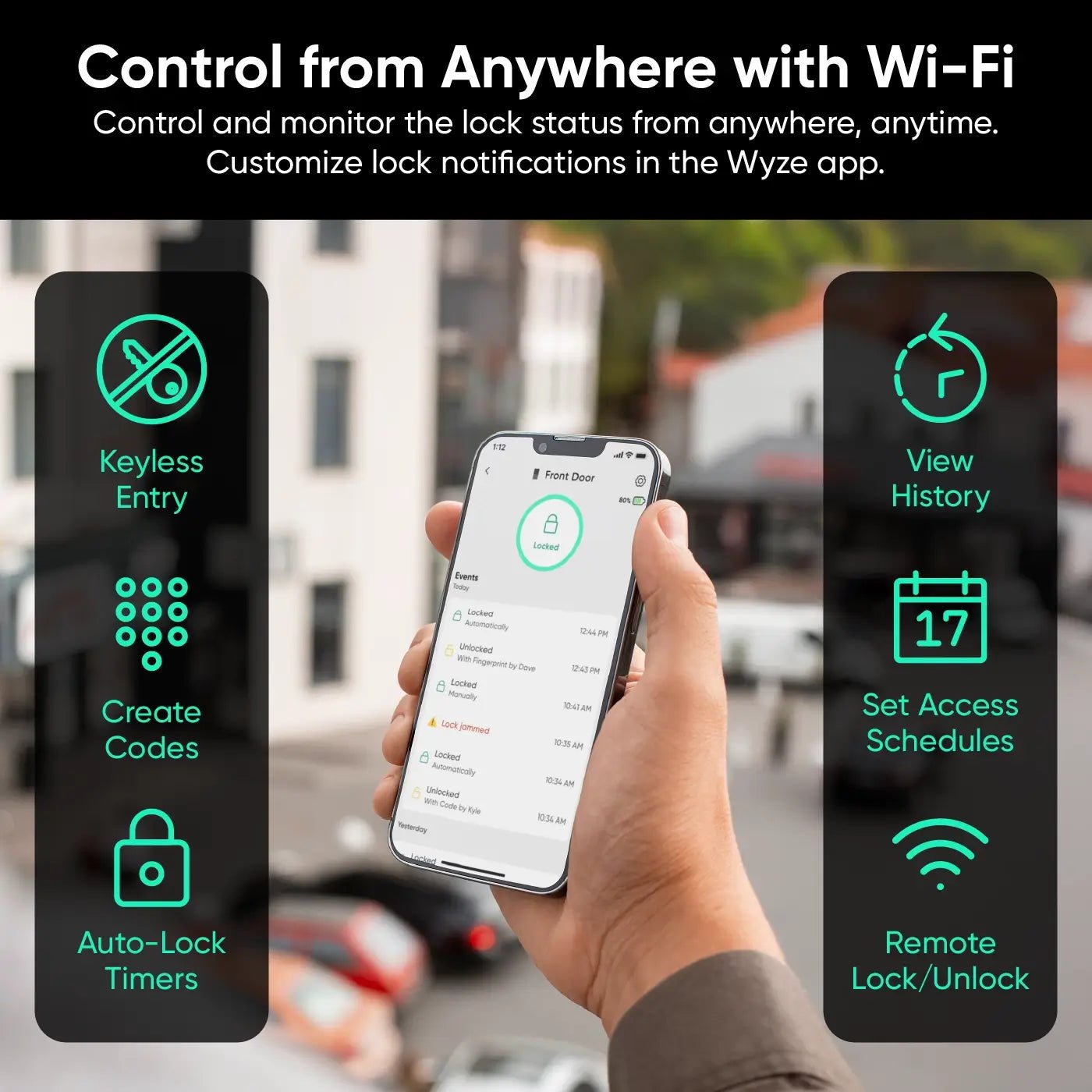

Front door control, even when you’re not home.
With built-in Wi-Fi, you can lock or unlock the door, check status, and view activity from the Wyze app—no matter where you are.

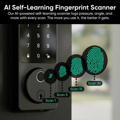

Faster, more reliable unlocks over time.
Traditional locks learn your fingerprint once—and any change means the dreaded “try again.”
Wyze Lock Bolt v2 uses an AI self-learning fingerprint scanner that updates your profile with every touch, adjusting for pressureangle, and tiny skin changes.
This means fewer failed scansfaster unlocks, and more reliable entry when your hands are cold, sweaty, or your kid taps it at a weird angle.

A keypad that looks better and works smarter.

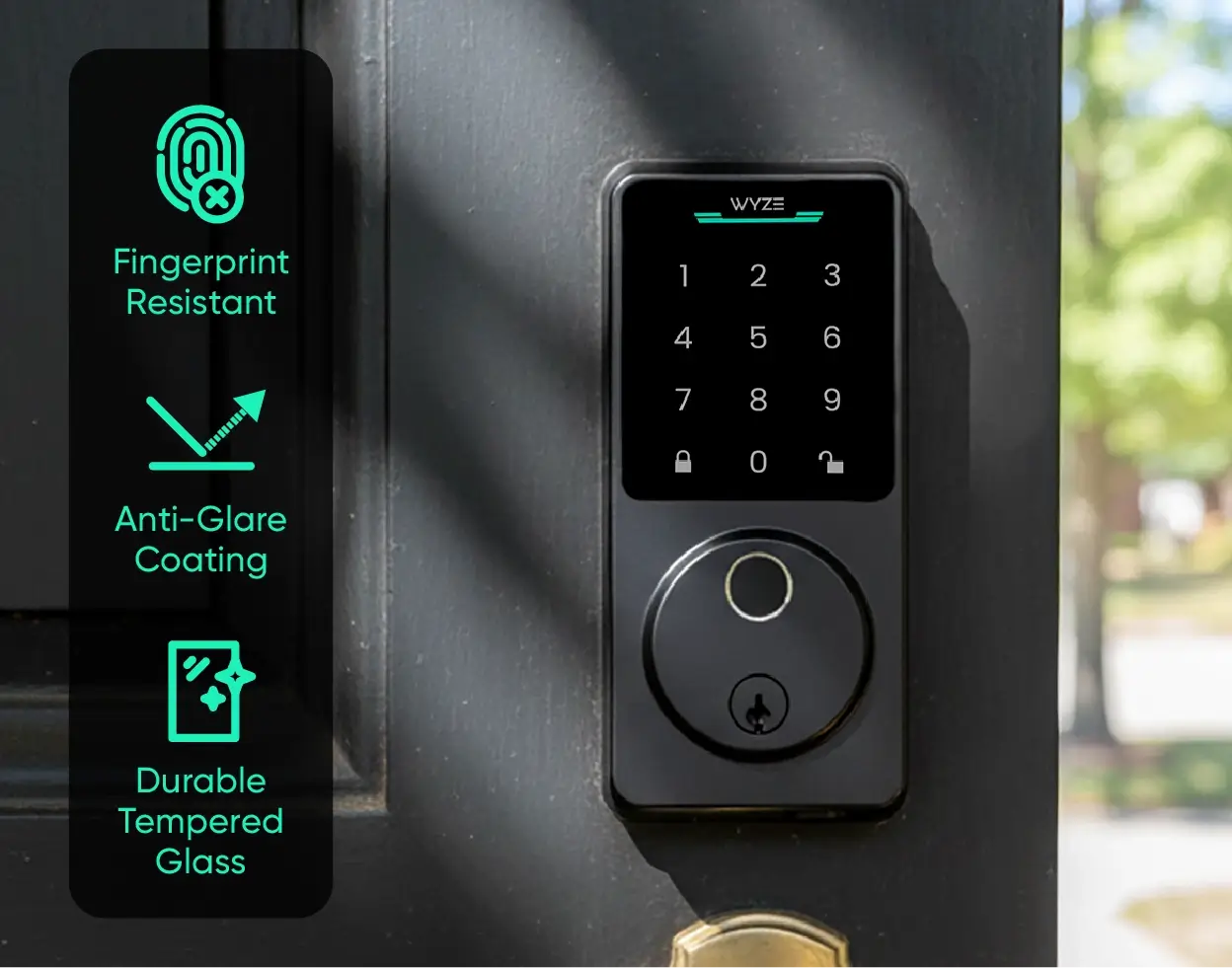

  •  Durable, Anti-Glare Tempered Glass
    Unlike plastic keypads that peel, fade, and crack, Wyze Lock Bolt v2 uses high-grade tempered glass that resists scratchessmudges, and glare, keeping numbers easy to read and your entryway looking sharp—even after rainy commutes, muddy hands, and daily use by the whole family.

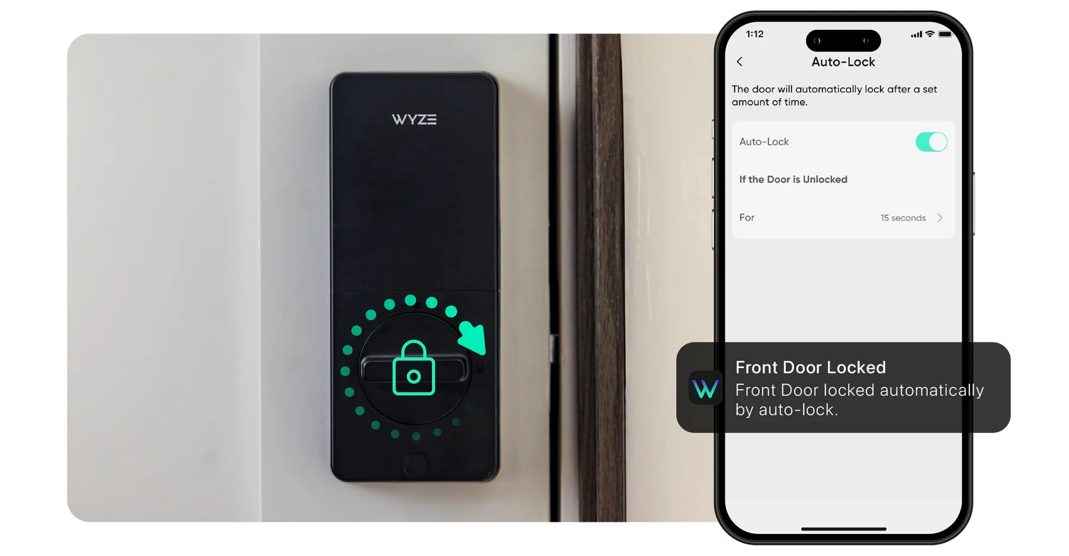

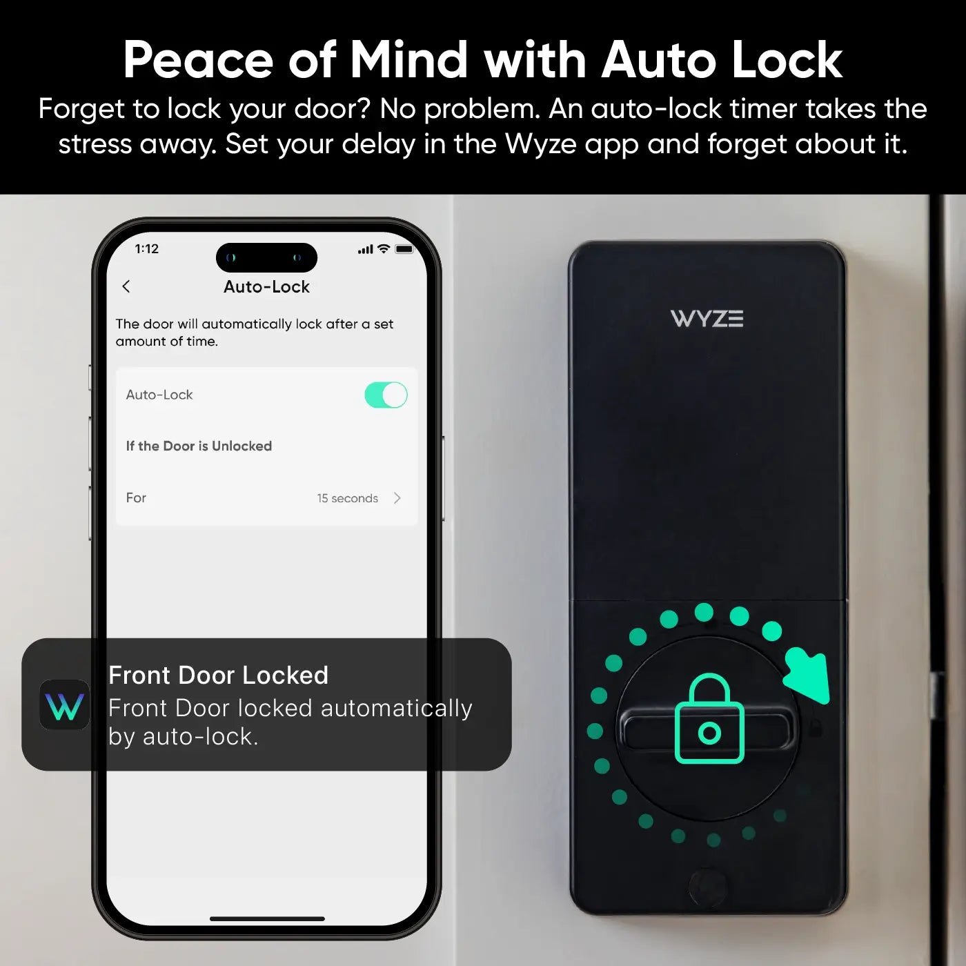

Your door locks itself so you don’t have to.
Set a custom auto-lock timer in the Wyze app and Wyze Lock Bolt v2 will lock the door for you after that time passes, so “Did I lock the door?” is no longer a question.

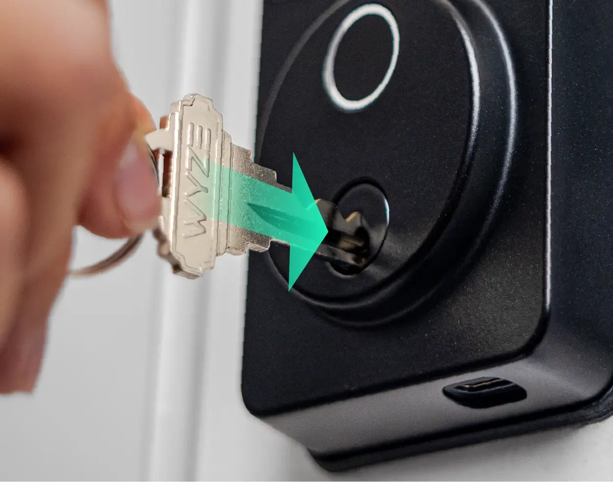

Smart lock convenience, classic key backup.
Wyze Lock Bolt v2 is designed to be totally keyless for everyday use, but it still includes a hidden traditional keyway and backup keys for peace of mind.

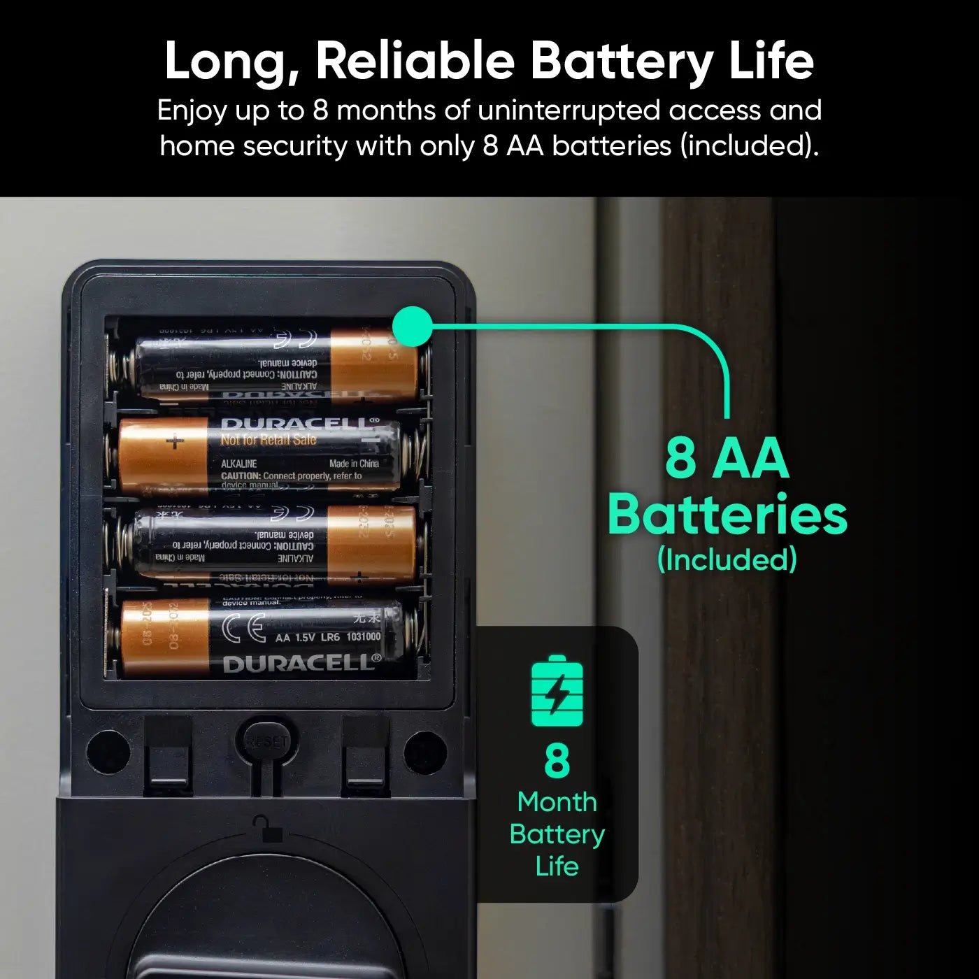

Months of power, zero daily worry.
With up to 8 months of battery life from the included AA batteries, Wyze Lock Bolt v2 is built for the long haul. You’ll get low-battery alerts well before they run out, so you’re never surprised at the door.

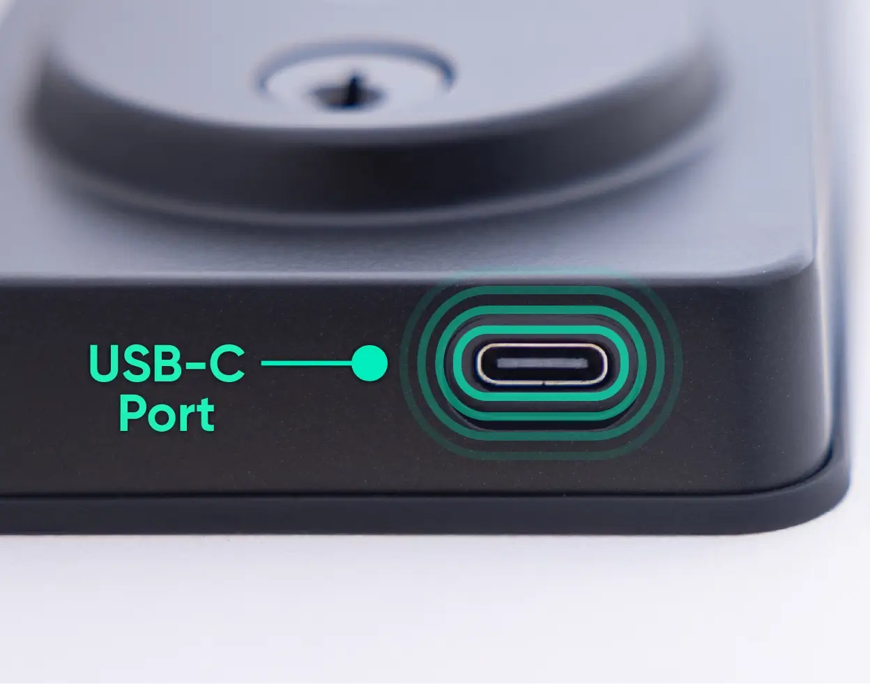

Emergency power so you’re never locked out.
If the batteries ever fully die while you’re outside, simply connect a USB-C power bank to the emergency port, power the lock for a moment, and enter your code to get in—no lockouts, no locksmiths, ever!

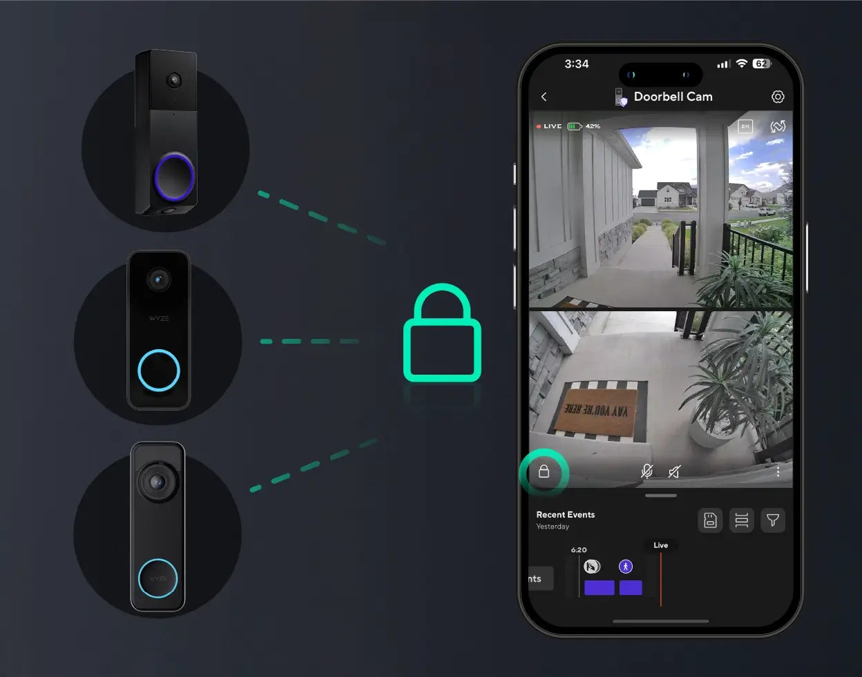

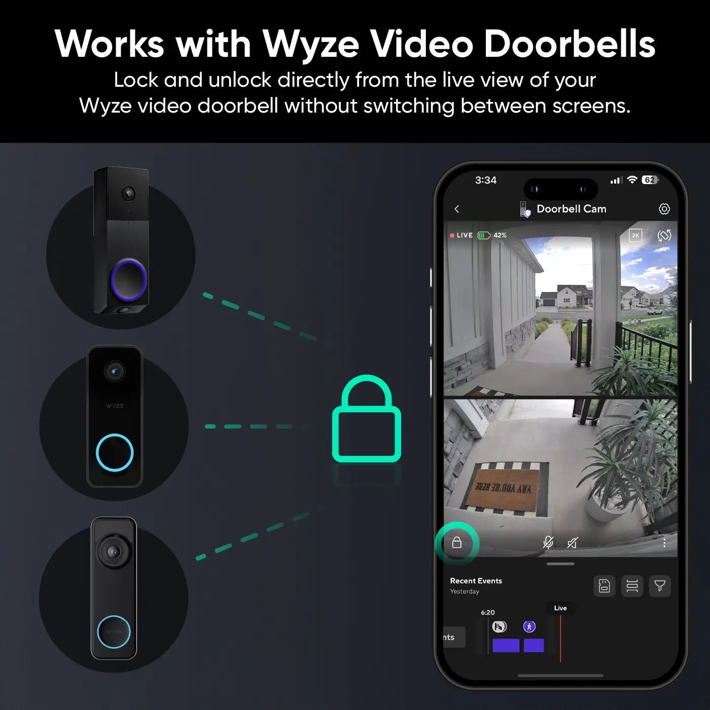

Works with Wyze video doorbells.
Lock and unlock directly from the live view of your Wyze video doorbell without switching between screens to open the door for family and friends.

The Wyze app is your command center.
*Bluetooth connection required for app features.

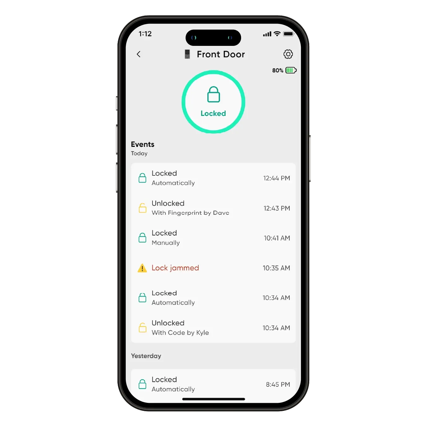

See who stopped by in the Wyze app. You can even view how it was unlocked, the exact time, and if there were any failed passcode attempts.
Create and store up to 50 access codes for family and guests, without manually programming each one into the lock. You can also store up to 50 total fingerprints for frequent users.
Create one-time guest passcodes that expire on a schedule.
Worried about giving out access codes to your home? Use auto-expiring codes so you never have to worry about temporary guests entering without permission. Set the day/time the code expires and never think about it again.

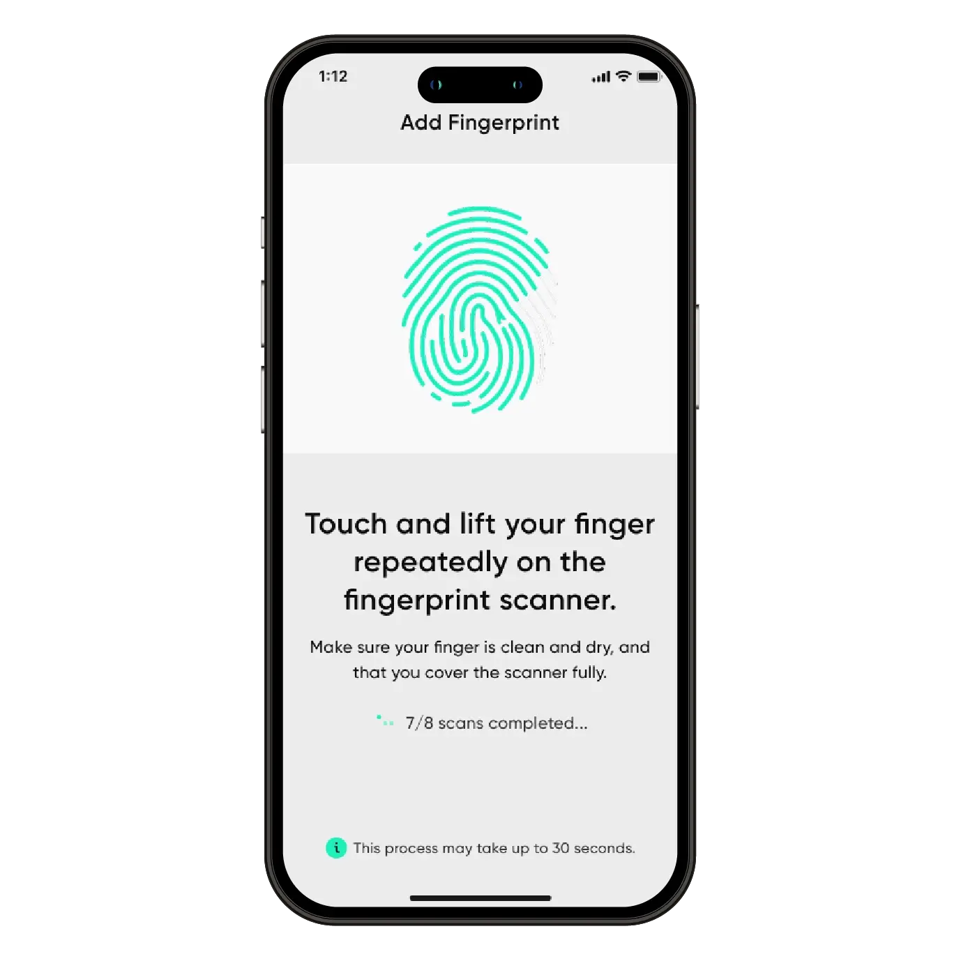

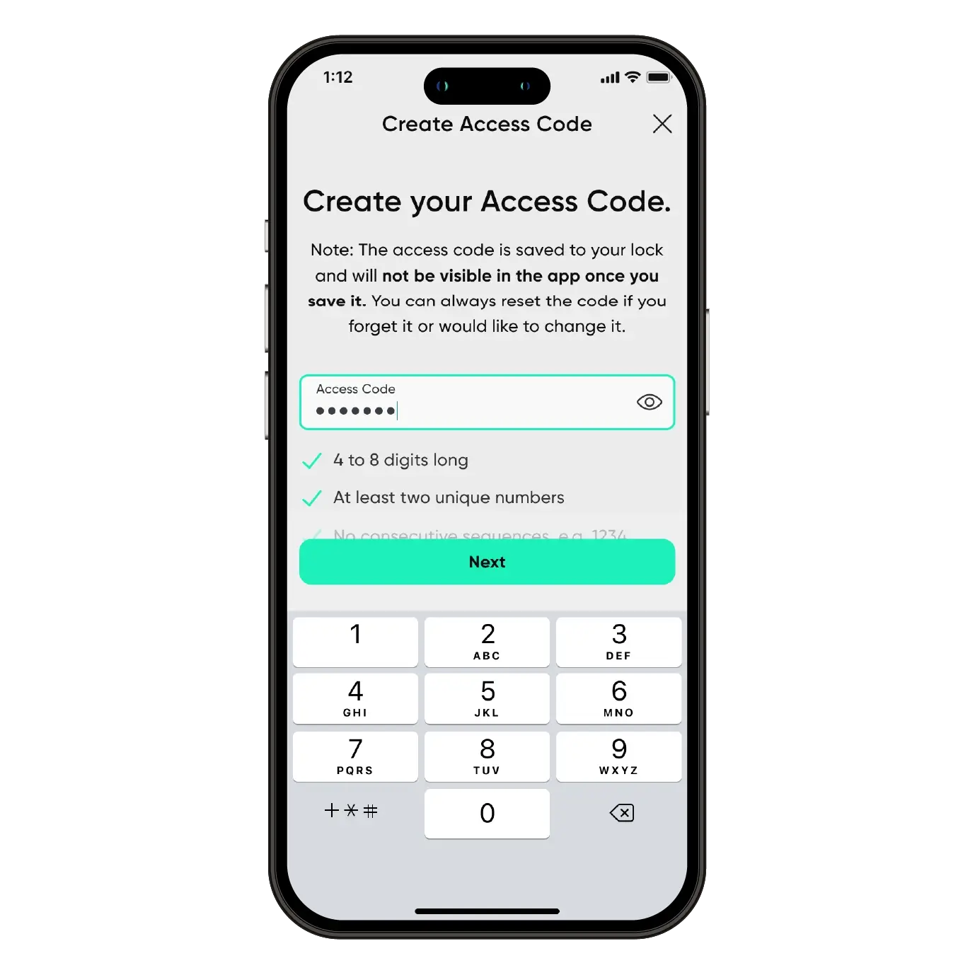

  13. Next, follow the in-app steps to create your Access Code and add your fingerprint.
