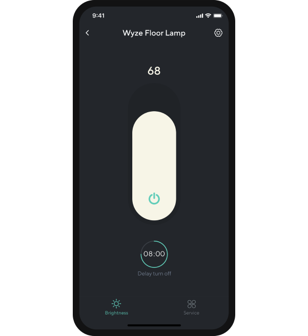

Connects to the Wyze app for more smart lighting options (Bluetooth only)
Wyze Floor Lamp can be connected via the Wyze app for remote control, scheduling timers, smart dimming, sleep mode, and more. Wyze Floor Lamp can be updated through the app to add more lighting experiences and features after purchase.
Control via the Wyze App for on/off and 100 brightness levels
Through the Wyze App, you can learn the status of Wyze Floor Lamp for current brightness preference and next schedules.
With Delay Timer on the app, Wyze Floor Lamp will be turned on or off after a set period of time. You can set it as a bedtime light.
With Schedules on the app, Wyze Floor Lamp will automatically turn on, turn off or adjust the brightness levels.
