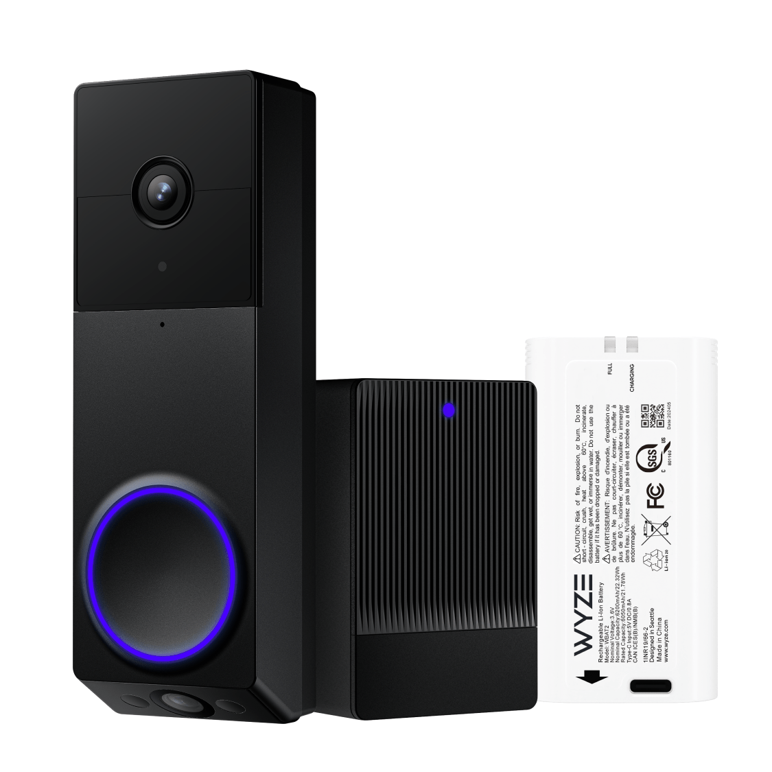

Duo Cam Doorbell + Extra Battery
Battery 2K Doorbell with Dual Cameras

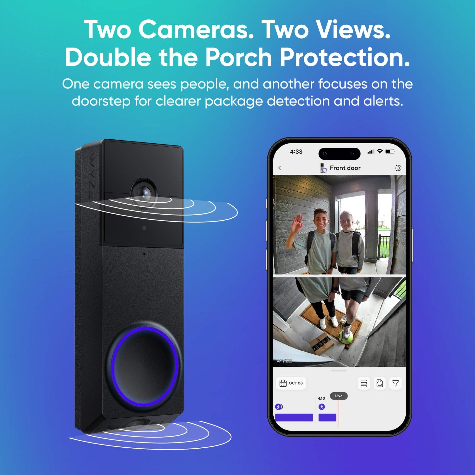

    Two Cameras. Two Views.
    One camera sees people, and another focuses on the doorstep for clearer package detection.

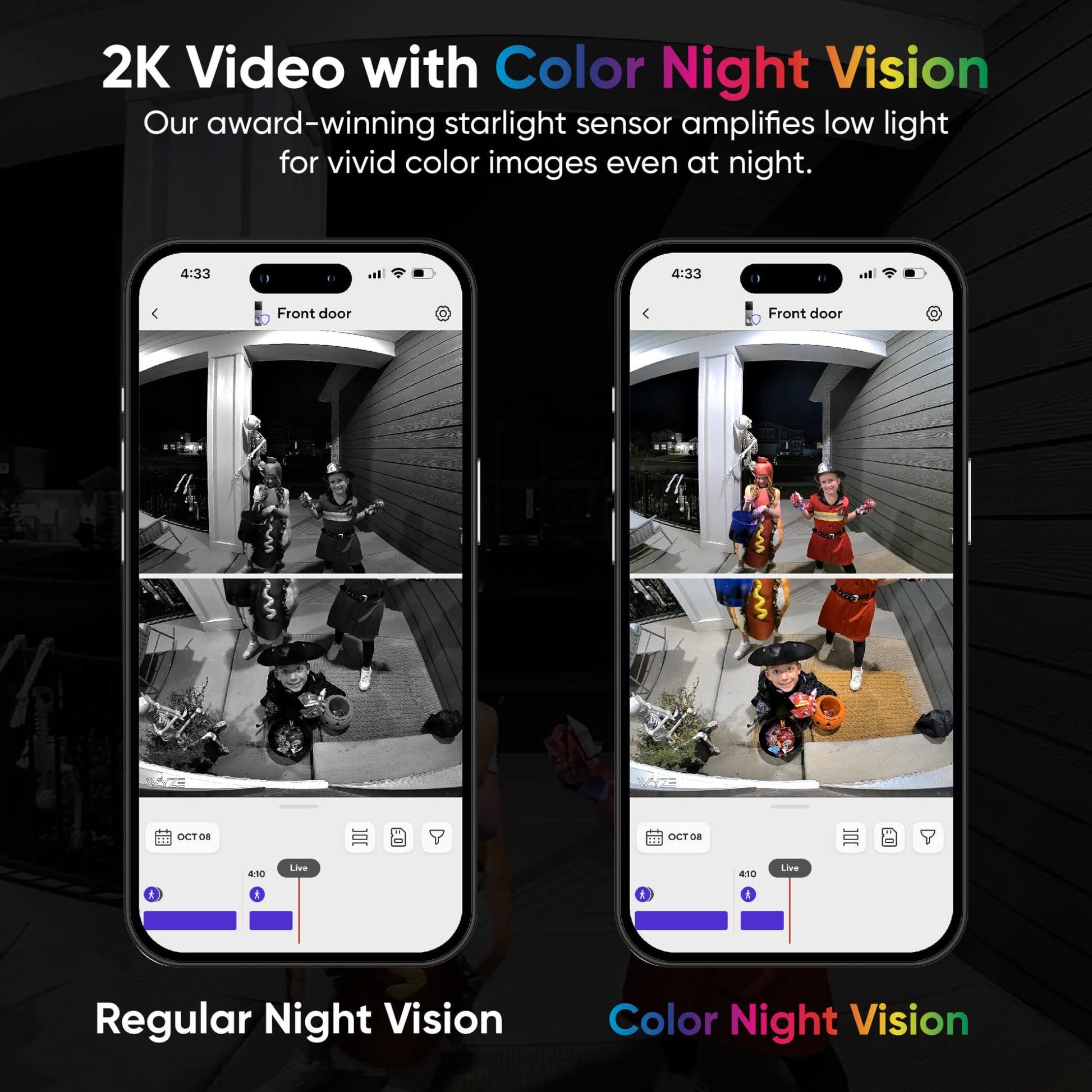

    2K HD Resolution + Color Night Vision
    Our award-winning starlight sensor amplifies low light for color images even at night.

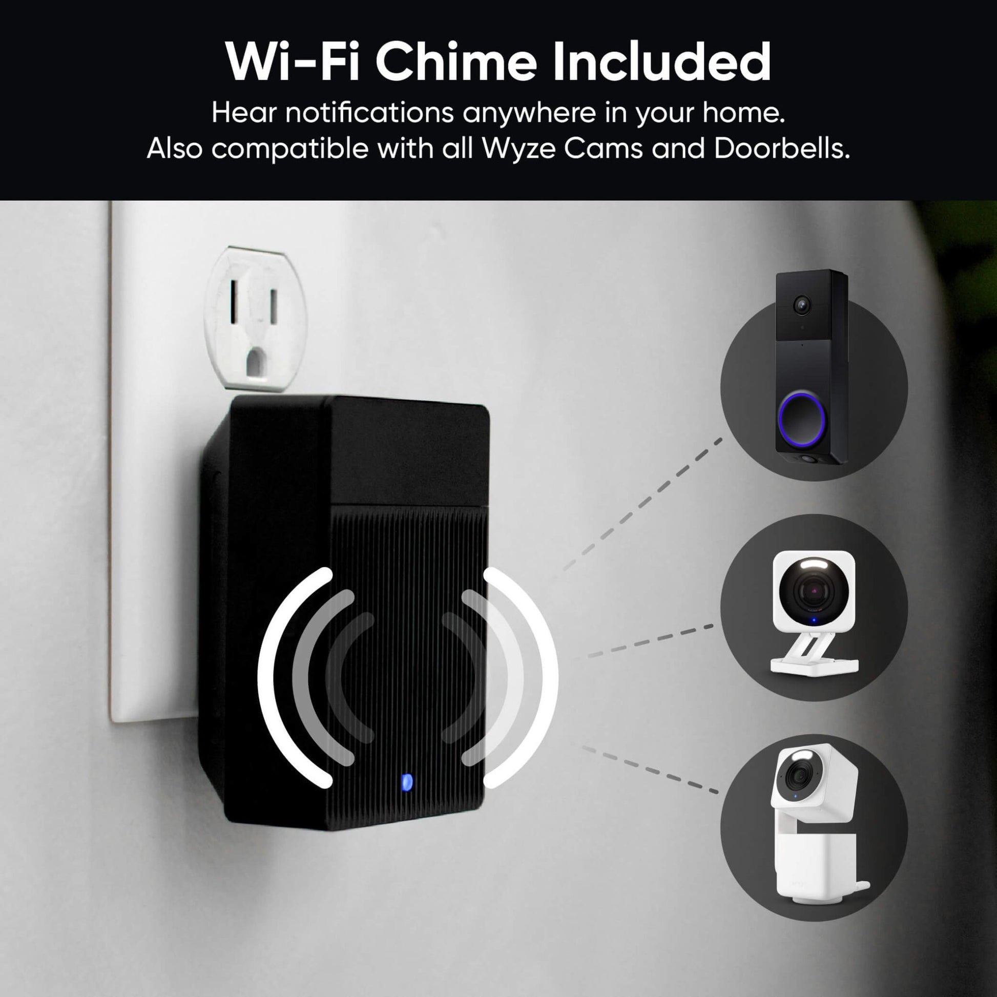

    Wi-Fi Chime Included
    Receive notifications anywhere in your home. Compatible with all Wyze Cams and doorbells.

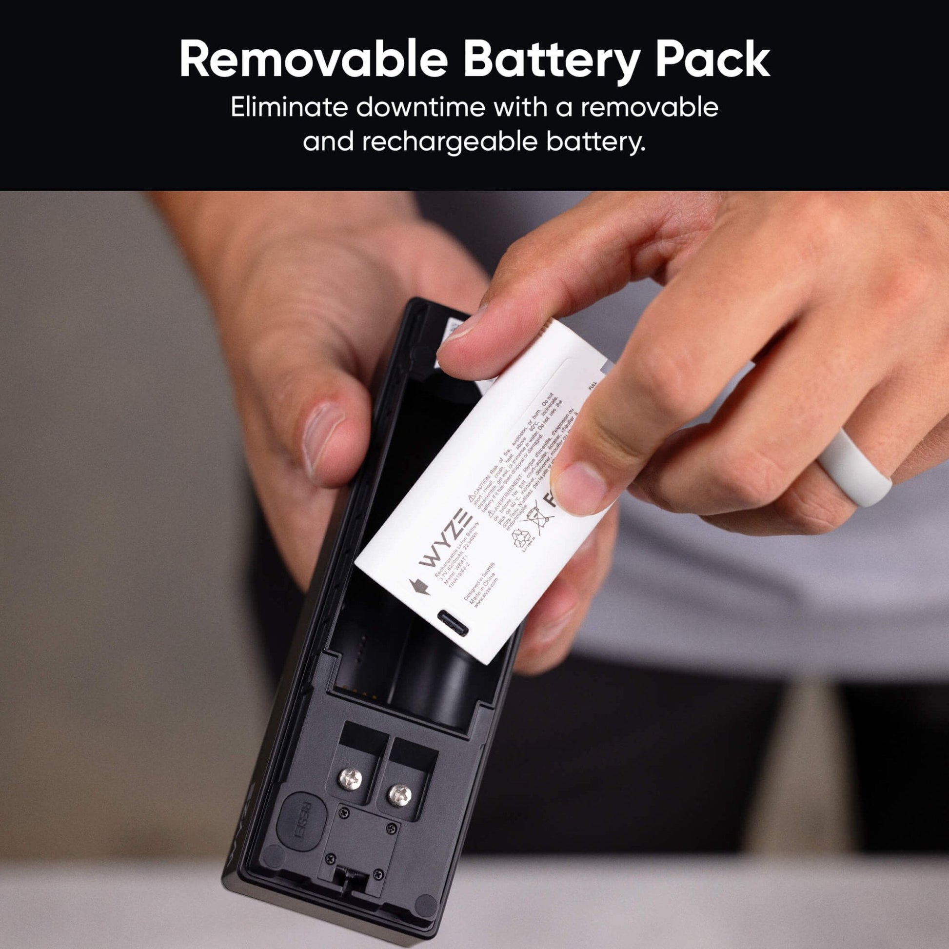

  • Battery
    Battery-powered or Hardwired
    Eliminate downtime with a removeable and rechargeable battery that lasts up to 6 months.

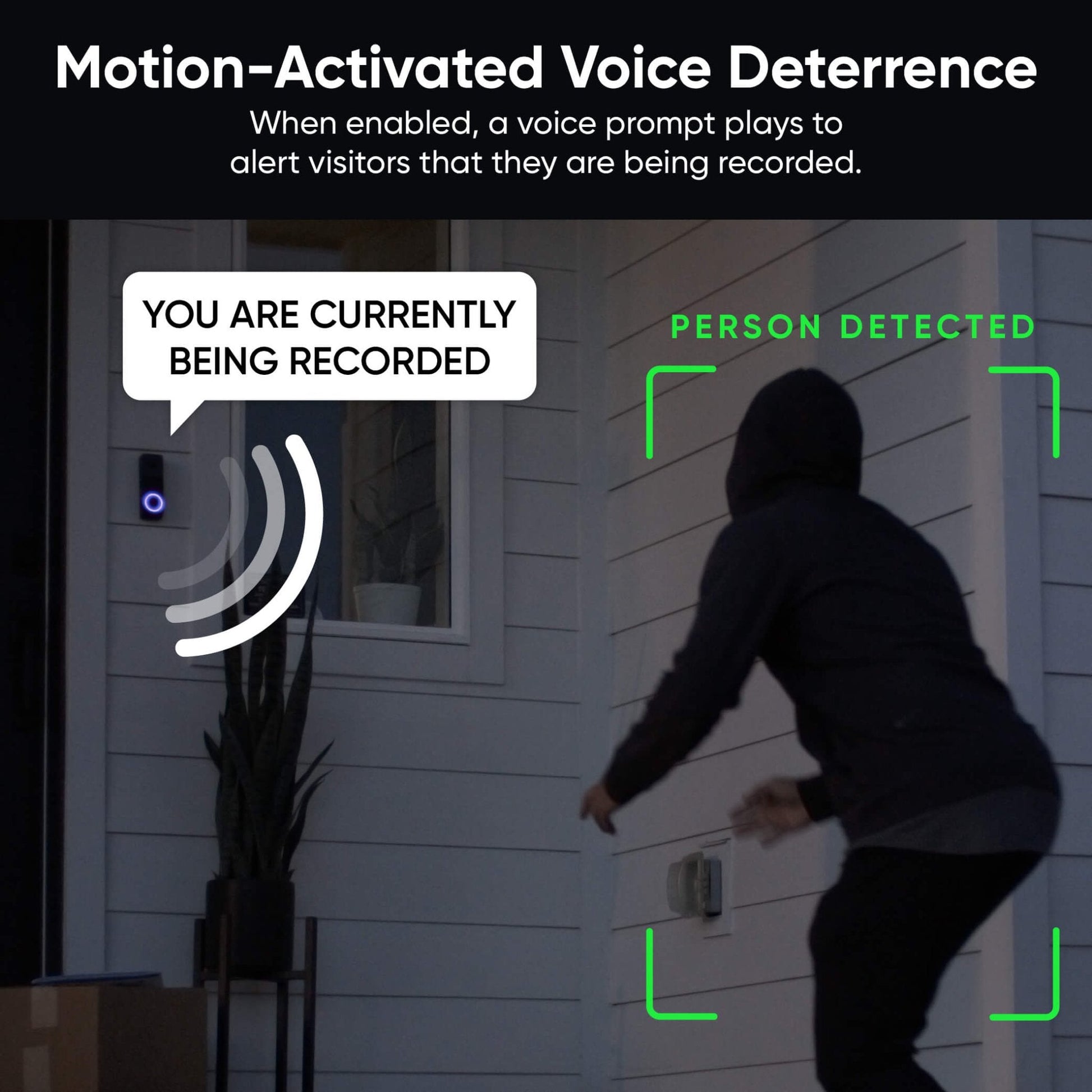

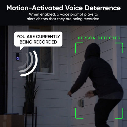

  • Motion Warning: “Hi, you’re currently being recorded.”
Wyze Removable Battery Pack Details
  • Model Number: WBAT2
  • Color: White
  • Weight: 3.9 oz (110g)
  • Dimensions: 2.9 in x 1.6 in x 0.9 in (75 mm x
     40mm x 22 mm)
  • Battery Capacity: 6200 mhA
  • Output Voltage: 3.6 V
  • Input Voltage: 5V DC
  • Charging Current: 800 mA
  • Battery Type: Lithium Ion
  • Connector: USB-C
  • Operating Temperature: -4℉ to 122℉ (-20°C to 50°C); Humidity
    < 90%
  • Charging Temperature: 32℉ to 122℉ (0°C to 50°C); Humidity
    < 90%
  • Fully Charging Time: Approximately 9h at 25°C/77℉

Two Cameras. Two Views. Double the Porch Protection.
Some is good. More is better. And Wyze Duo Cam Doorbell with TWO cameras and full porch coverage is the punch that'll send porch pirates packing!
Color Night Vision
2K Video Resolution with Color Night Vision
Capture all porch arrivals and departures in greater detail. Our award-winning starlight sensor amplifies low light for vivid color images even at night.
Ding dong from anywhere. Hear alerts exactly where you want in your home. Built-in Wi-Fi enables you to trigger audio alerts with all Wyze Cams and Doorbells.
If you are interested in using Duo Cam Doorbell with your existing mechanical or digital chime, check out Wyze Chime Controller for compatibility.

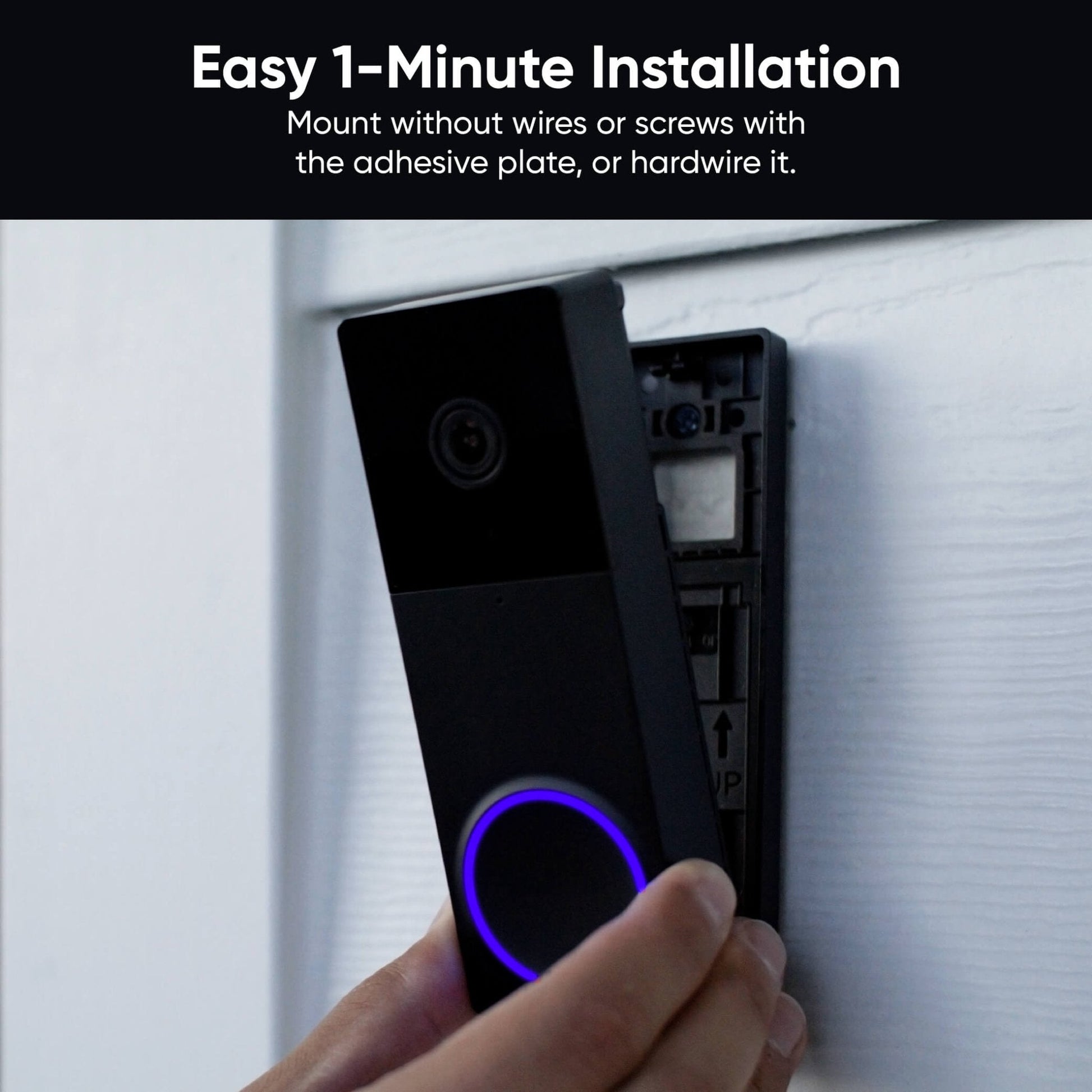

Easy 1-Minute Install
Mount it in two shakes of a dog's tail with the included adhesive strips. No wires or screws. I'm paw-sitively certain you'll have it up in no time. You can also wire it if you really want to.

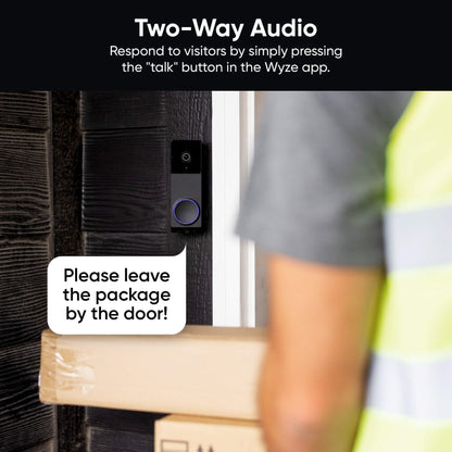

A sign on a door that says "Please leave the package by the door!

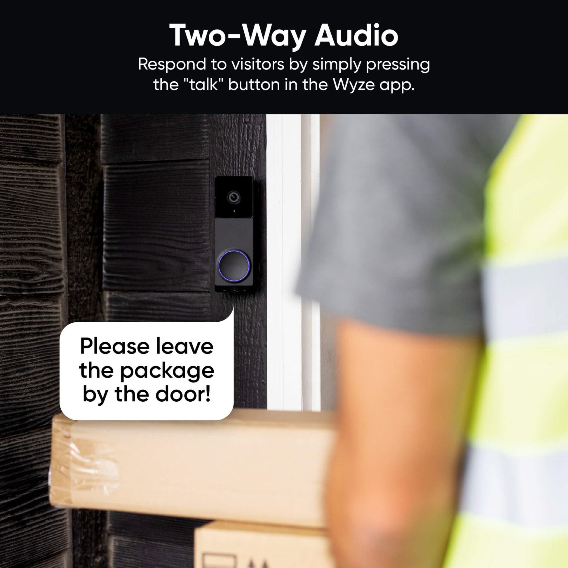

Two-Way Audio
Act like a celestial messenger who knows neither time nor space and answer your door from anywhere. Somehow "Please leave my curly fries right there" feels more dignified when replying via the Wyze app.

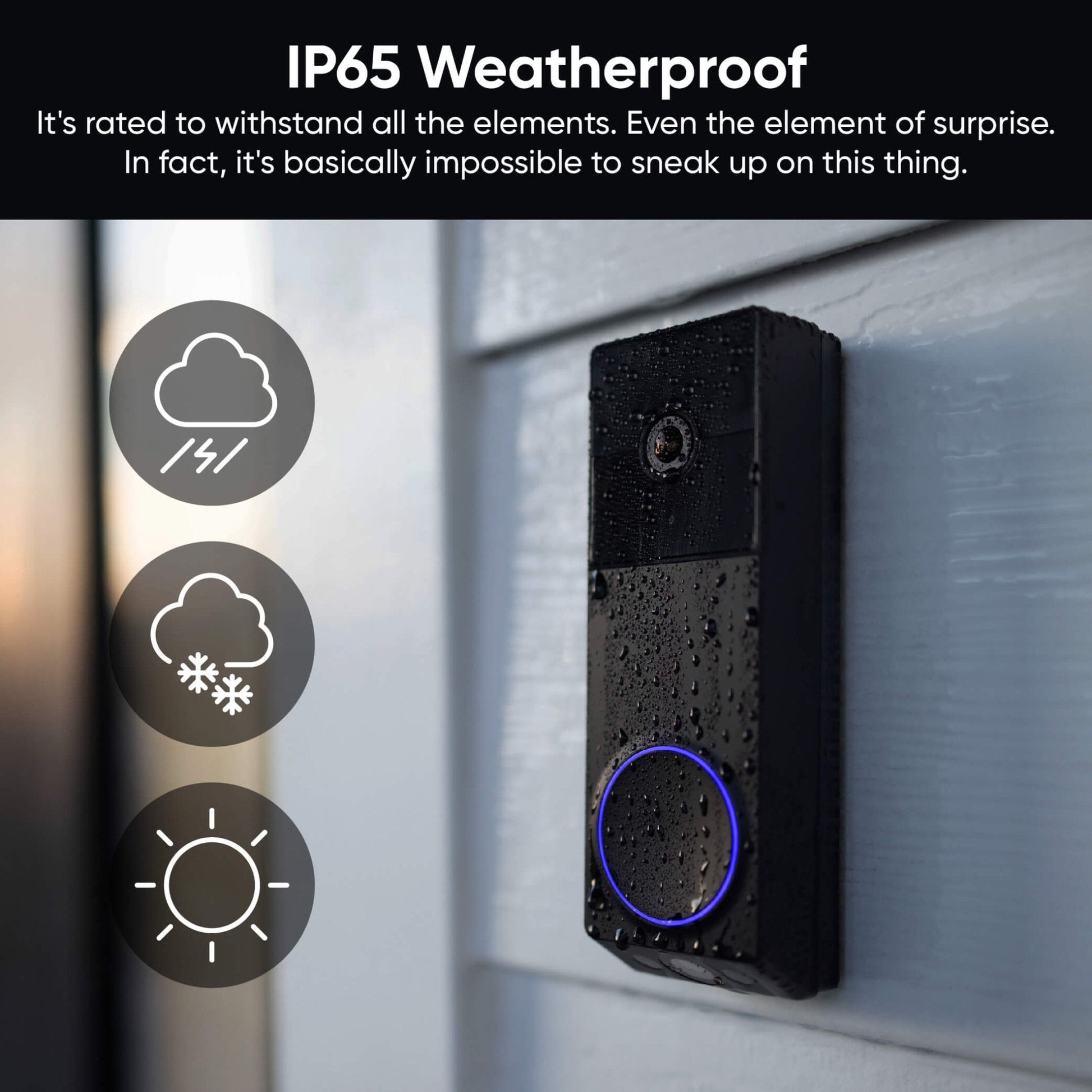

A Wyze Duo Cam Doorbell is shown on a white wall.
IP65 Weather Resistant
It's rated to withstand all the elements. Even the element of surprise. In fact, it's basically impossible to sneak up on this thing. Did we mention it has TWO cameras?

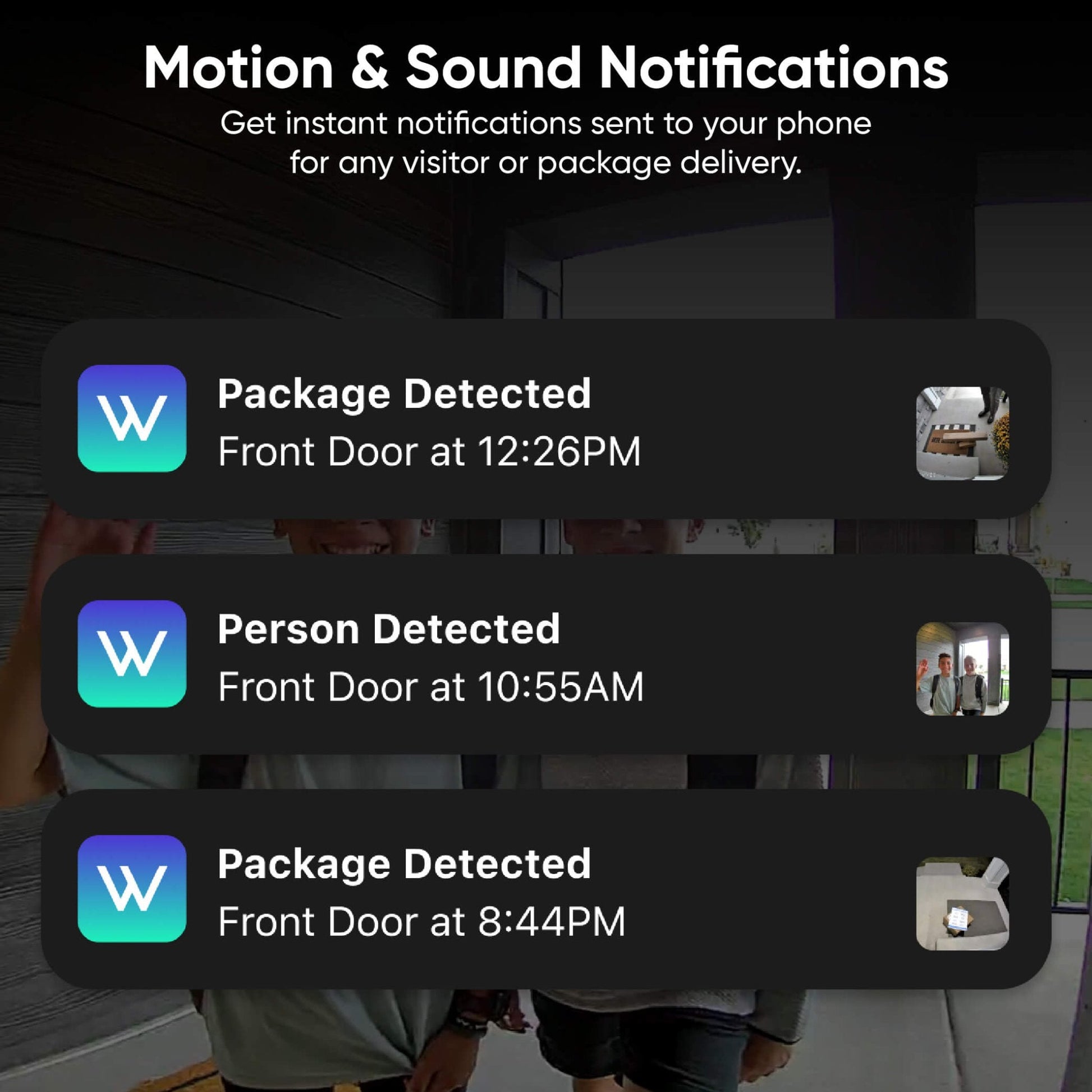

    Motion & Sound Notifications
    Get instant notifications sent to your phone for any visitor or package delivery.

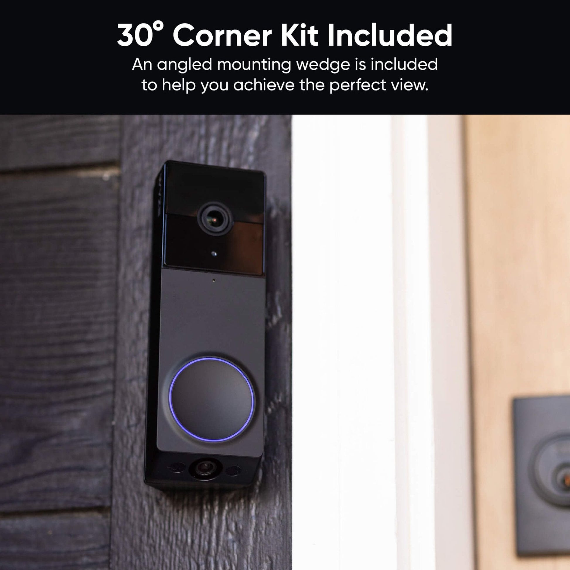

  • A black and white image of a 30 degree angle.
    30° Corner Kit Included
    An angled mounting wedge is included with every doorbell to help you achieve the perfect view.

Use 3M if you don't want to drill any holes.
  1. Remove the adhesive backing from the back plate, then stick the back plate to the wall.
  2. With the battery installed, mount it to the back plate. Start from the bottom up!
    If you place it from the top first, use the Doorbell Detaching Pin to remove it and try again.
  3. You're all set!
