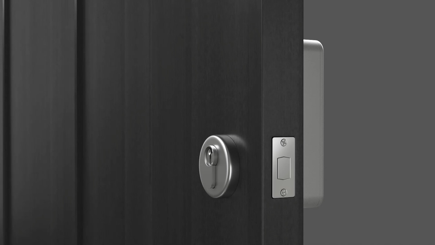

Wyze Lock only replaces the interior side of your existing deadbolt, so it's much quicker (and easier) to install than a complete deadbolt replacement.
