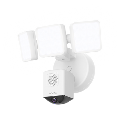

Wyze Cam Floodlight Pro combines a 180° wide-angle lens and 2.5K QHD video so you can see your yard end-to-end in more detail than ever. It relies on evolutionary onboard AI computer vision to detect motion and turns on the adjustable 3,000 lumen LED lights only from objects you select, like people and vehicles. In other words, we created a high-powered security camera with bright lights that thinks and responds like a personal home security guard—no donuts required. 2.4 & 5Ghz WiFi support.
    180° Ultra-Wide Field of View
    Full coverage. No blind spots.
    2.5K QHD Resolution & Color Night Vision
    Capture more details.

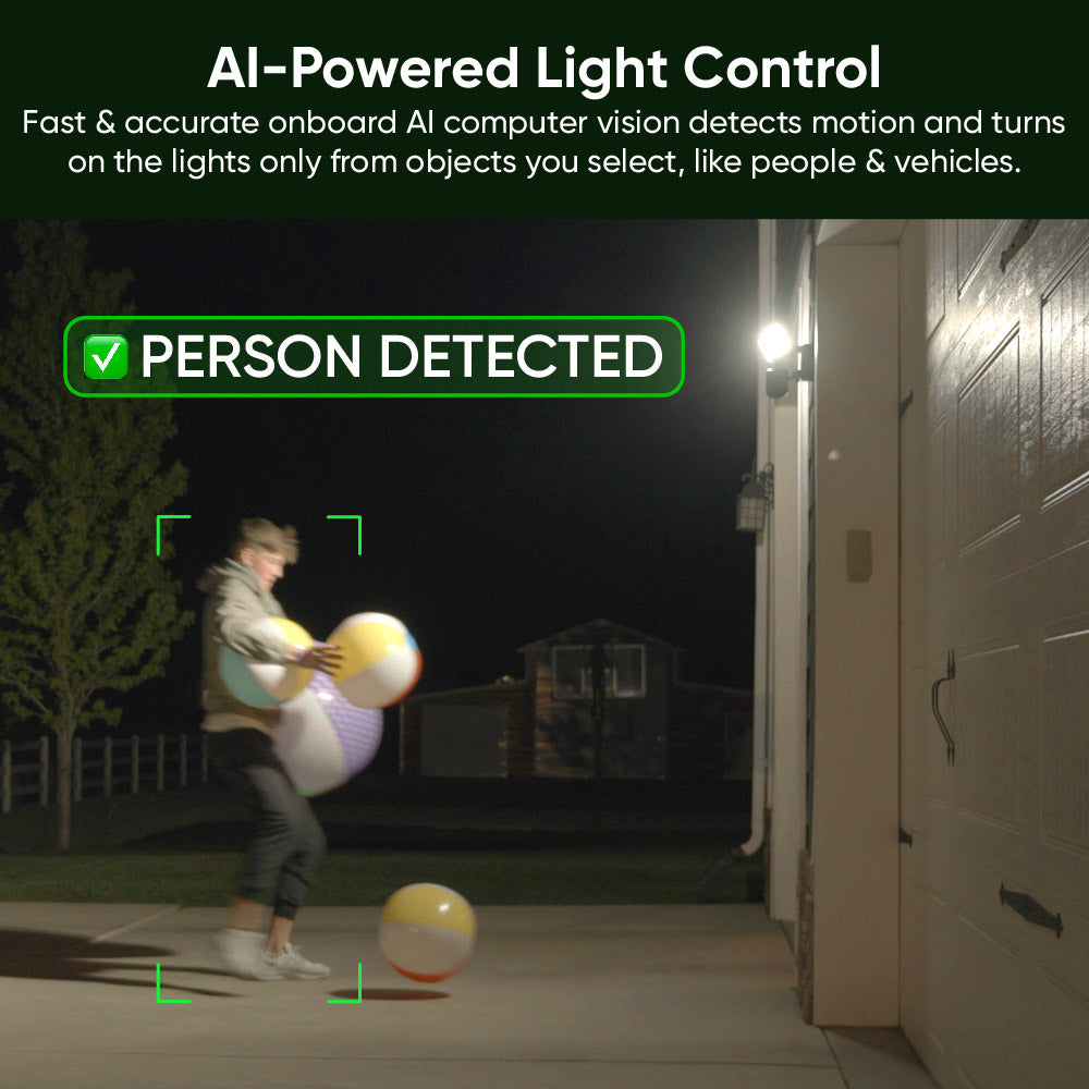

    AI-Powered Light Control
    More accurate than PIR.

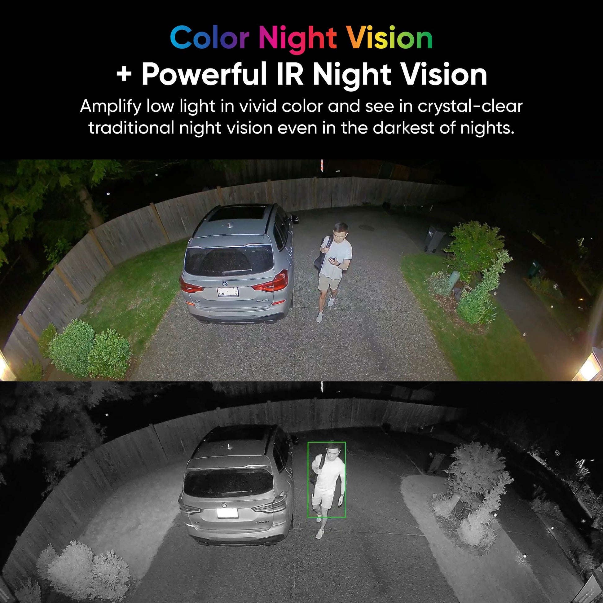

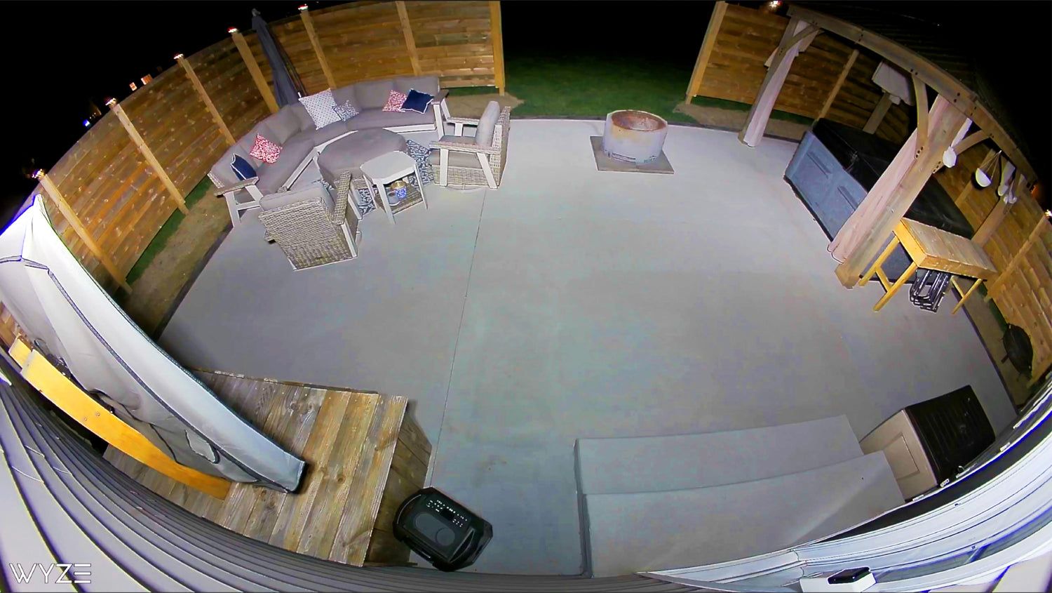

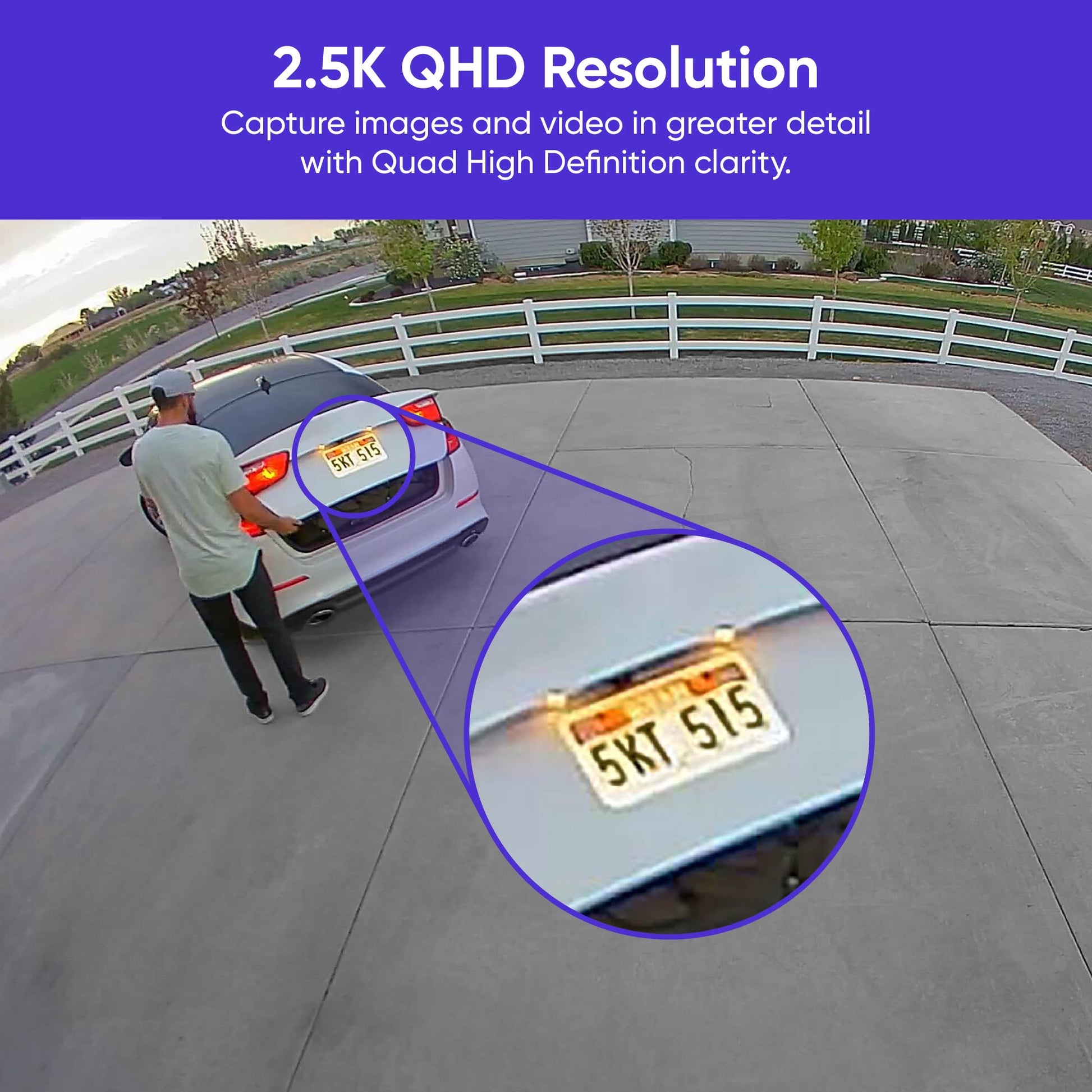

Capture more details with 2.5K QHD resolution + Color Night Vision.
See images and video in greater detail with Quad High Definition clarity. Day or night you get video so crisp it makes bacon jealous. Mmm, bacon.
A patio with a fire pit and a wooden deck. A backyard at night with a fire pit and a patio set.
Day
Night
More accurate motion-activated lights powered by vision AI.
Goodbye, clumsy PIR technology. Onboard AI computer vision detects motion and turns on the lights only for objects you select, like people and vehicles. Plus, get notifications sent to your phone.

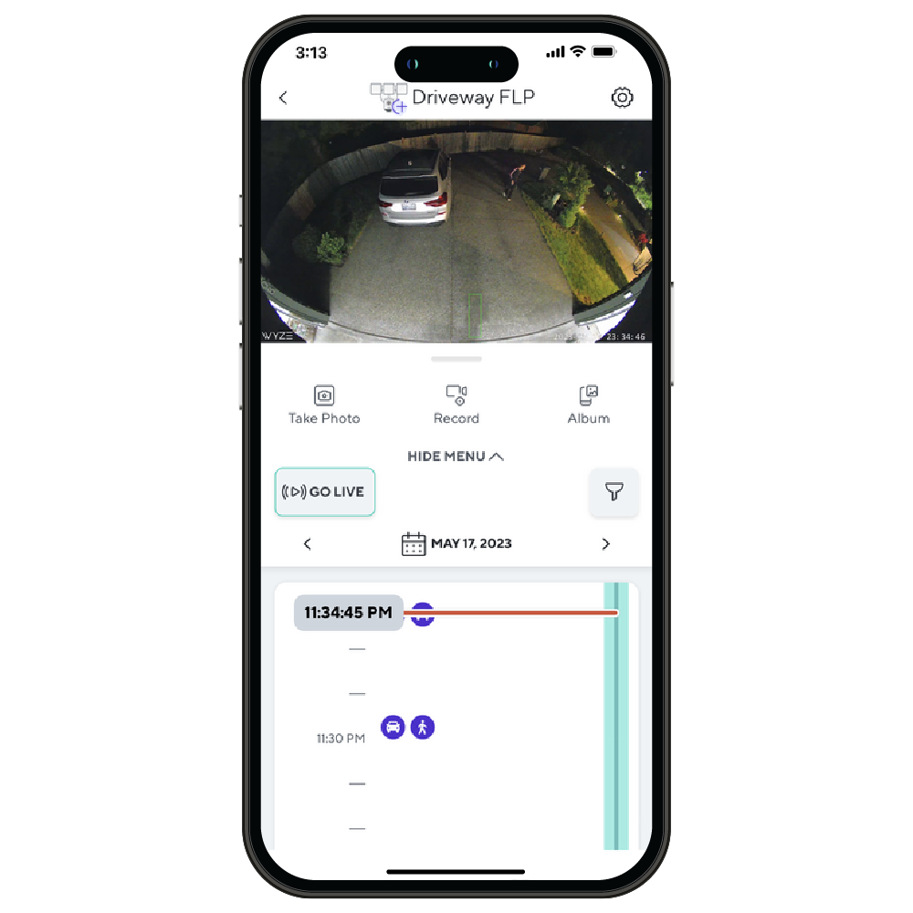

A smartphone displaying a live feed of a driveway.

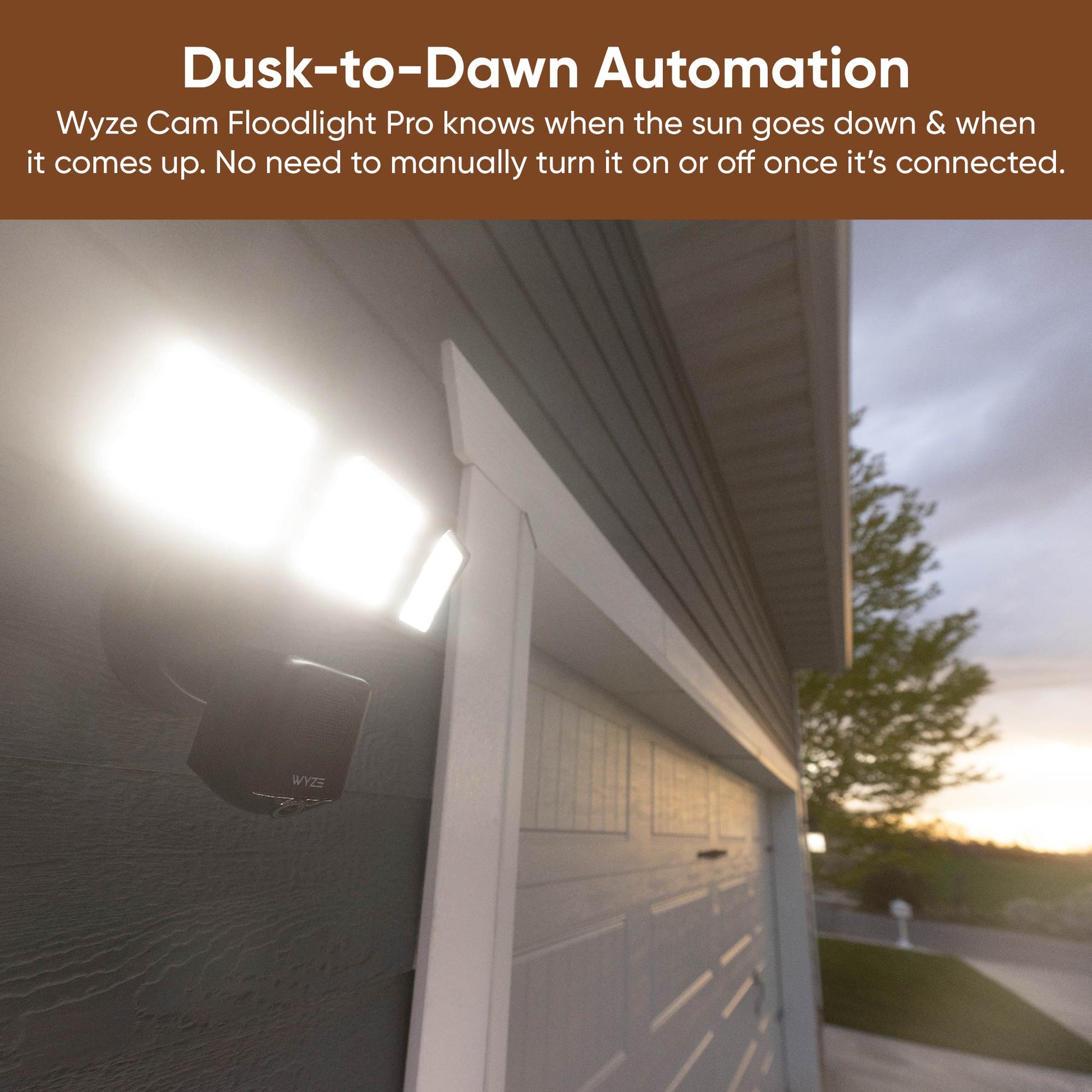

Wyze Cam Floodlight Pro knows when the sun is down and when it’s up. Just hook it up and never think about your light switch again.

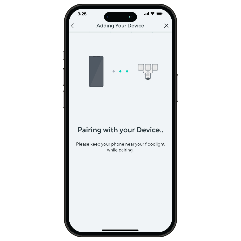

To set up your Wyze Cam Floodlight Pro:
  1. After completing the installation process in the Wyze app, tap Begin Setup. Floodlight not installed? Follow the steps listed in our Wyze Cam Floodlight Pro Installation Guide before beginning setup.
  2. Make sure that the status light under the camera changes from solid red to either flashing purple or solid blue. This may take up to 2 minutes. If the light does not turn on or update, press and hold the setup button on the back of the camera for 10 seconds to reboot.
  3. Check the box next to Light turned to flashing purple or solid blue then tap Next.
  4. Wait for a voice prompt. You should hear “ready to connect”. If there is no voice prompt within 2 minutes, press and hold the setup button on the back of the camera for 10 seconds until the status light turns red to reboot.
  5. Check the box next to It said, “Ready to connect.” then tap Next.
  6. If BluetoothⓇ hasn’t already been enabled, you’ll be prompted to allow BluetoothⓇ access. Tap OK. If BluetoothⓇ has already been enabled, it will skip to the next step. Setting up multiple floodlights at once? Select the last 4 digits of the floodlights’ MAC addresses. The MAC address can be found on the side of the floodlight’s base.
  7. Select your 2.4 GHz or 5 GHz Wi-Fi network and enter your network password. Tap Next. Tap the icon in the password field to display the password to ensure it was entered correctly.If your floodlight location is far from your router or there are multiple walls between them, we recommend selecting your 2.4 GHz Wi-Fi network.
  8. Name your Wyze Cam Floodlight Pro using the text field, or by choosing a suggestion. Tap Finish when done.
  9. You are all set! Your floodlight is set up and ready to go. Tap Done.
  10. You may have a prompt for a free trial of Cam Plus. Tap Continue.
  11. Set up some automations on the Things to Try* page, or tap Skip.
  12. If you want to share your device, tap Share Device. If not, tap Maybe Later.
