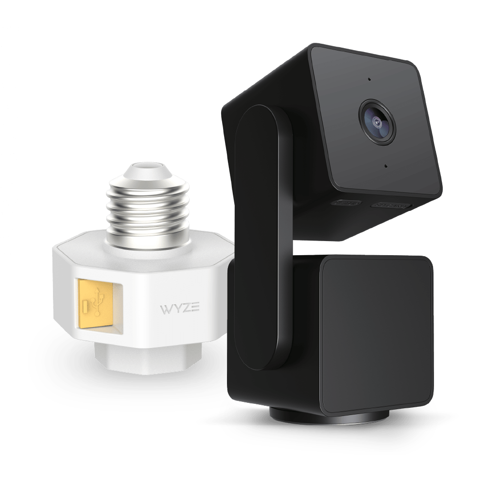

Make your exterior lighting even smarter with this power duo. With our latest lamp socket, you can now power Pan v3 without the need for an outlet.
  • A black camera with a white lens.
    Conveniently Power Wyze Cams
    No creative extension cord weaving required. Compatible with Cam v3/v3 Pro/Cam v4/OG/Pan v3/Pan v4.
    Motion-Activated Lights
    Converts standard bulbs into motion-activated security lights.
    Linkability, without limits
    Assign unlimited lamp sockets to your Wyze Cam automated, group-controlled lighting.
    Dusk to Dawn Scheduling
    Automatically turn your lights on at sunset and off at sunrise.
