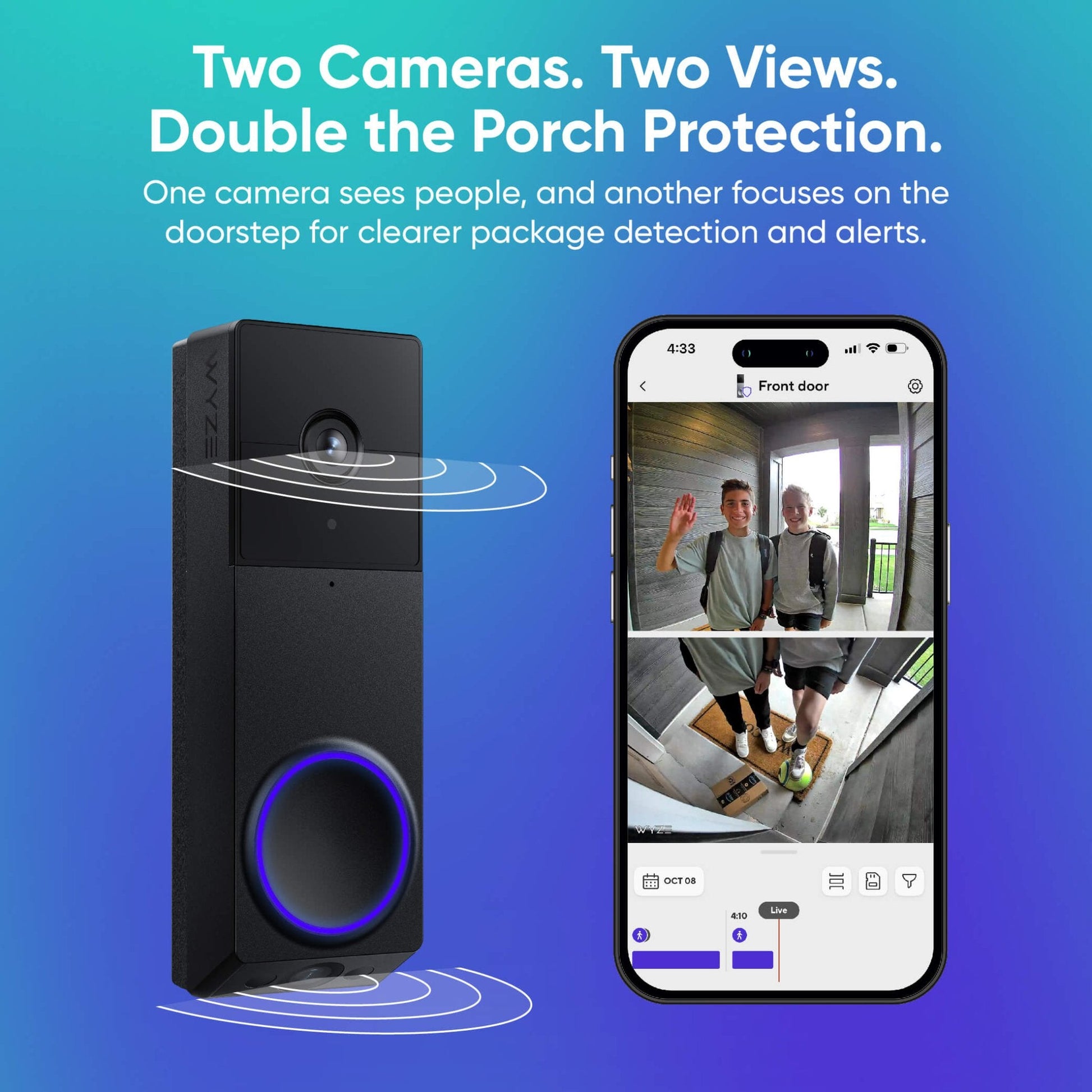

Two Cameras. Two Views. Double the Porch Protection.
Some is good. More is better. And Wyze Duo Cam Doorbell with TWO cameras and full porch coverage is the punch that'll send porch pirates packing!

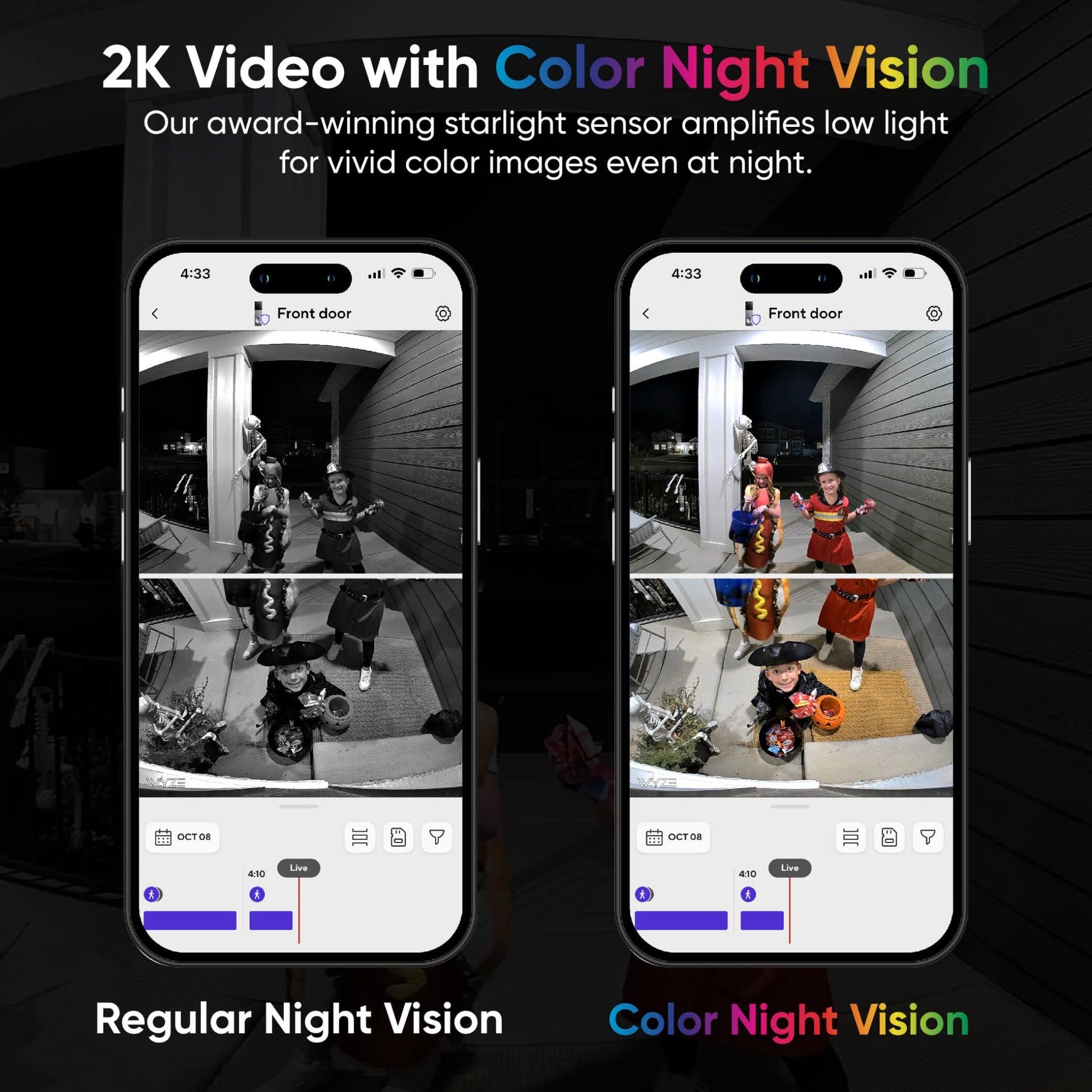

Color Night Vision
2K Video Resolution with Color Night Vision
Capture all porch arrivals and departures in greater detail. Our award-winning starlight sensor amplifies low light for vivid color images even at night.

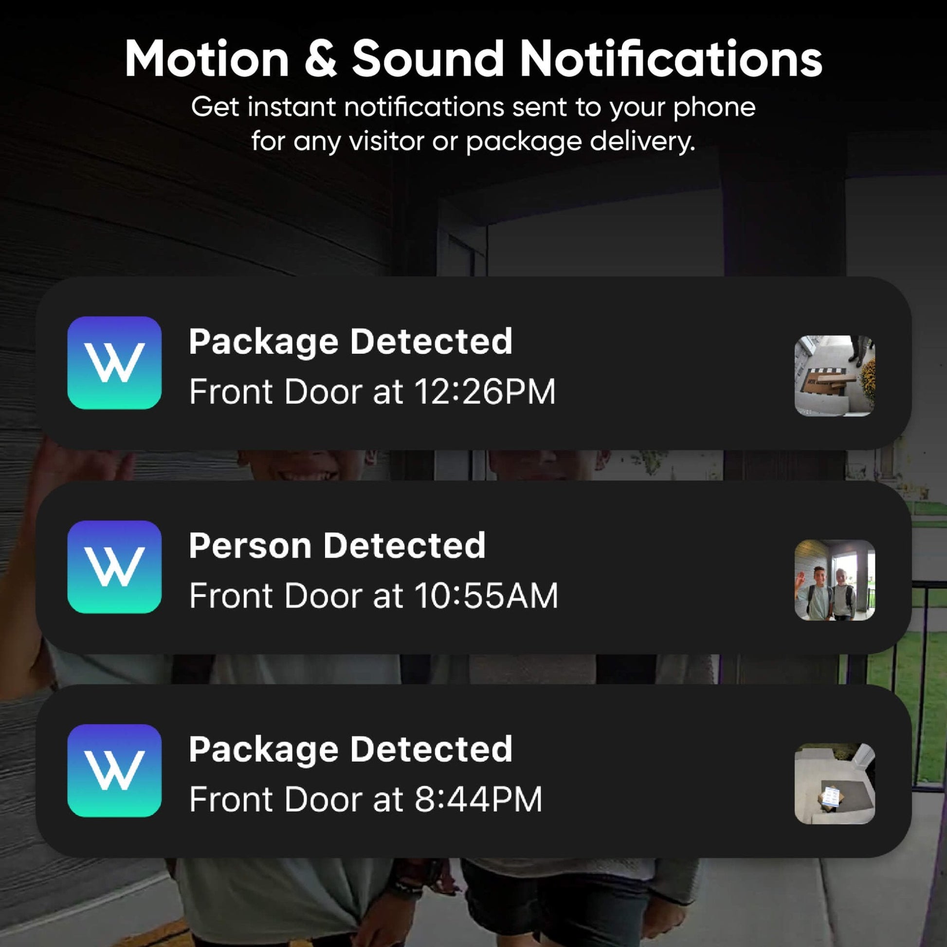

    Motion & Sound Notifications
    Get instant notifications sent to your phone for any visitor or package delivery.

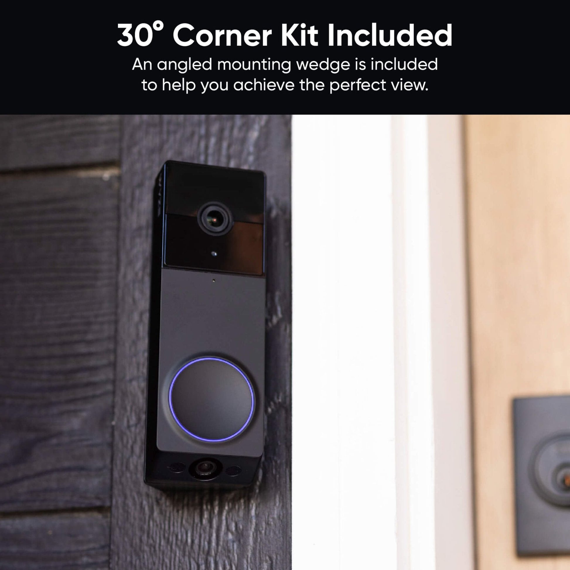

    30° Corner Kit Included
    An angled mounting wedge is included with every doorbell to help you achieve the perfect view.
