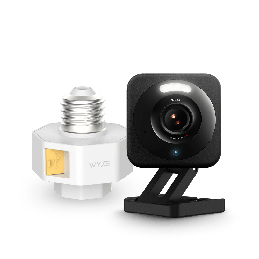

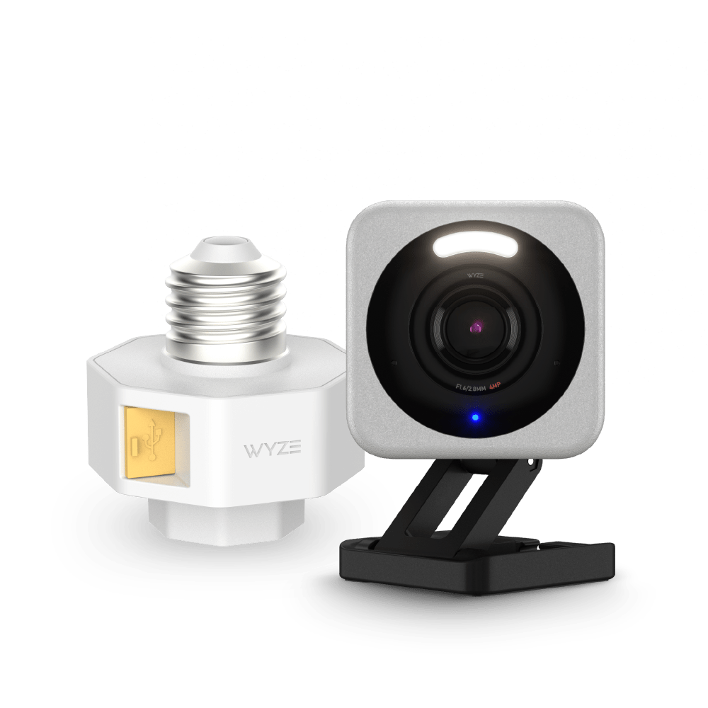

Make your exterior lighting even smarter with this power duo. With our latest lamp socket, you can now power Cam v4 without the need for an outlet.
  • A black camera with a white lens.
    Conveniently Power Wyze Cams
    No creative extension cord weaving required. Compatible with Cam v3/v3 Pro/Cam v4/OG/Pan v3/Pan v4.
    Motion-Activated Lights
    Converts standard bulbs into motion-activated security lights.

Wyze Cam v4
Note: Due to thermal limitations, incandescent bulbs cannot by used with this lamp socket. We recommend using a CFL or LED bulb under 20W, like Wyze Bulb White.
Cam v4 + Lamp Socket v2
Cam v4
  • 1x Wyze Cam v4 unit
  • 1x Quick Start Guide
  • 1x Wall Mount Plate
  • 1x Wall Mount Plate Tape
  • 1x Screw Kit
  • 1x Indoor USB Power Adapter
  • 1x 6-Foot Flat micro USB to USB-A cable
Lamp Socket v2
  • 1x Lamp Socket v2 unit
  • 1x Sticker
