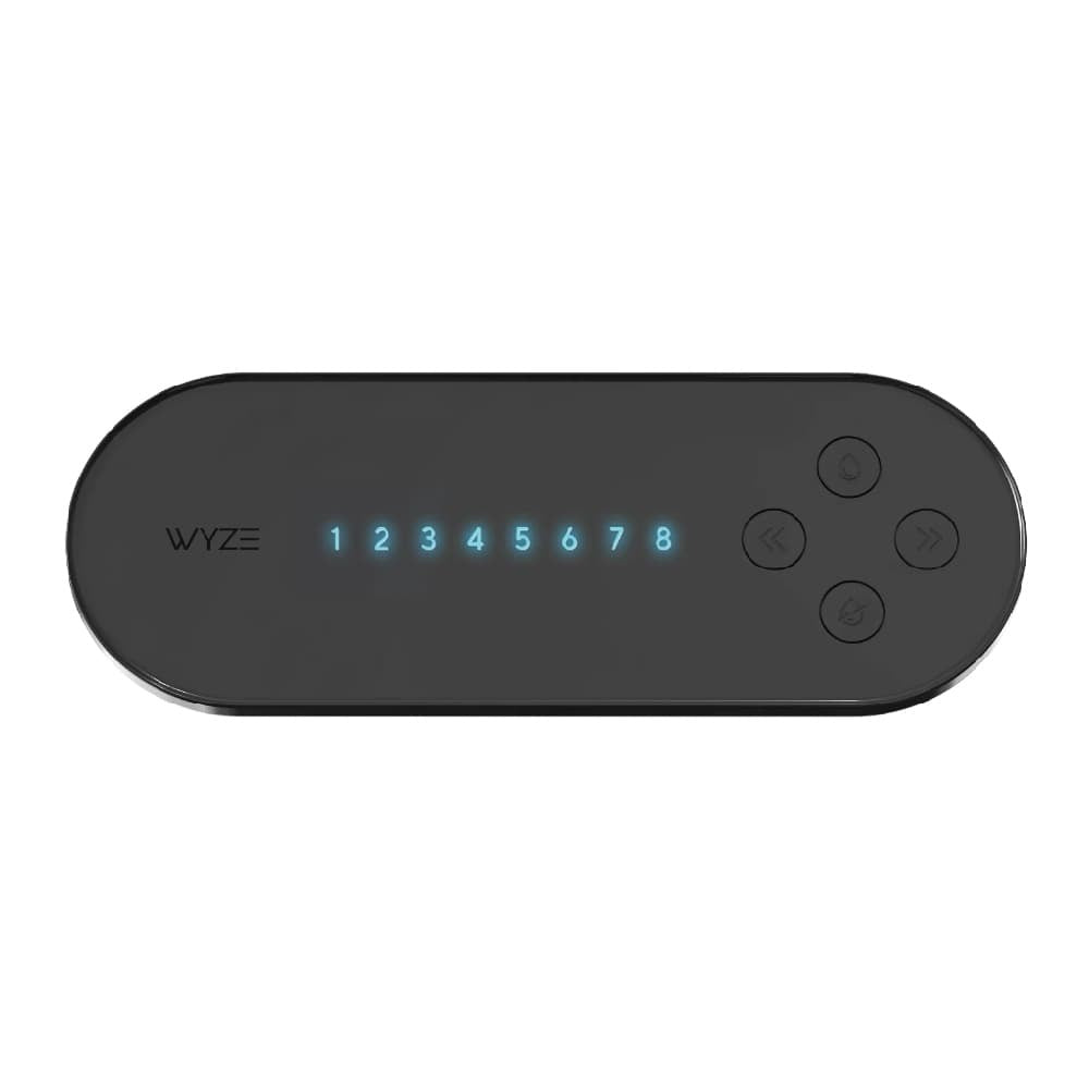

Zones
  • Up to 8
Operating Temperature
  • -4ºF - 122ºF (-20°C - 50°C)
Weather Resistance
  • Indoor-use only
Power Source
  • 24V AC, 60Hz, 850mA
Power Cable Length
  • 6 feet
Valve Output
  • 24V AC, 60Hz
Compatible Wire Sizes
  • 12 - 28 AWG
Certifications
  • FCC part 15B
  • RoHS
  • CEC
Model Number
  • WSPRK1

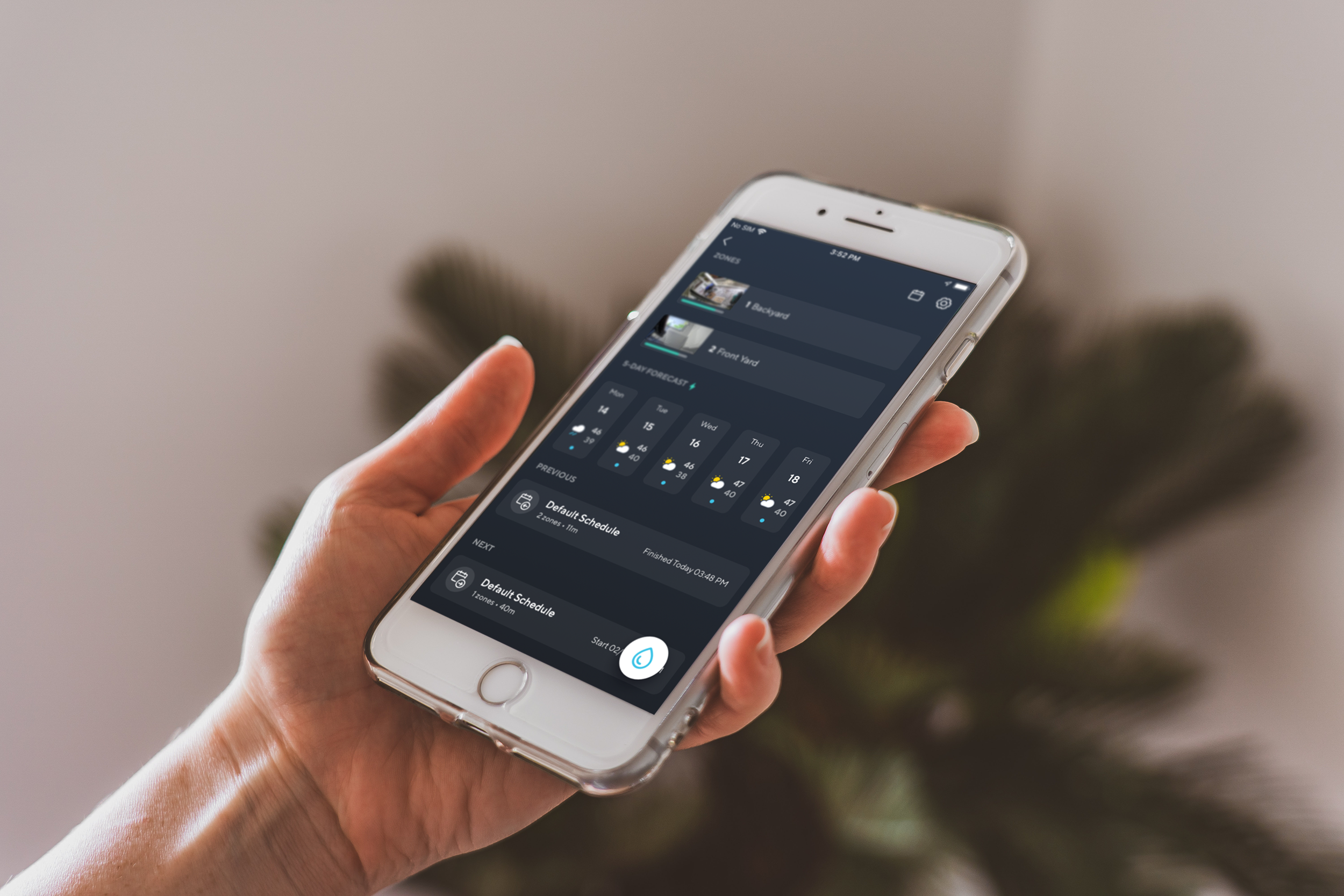

Customize a watering schedule that is most convenient for your busy life. Easily start or stop a watering schedule with just a tap in the Wyze app.
A phone screen displaying a weather app with customizable zones.
8 customizable irrigation zones.
Customize schedules for up to 8 different irrigation zones. Set unique names and photos for each watering zone in the Wyze app so you know which zone is which.

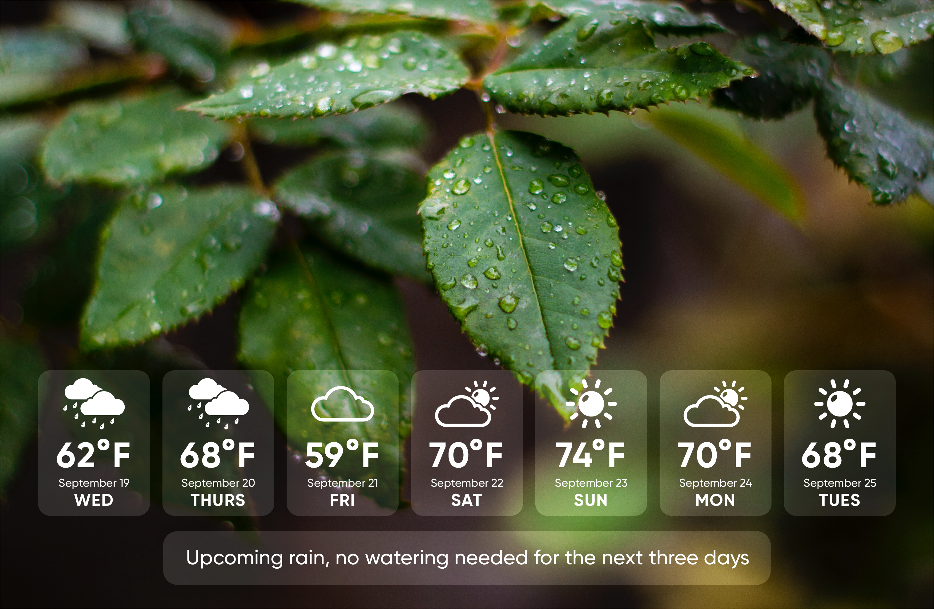

Unlock weather-based watering with Sprinkler Plus.
Water when your plants are thirsty, not when it's raining with Sprinkler Plus. (free 1 year subscription included with the purchase of Wyze Sprinkler Controller)

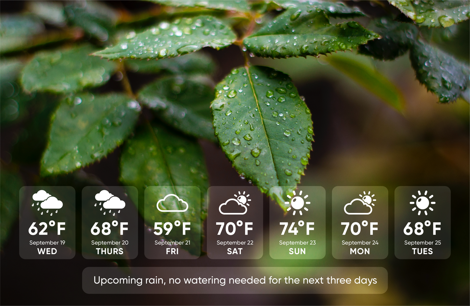

Upcoming rain, no watering needed for the next three days.

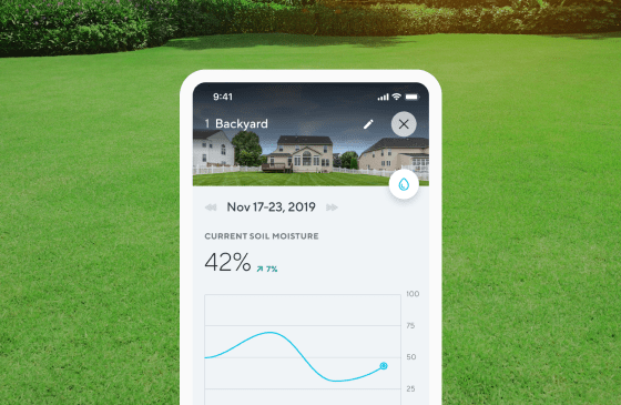

Advanced insights into your yard screen.
Advanced insights into your yard.
With Sprinkler Plus, you can see the historical, current, and future moisture levels for each watering zone. Even view the upcoming weather forecast and watering activities right from the app.
A weather app on a phone displaying a 5-day forecast.
Intelligent weather skips.
Sprinkler Plus can skip unnecessary scheduled waterings based on hyper-localized weather data to save you water and protect your plants.

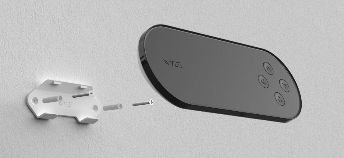

Install the mounting plate
The first step is to hold the mounting plate in the desired location. It's important you check that both the new power adapter and your existing wires will reach the new mounting location.
  1. Hold the mounting plate to the wall and use a pen to mark the holes.
  2. Use a 7/32 drill bit to pre-drill the holes.
  3. Then, insert the wall anchors, gently hammering them into place.
  4. Hold the mounting plate back up to the wall and screw the plate into position.
    Be sure that the Wyze logo is right-side up.
Connect your Wyze Sprinkler
  1. Insert each labeled wire to the corresponding terminal on Wyze Sprinkler The two C terminals are the same so you can insert your C-Wire to either one.You will need to press down on the terminal lever to insert the wire.
  2. Once inserted, make sure the wires are fully inserted and stay in place when gently tugged.
  3. Plug Wyze Sprinkler into an outlet using the included adapter
  4. Wait for the numbers on the front of the device to start cycling in orange.
Your device is now ready to be paired to the Wyze app, after it's mounted.
Mount your Wyze Sprinkler
Place the top of the device into the mounting plate and then firmly push the bottom into place.
You should hear a snap as it locks into place. You can also use the included cord wraps to neatly tie all your zone cords together.
