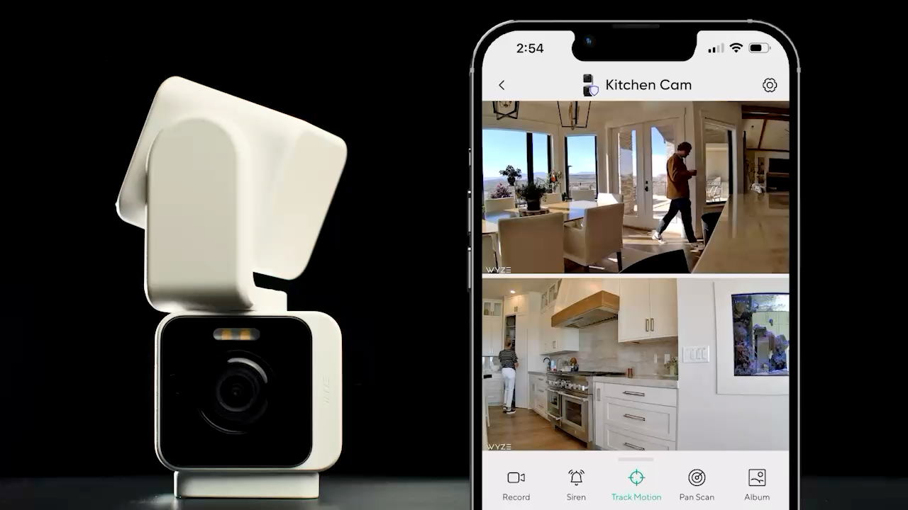

    One stays steady while the other one moves. Cover two areas with a single device for maximum coverage.
    Keep your head on a swivel with 360° pan and 180° tilt.
    Never miss the action with auto motion tracking. Crystal-clear 2K clarity on both cams capture every detail.
