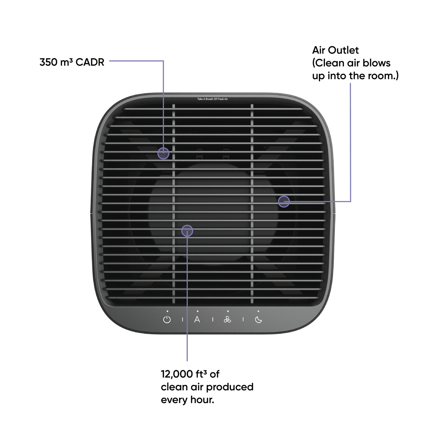

A Wyze air purifier with a 350 CADR.
Powerful air-scrubbing technology.
Wyze Air Purifier cycles a whopping 12,000 cubic feet of air every hour (350 m³/h CADR)!
Translation: it’s like dumping two swimming pools full of clean, pristine air into your house every sixty minutes.

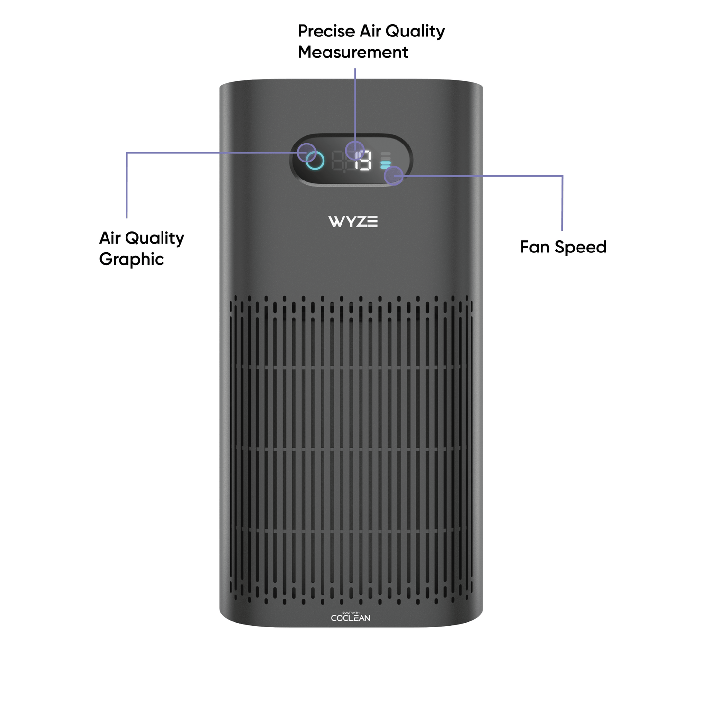

Cleans your air on auto-pilot.
Auto Mode so effective, you might never touch Wyze Air Purifier again until it’s time to change the filter.
Plus, control the fan speed, dim the display, and a handy child lock—you know, in case your toddler has other ideas.

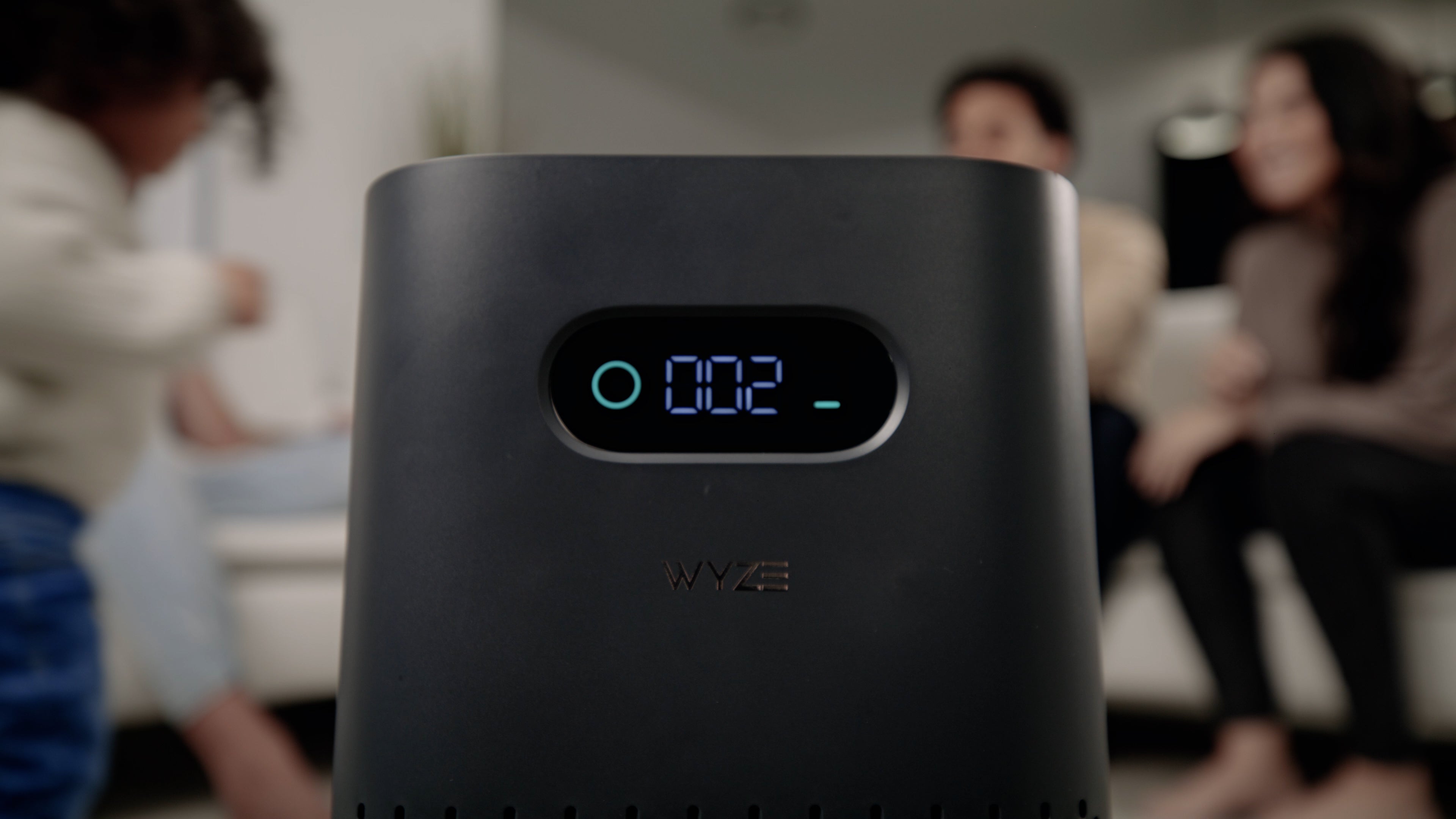

A black air purifier with a digital display showing the current time and air quality.
We’d say “purrs like a kitten,” but it’s actually 4 decibels quieter.
Operates between 21 and 54 decibels without sacrificing power.
For reference's sake, a purring kitten is 25 decibels and light rainfall is 50. So somewhere between kitty cuddles and a misty morning.

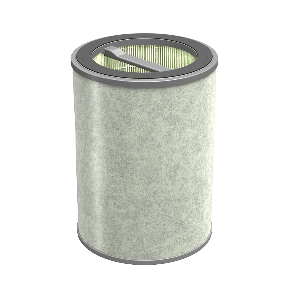

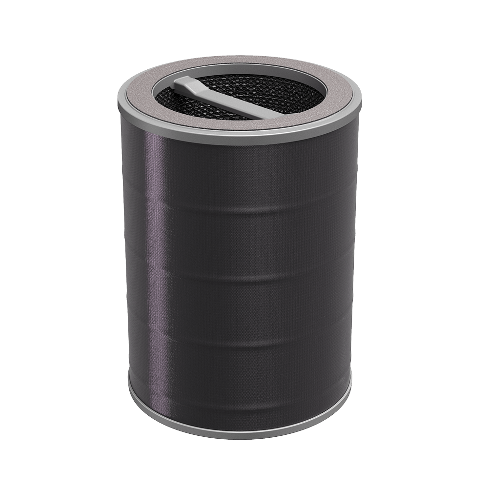

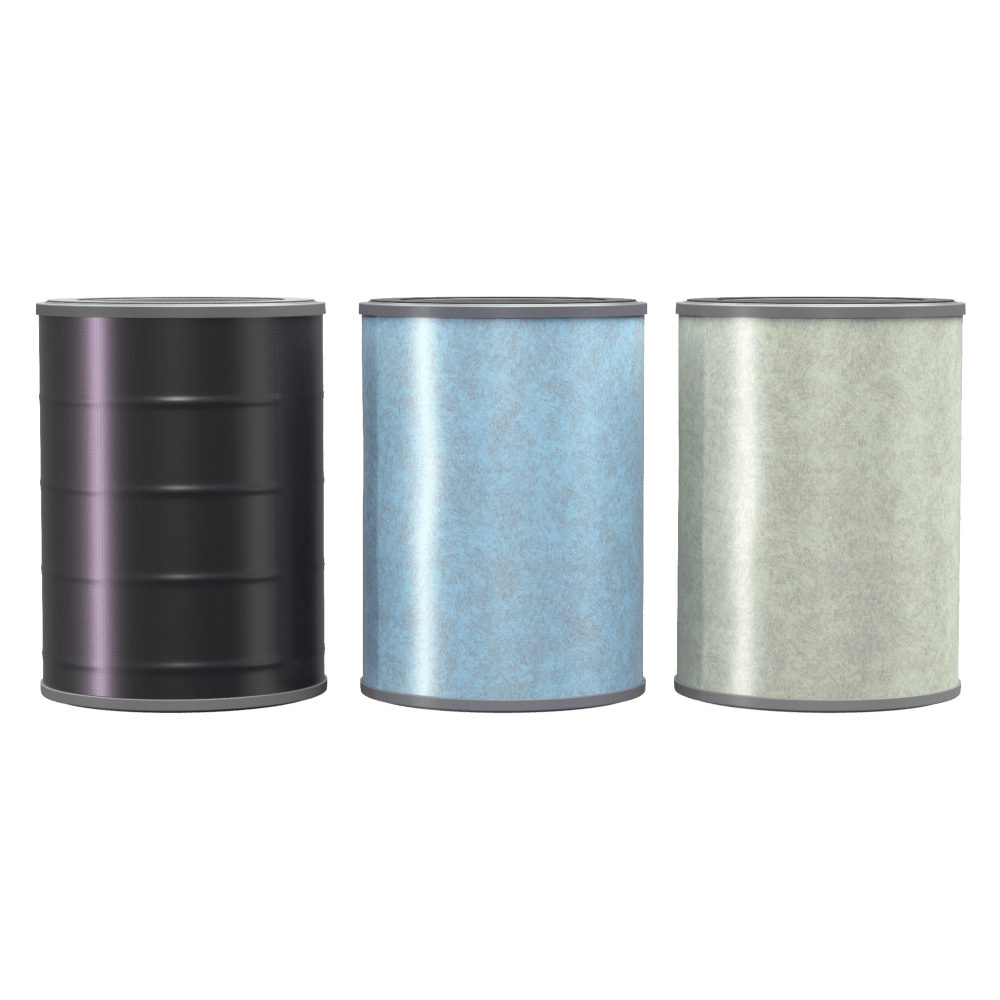

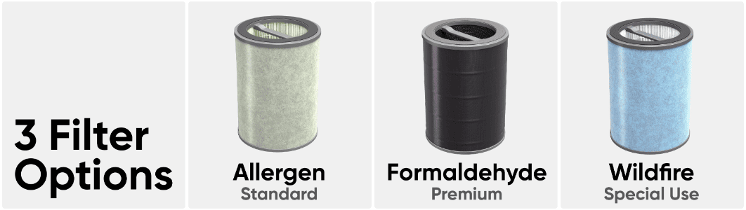

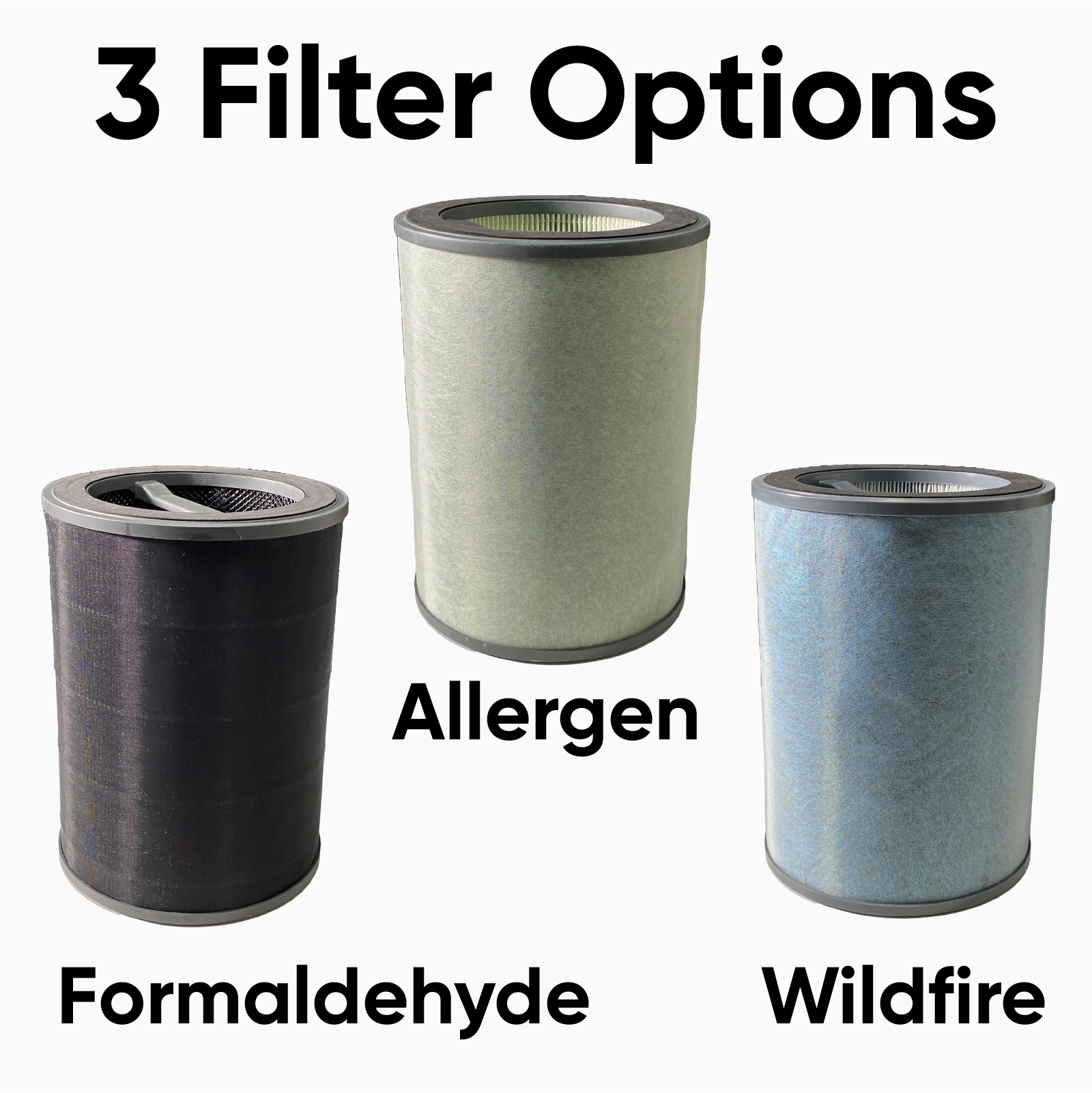

Premium custom filters for premium custom cleans.
Allergens in spring? Wildfires in summer? New construction? Pets? Viruses and bacteria?
Cleaning needs change. Wyze Air Purifier can change with them thanks to three custom filters, all true HEPA, packed with granulated carbon and other catalyst materials.
Air purifier hepa filters sm.
Three filters with different options for allergen, formaldehyde, and wildfire.

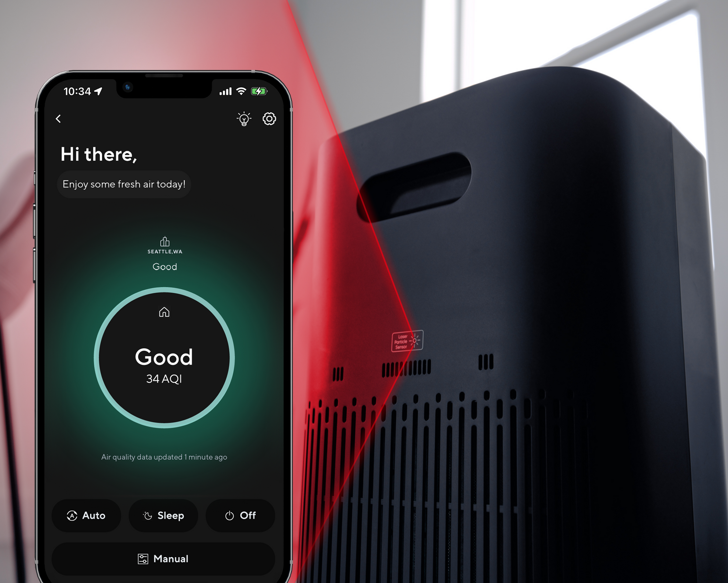

Smart controls and automation.
One of the handiest app interfaces we've ever designed, and fully compatible with Alexa and Google Home.
The solid circle reports the indoor air quality straight from Wyze Air Purifier's laser particle sensor.
The outer halo reports the outdoor air quality with hyper-local accuracy.
Instant, actionable insights for your health plus quick device controls, right at your fingertips.

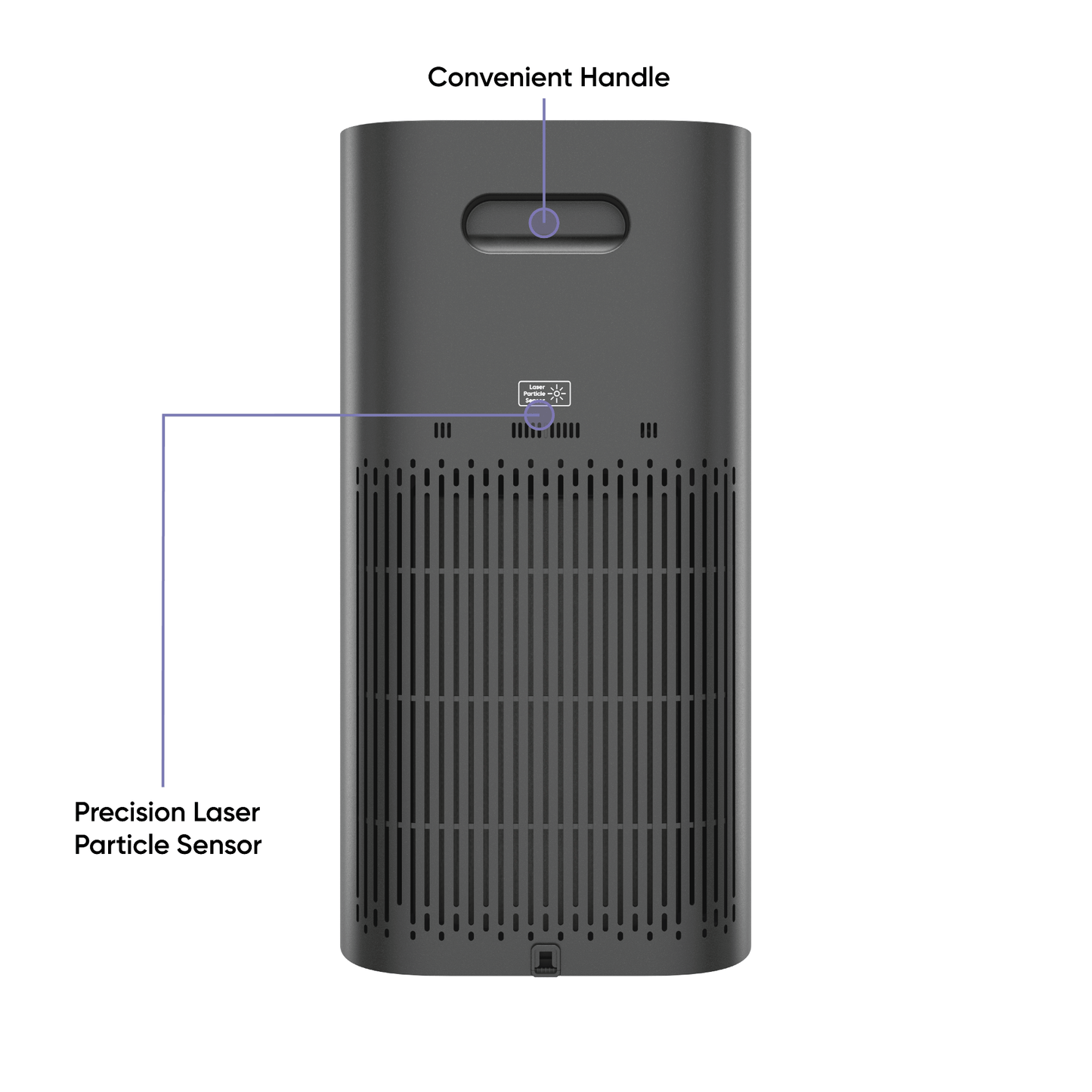

Air quality accuracy down to 0.3 microns.
Most purifiers use outdated infrared sensors that only detect large particles once every few minutes.
Wyze Air Purifier's laser particle sensor checks ultra-fine particles in the air 100 times a second, nearly approaching the compulsive regularity of a teenager with a phone.

Easy moves and maintenance.
Handy handle for carrying from room-to-room, and filter replacement so quick and painless, you’ll wonder if you skipped a step.
  • A person is holding a black device with a handle on the back.
    Convenient handle
  • A man holding a speaker with a red lid.
    Simple filter changes

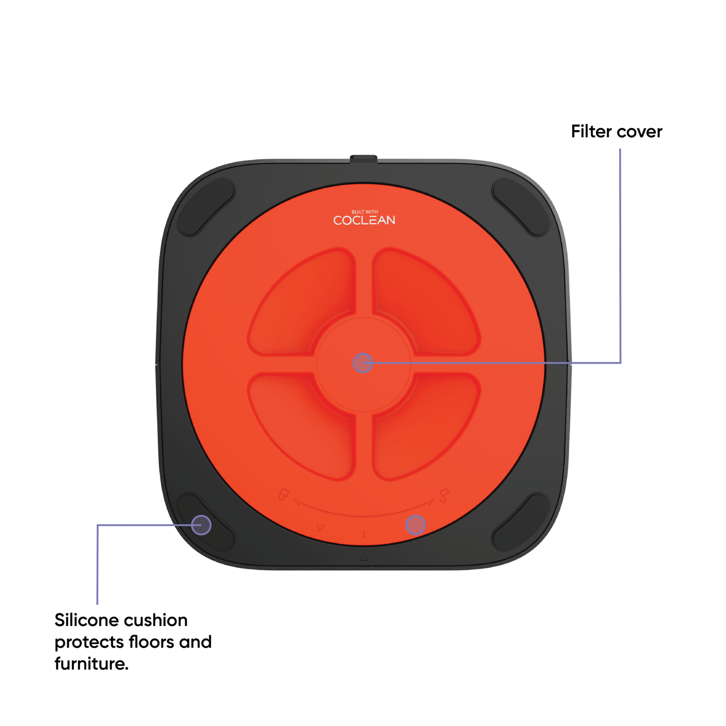

Before setting up Wyze Air Purifier:
  1. Remove the air purifier from the packaging.
  2. Turn the air purifier over to locate the orange filter cover. Rotate and remove the cover.
  3. Take out the pre-installed filter and remove the plastic packaging. You must remove all packaging and wrapping before proceeding.
  4. Re-install the now plastic-free filter into the air purifier.
  5. Put the filter cover back in place and rotate to close.
