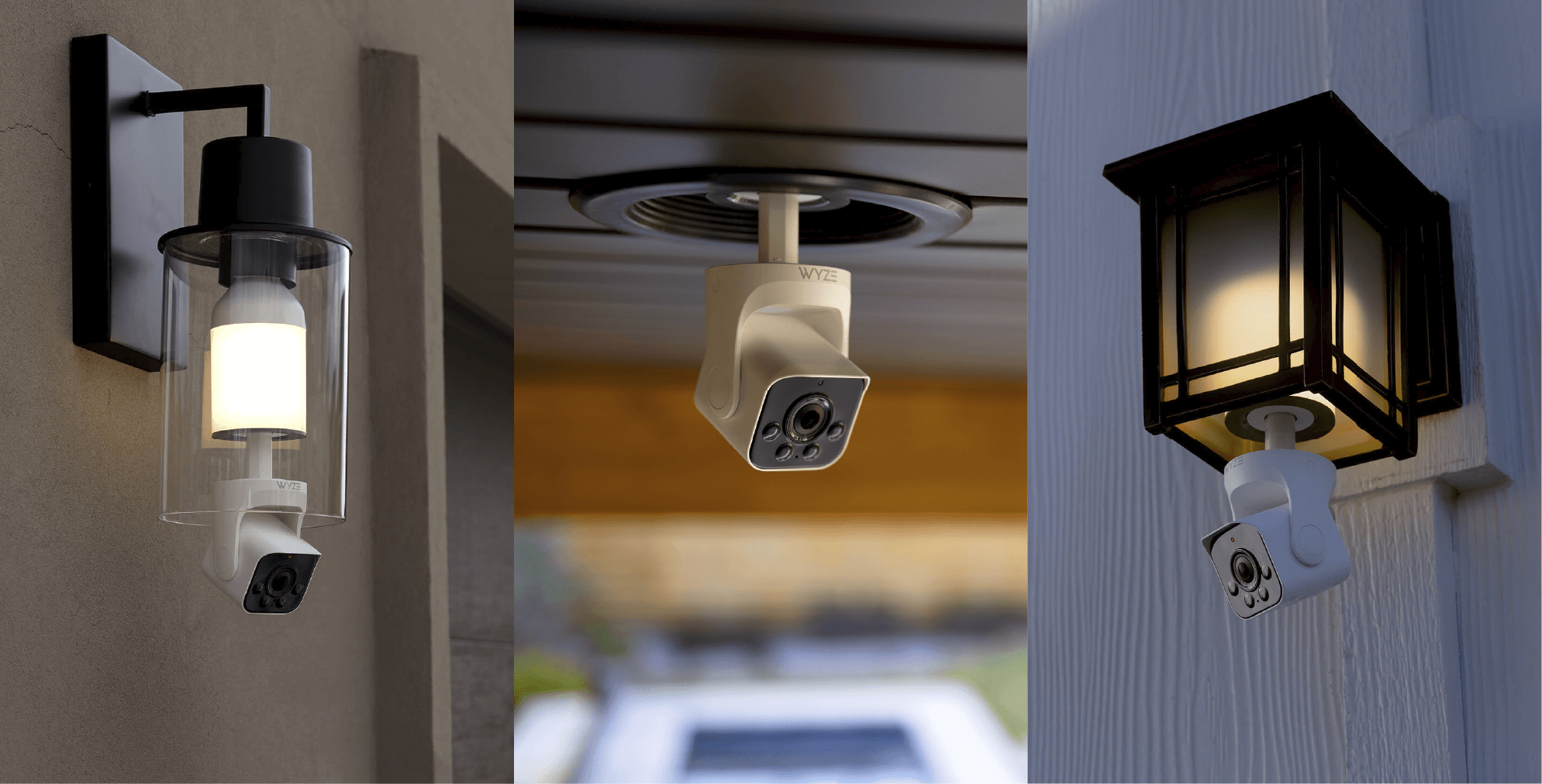

    Adjusts to Fit Most Light Fixtures
    Manually extend, rotate and tilt the camera to find just the right angle.

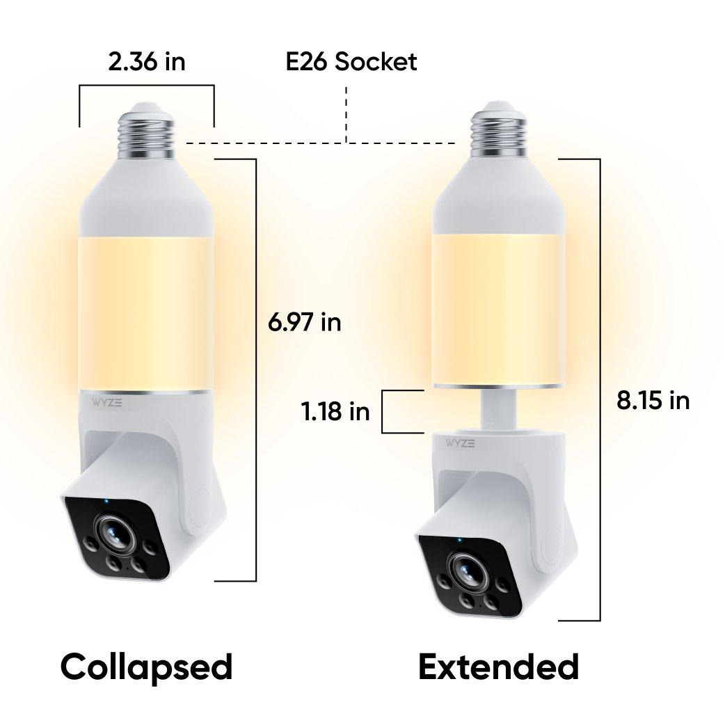

Wyze Bulb Cam Tech Specs
Materials & Colors
  • Model: WYZECBC
  • Body: Plastic
  • Lens: Glass and Plastic
  • Bulb Base: Metal
  • Certifications: FCC, IC, UL, IP65
  • Telescoping Length: 1.18 in (3 cm)

It fits most sconces with an inner depth of less than 7.87 in (20 cm), from socket base to sconce edge. For larger sconces, we recommend using a Wyze Lamp Socket and Wyze Cam v4.
We recommend installing Wyze Bulb Cam and Wyze Accessory Bulb directly into the socket and not the Wyze Lamp Socket accessory.
Manually extend, pan, and tilt the camera to find just the right angle.
A Wyze Bulb Cam is mounted on a wall, providing security and illumination.

Clear View Fit Check
Use the diagram below to confirm the clearance in your specific fixture. For optimal performance, the camera lens must extend beyond the bottom edge of your light fixture or sconce.
Viewing through glass or fixture housing can cause motion detection issues, unwanted reflections, and poor image quality.

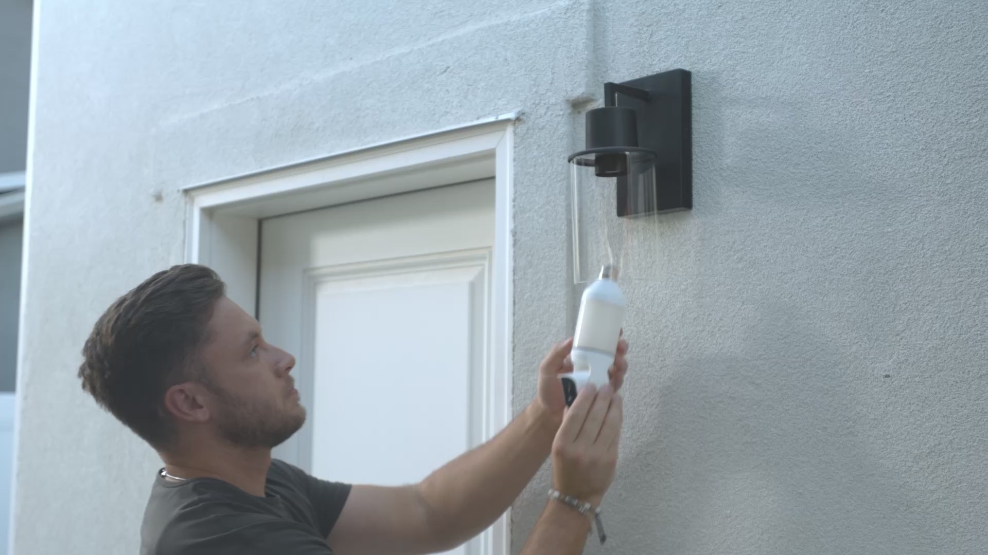

Installing your new Wyze Bulb Cam is as easy as screwing it in, and turning on the power to the socket. You can even install and set up accessory bulbs at the same time!
Before installation: At the electrical panel or light switch, shut off power to your existing light fixture before proceeding. Then, check that your socket type is a standard E26 socket.
What's in the box?
  • Wyze Bulb Cam x 1
  • "Do Not Turn OFF" sticker x 1
  • Quick Start Guide x 1
To install your Wyze Bulb Cam:
  3. Tap Cameras > Others > Wyze Bulb Cam.
  4. On the Add Cam menu, tap Wyze Bulb Cam.
  5. Check your socket type to ensure it's a standard E26 socket. Tap Next.
  6. Check your sconce, to ensure it's an open fixture. Tap Next.
  7. If you haven't already, shut off power to your light fixture. Tap Next.
  8. Unscrew your existing bulb from the lamp socket. Tap Next. 🔥 Be careful! Your existing bulb may be hot.
  9. Install your Wyze Bulb Cam by twisting it into the socket - easy! Tap Next. If you have any Wyze Accessory Bulbs to install, install them now. Tap Next.
  10. Turn on power to your Wyze Bulb Cam and accessory bulbs (if installed). Tap Next. The status light on the camera will turn on when powered. If the status light doesn't turn on or flash, press the SETUP button to reset the camera.
