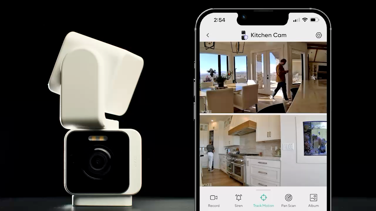

      Deux caméras. Deux points de vue.
      Une caméra fixe et une caméra panoramique/inclinable éliminent les angles morts.
    L'un reste fixe tandis que l'autre se déplace. Couvrez deux zones avec un seul appareil pour une couverture maximale.

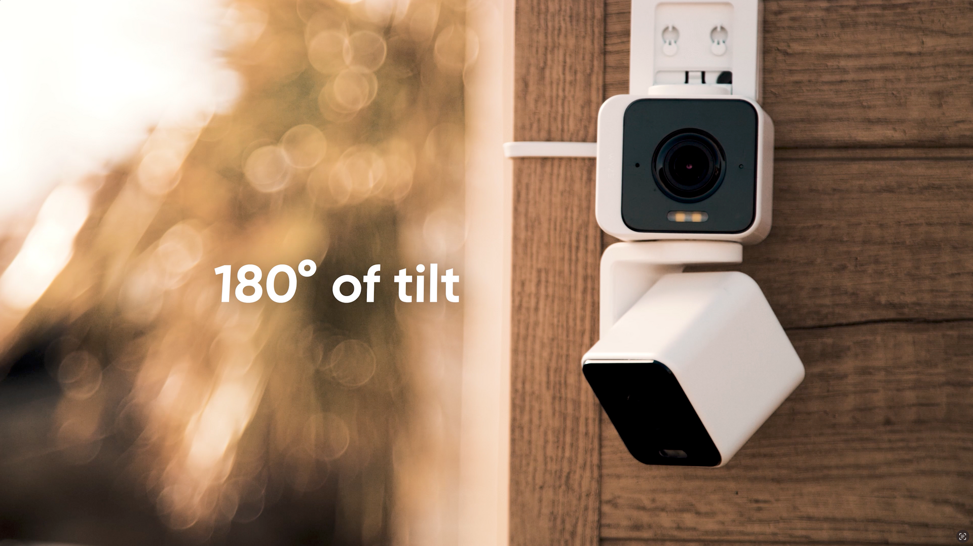

    Gardez la tête sur vos gardes Rotation panoramique à 360° et inclinaison à 180°.
    Ne ratez plus rien grâce au suivi automatique des mouvements. La netteté 2K exceptionnelle des deux caméras capture chaque détail.

    There are 4 ways to mount your Wyze Duo Cam Pan:
    • On a tabletop or flat surface.
    • On a wall, right-side up.
    • On a wall, upside down.
    • On a ceiling, upside down.
    To mount your camera on a flat surface:
    1. Set your camera on a flat surface.The fixed camera must be down, camera right-side up.We recommend mounting it on a horizontal surface, not angled.We recommend mounting it at the edge of the surfaceYou do not need to use the mounting kit.
    To mount your camera on a wall:
    1. Place the Mounting Sticker from the Mounting Kit where you want to install your camera.
    2. Mark your drill holes with a pencil.
    3. Use a 6mm drill to drill holes at the pencil marks.The holes must be 1/4 inches and 1 and 3/6 inches deep.
    4. Insert the included expansion tubes into the holes.
    5. Place the Wall Plate over the expansion tubes*, then screw into the expansion tubes to mount the wall plate. To mount right-side up, place the Wall Plate on the tubes with the tab pointing up. To mount upside down, place Wall Plate on the tubes with the tab pointing down. To use the camera, you will have to toggle on Rotate Image 180° in your Advanced Settings.
    6. On the camera, pull the bracket away from the base. If the screws on the camera's bracket are loose, tighten them before continuing. To mount right-side up, place the base onto the wall plate and firmly press down. To mount upside down, place the base onto the wall plate and firmly press up.
    7. Insert the power cable into the camera, then plug the USB end into the adapter.When powered, the status light on the camera will light up.
    To mount your camera on the ceiling:
    5. Place the Wall Plate over the expansion tubes* on the ceiling, then screw into the expansion tubes to mount the wall plate.
    6. Mount the camera base onto the Wall Plate, cameras facing outward.
    7. Because your camera is upside down, you will have to rotate the image in your settings.In the Wyze app, tap on the Settings gear > Advanced Settings > toggle on Rotate Image 180°.
    8. Insert the power cable into the camera, then plug the USB end into the adapter.When powered, the status light on the camera will light up.
    Additional Note: We recommend mounting your camera vertically upright or upside down. We do not recommend mounting your camera at an angle or side ways.
