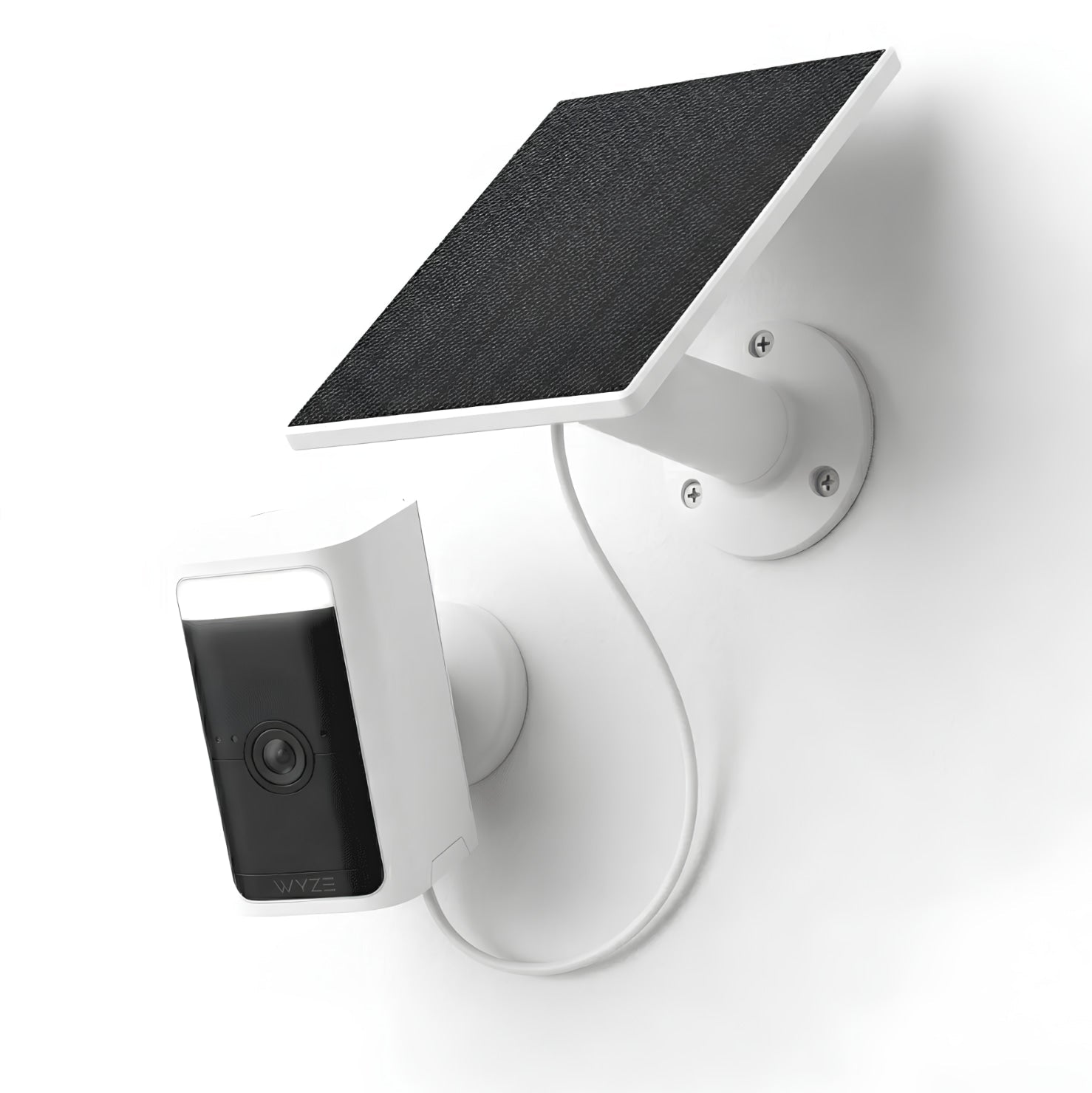

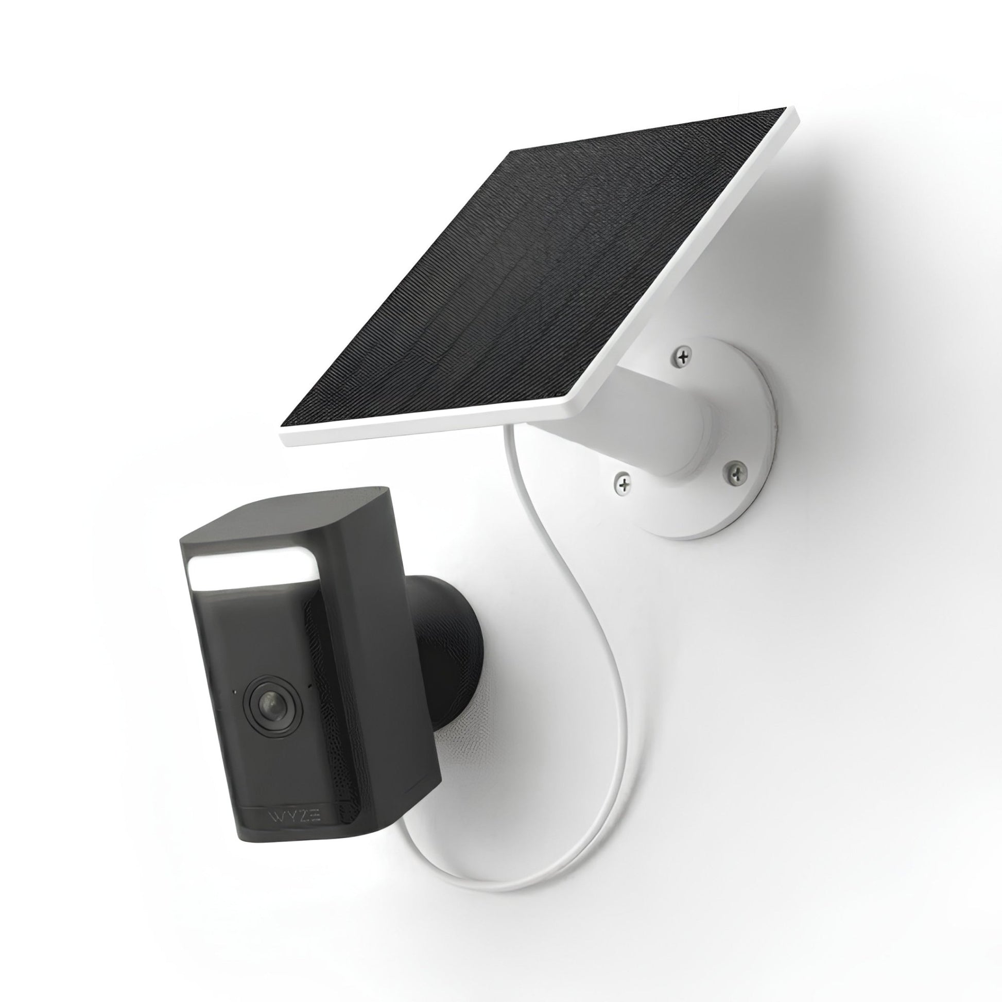

  • Wyze Solar Panel
    Regular price From $7.99 CAD
    Regular price CADDeal From $7.99
    12W Solar Charger for Outdoor Cams Learn More

A solar panel is attached to a house.
Turn your cam into a Solar Powered Security Camera in seconds.
Nothing says, "I'd like to keep living on planet Earth" like a solar panel. Convert sun rays into power so you can leave your camera up longer with less frequent charging.
Add to Cart
