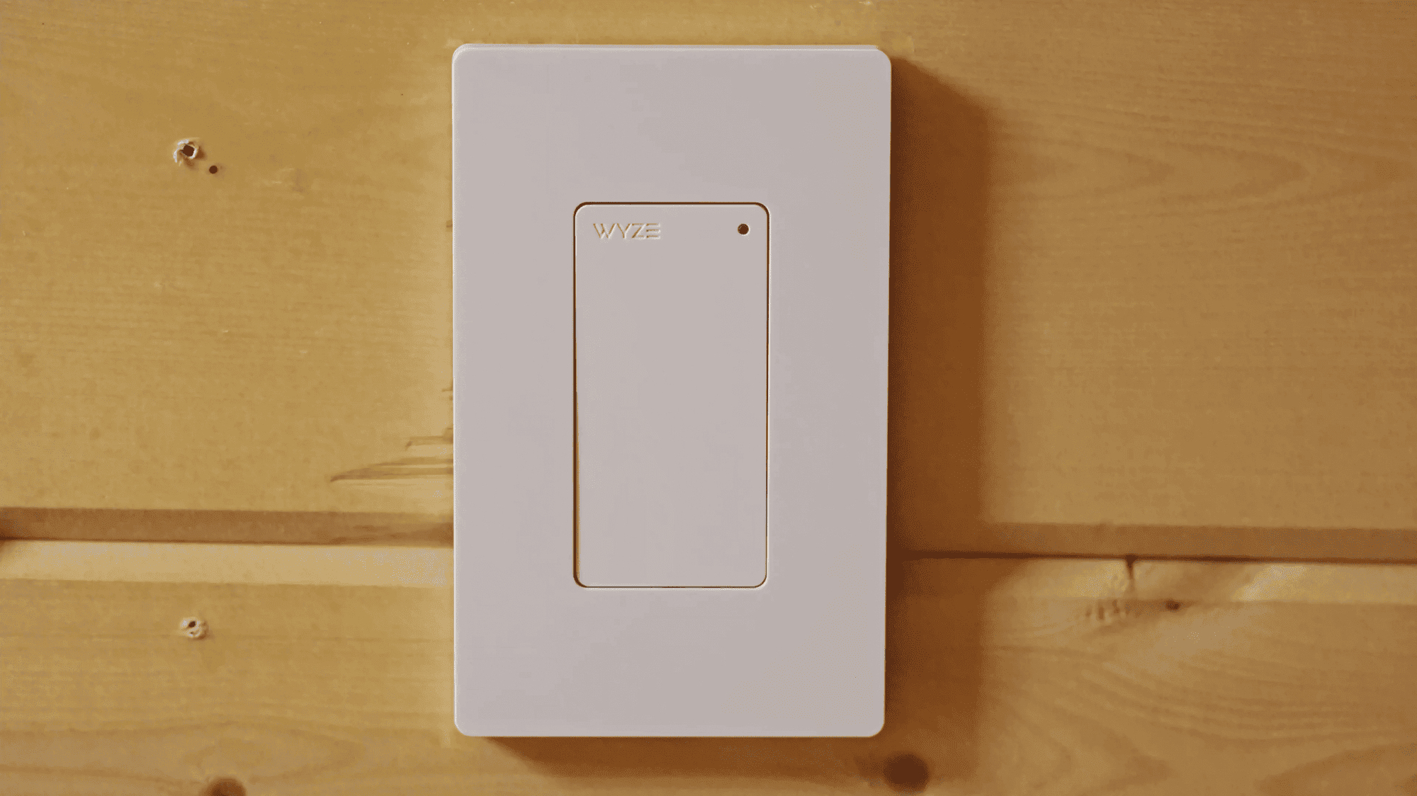

Yes, this switch does require neutral wiring, which is common in homes built after 1980. If you do not have a neutral wire, your wiring is not compatible with Wyze Switch.
About 20 minutes, following the step by step installation process in the Wyze app.
No, this is a single pole switch only. It cannot be used as a multi-way switch.
The response when you press the switch is instant, similar to the response time of a regular switch when smart controls are disabled. With smart controls enabled, there’s a delay of .3s with a single-press.
No, Wyze Switch only comes in white at this time.
Yes, Wyze Switch can be used to interact with the entire Wyze ecosystem of smart products. You can even setup triggers and actions using Rules.
Yes, the switch works with Alexa and Google Assistant.
Yes, Wyze Switch can interact with smart devices outside the Wyze ecosystem by integrating it with IFTTT.
No, Wyze Switch is not a dimmer switch.
Yes, Wyze Switch can be used for multi-gang setup, but be aware of the maximum loads per switch: 1 gang= 600W, 2 gang= 500W, 3 gang = 500W.

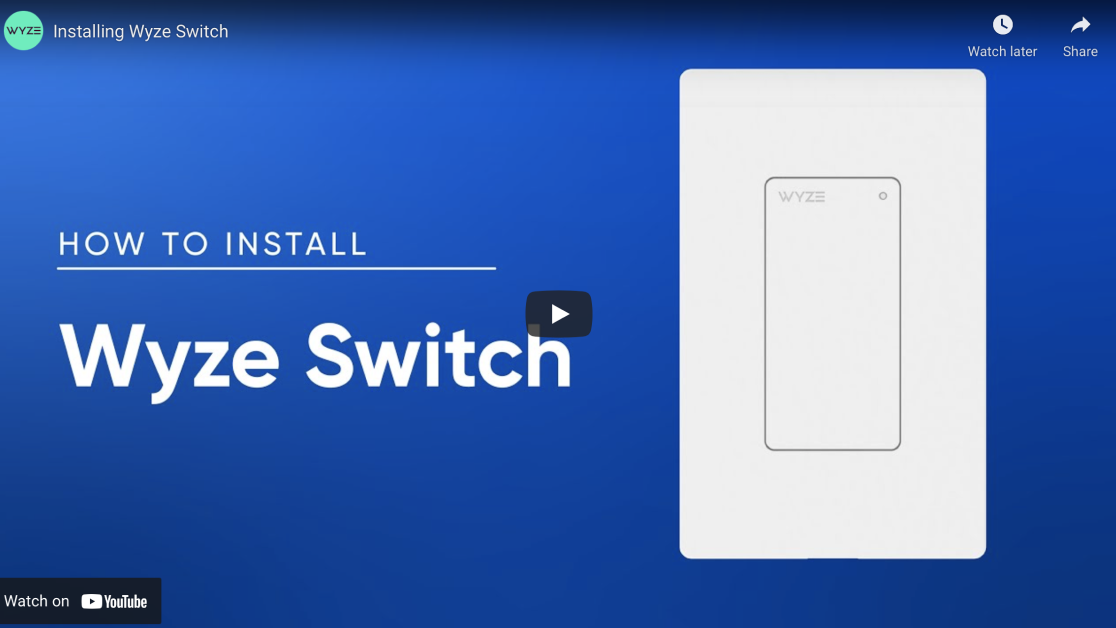

L'installation de l'interrupteur Wyze est simple.
Articles d'aide
Check for these two things:
Additional Note:
For more details about Wyze Switch compatibility, check out: Is my wiring compatible with Wyze Switch?
Wyze Switch is a smart switch that you can control manually with the button itself, or using the Wyze app. We recommend setting it up in the Wyze app to get access to smart features like automations!
Before your switch can be set up in the Wyze app, it must be installed and connected to power. We recommend following along in the app and referencing our Wyze Switch Installation Guide before proceeding.
To set up your Wyze Switch:
  3. Tap Power & Lighting > Wyze Switch.
  4. Read the High-Voltage Wiring warning. Tap Next.
  5. Confirm that you are replacing a single pole switch with neutral wiring. Tap Next.
  6. Follow along in the app to install Wyze Switch if you haven't already. If already installed, tap Skip Installation Guide.
  7. If prompted to give BluetoothⓇ and location permissions, please enable those in your phone's settings.
  8. In the Wyze app, select your 2.4 GHz Wi-Fi network and enter your network password. Tap Connect.
  9. The app will search for your Wyze Switch. It should connect automatically.
  10. Name the device in the Wyze app. Tap Finish.
  11. You’re all set. Enjoy your new Wyze device!
