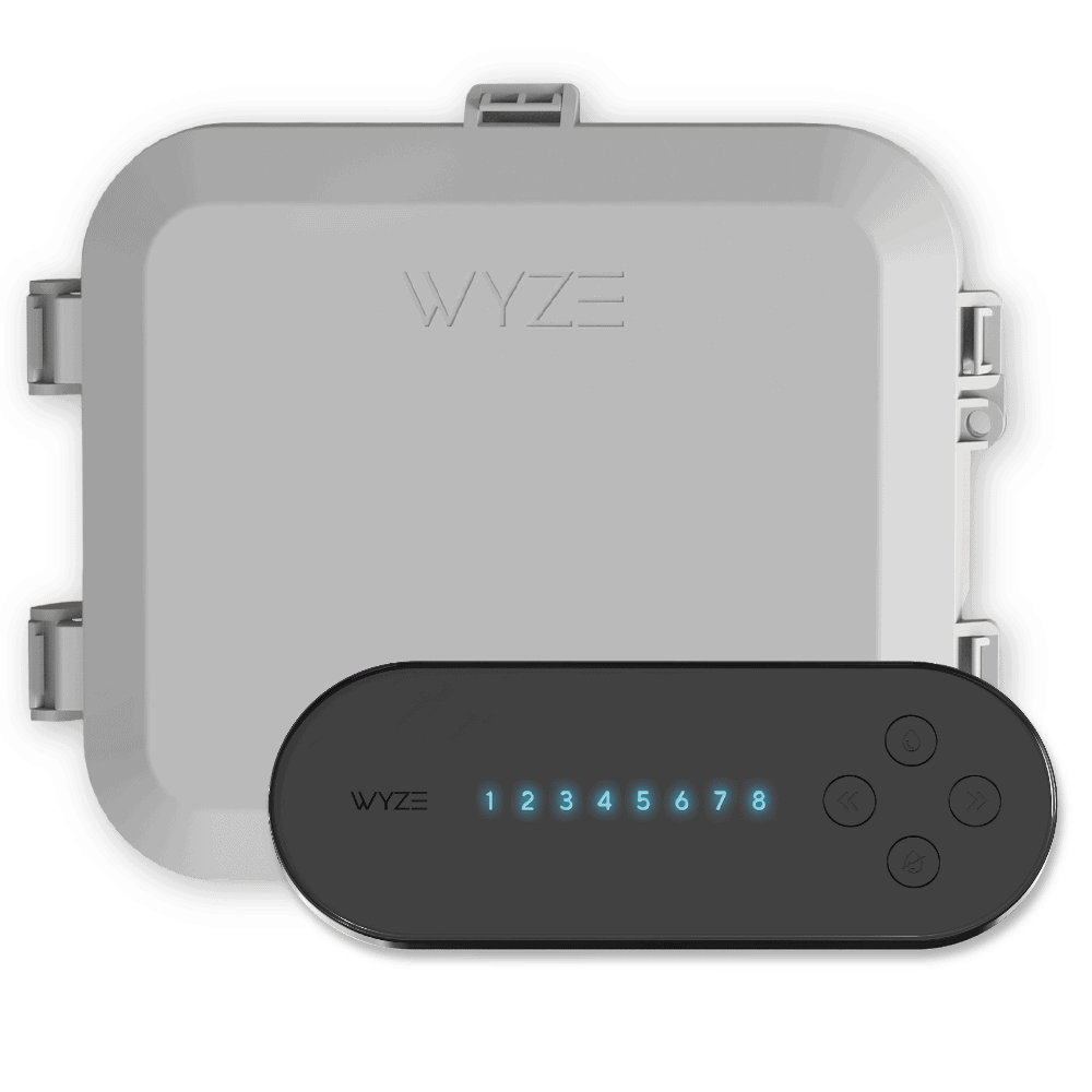

Smarter, simpler, and greener control over your lawn's irrigation system with smart zoned control over your sprinklers.

Dimensions
  • 9.1in x 3.3in x 1.5in (231 mm x 84 mm x 38 mm)
Weight
  • 7.6 oz
Zones
  • Up to 8
Operating Temperature
  • -4ºF - 122ºF (-20°C - 50°C)
Weather Resistance
  • Indoor-use only
Power Source
  • 24V AC, 60Hz, 850mA
Power Cable Length
  • 6 feet
Valve Output
  • 24V AC, 60Hz
Compatible Wire Sizes
  • 12 - 28 AWG
Certifications
  • FCC part 15B
  • RoHS
  • CEC
Model Number
  • WSPRK1
  • Wyze Sprinkler Controller x1 (Model# WSPRK1)
  • Power Adapter x1
  • Mounting Plate x1
  • Screw x2
  • Wall Anchor x2
  • Cord Wrap x2
  • Quick Start Guide x1
  • Wire Label Sheet x1
  • 1-Year Sprinkler Plus Coupon x1
